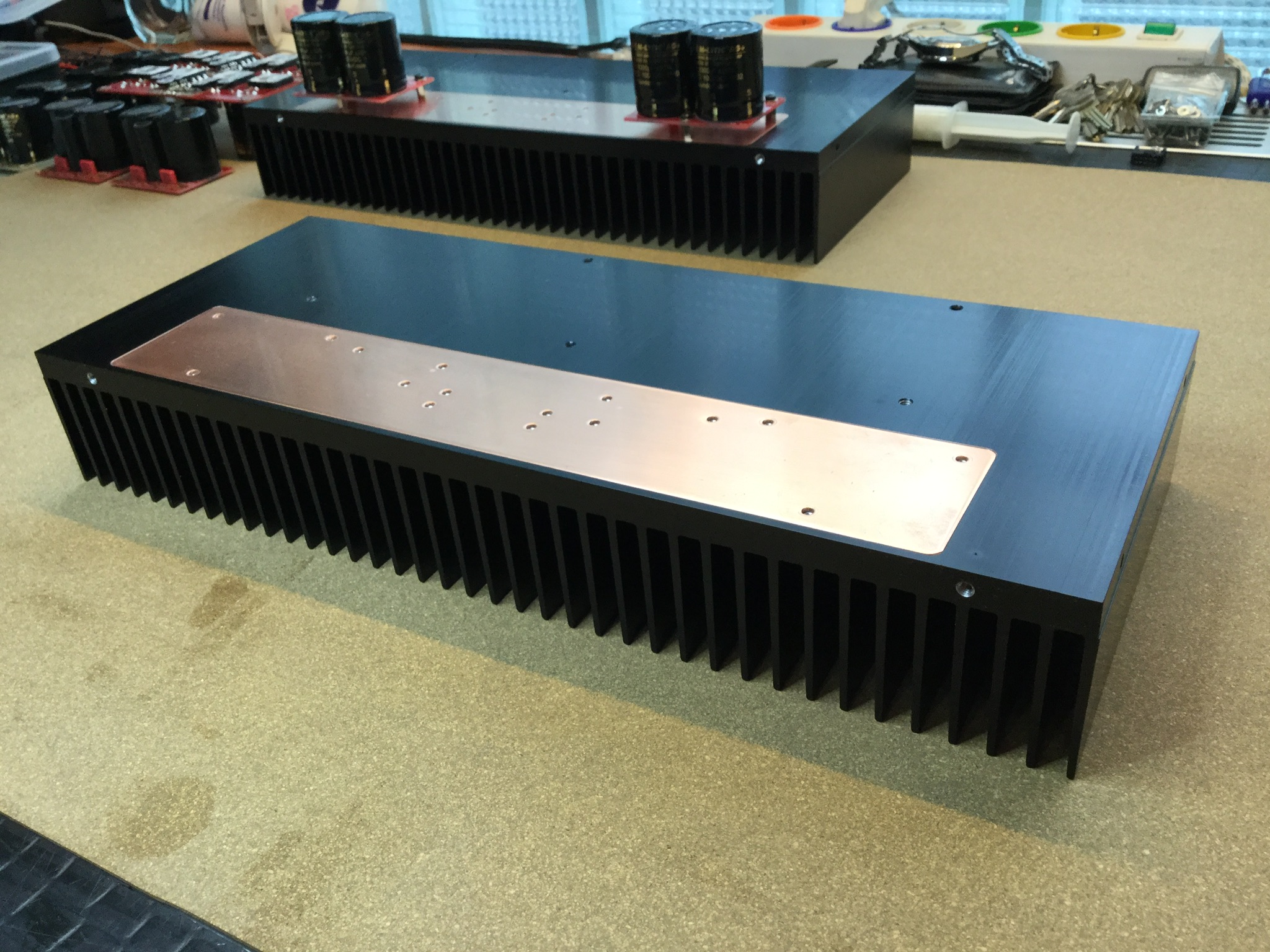

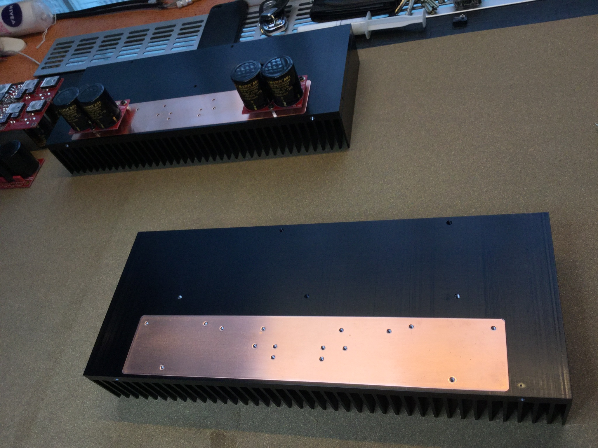

LC,

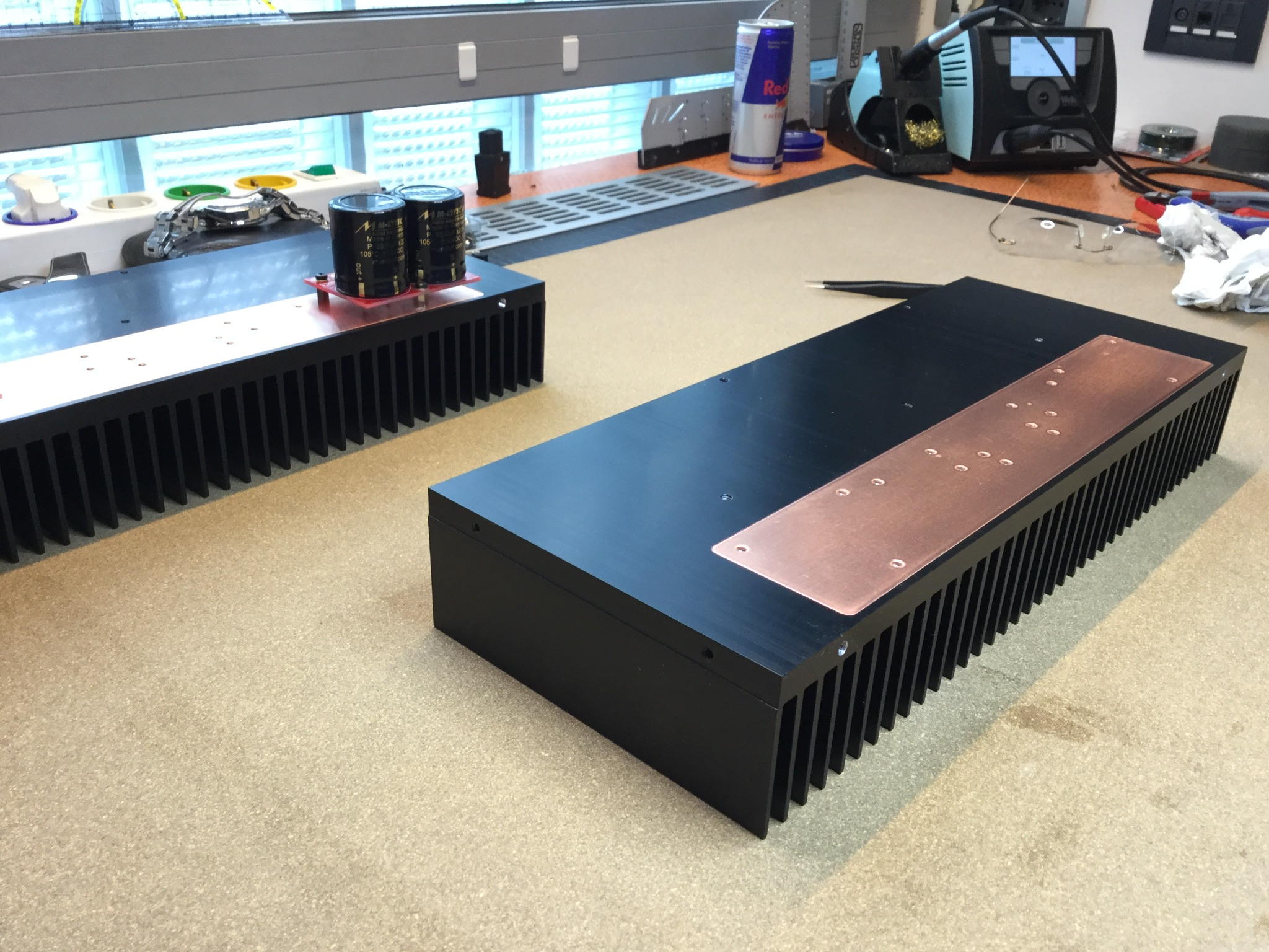

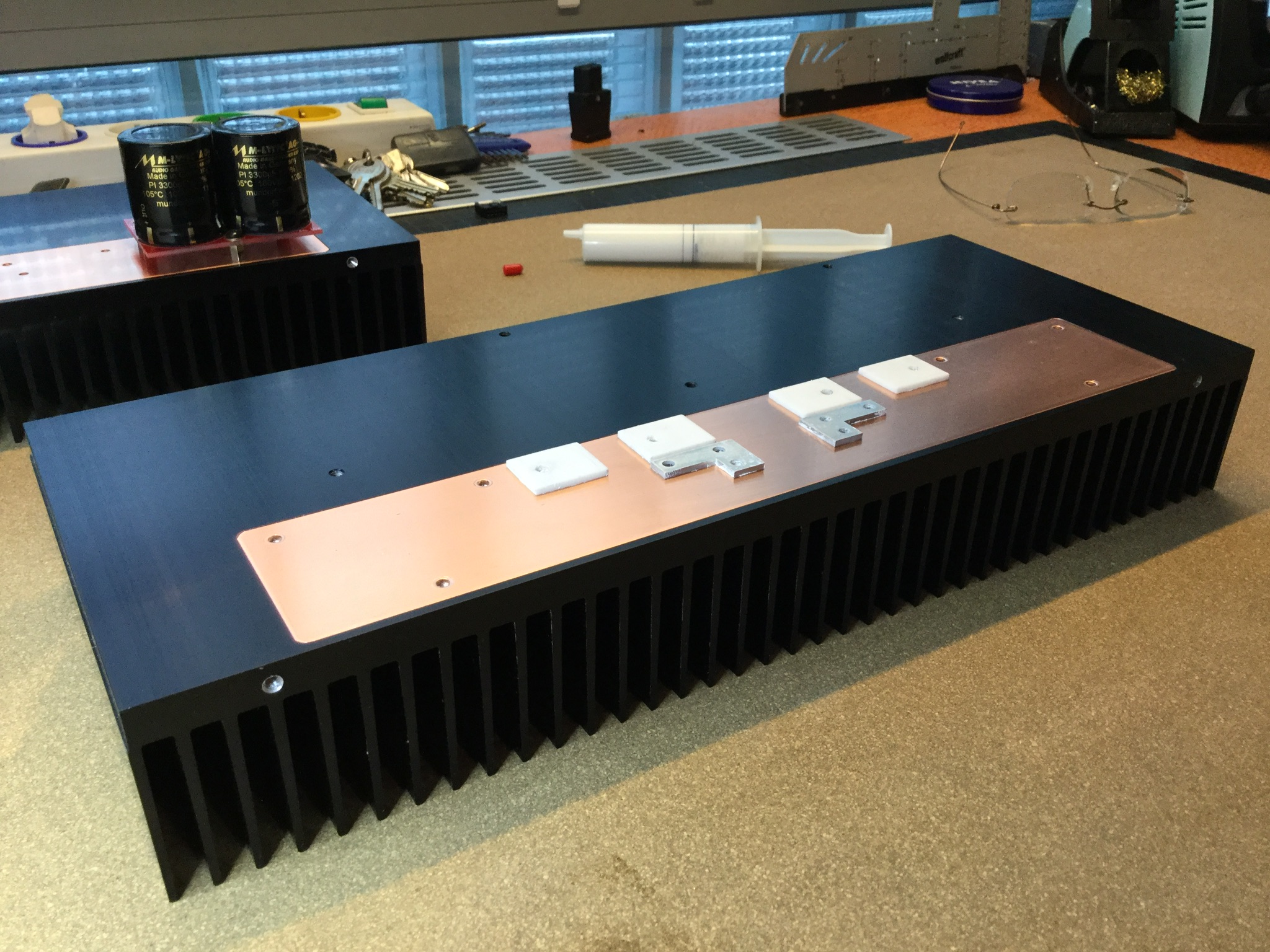

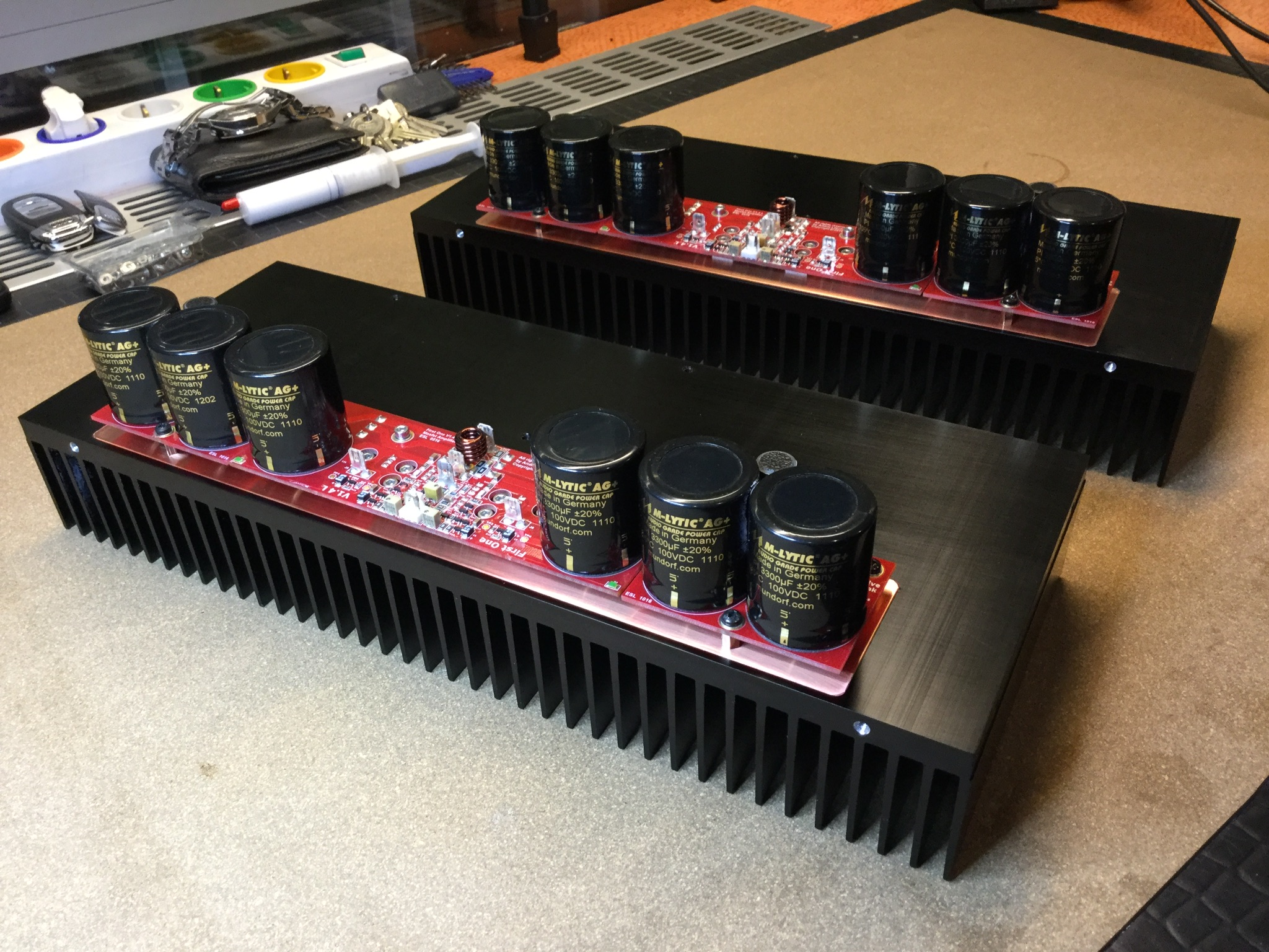

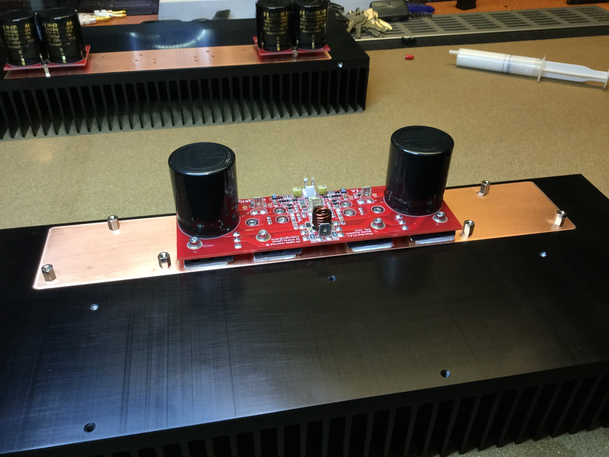

When you mounted the CapBanks on the heatsink (#3467), why did you use that strip of aluminium? Also, did you apply any thermal compound between the strip and the heatsink? )
Thanks.
It's a copper strip, serving to spread thermal energy from mosfets to the heatsink faster. At the same time copper serves as a very good EMI protection since high frequency signals are shorted in copper (thermal effect of eddy currents) and sent to earth via chassis' earth connection. More here:
https://en.m.wikipedia.org/wiki/Eddy_current

It's a copper strip, serving to spread thermal energy from mosfets to the heatsink faster. At the same time copper serves as a very good EMI protection since high frequency signals are shorted in copper (thermal effect of eddy currents) and sent to earth via chassis' earth connection. /QUOTE]
Would it be correct to assume by your response that you didn't use any thermal compound?
Thermal compound used on all surfaces, also in between copper strip and heatsink.Would it be correct to assume by your response that you didn't use any thermal compound?
380 mm x 50 mm x 150 mmLC,
What's the dimensions of the heatsink in post #3631?
