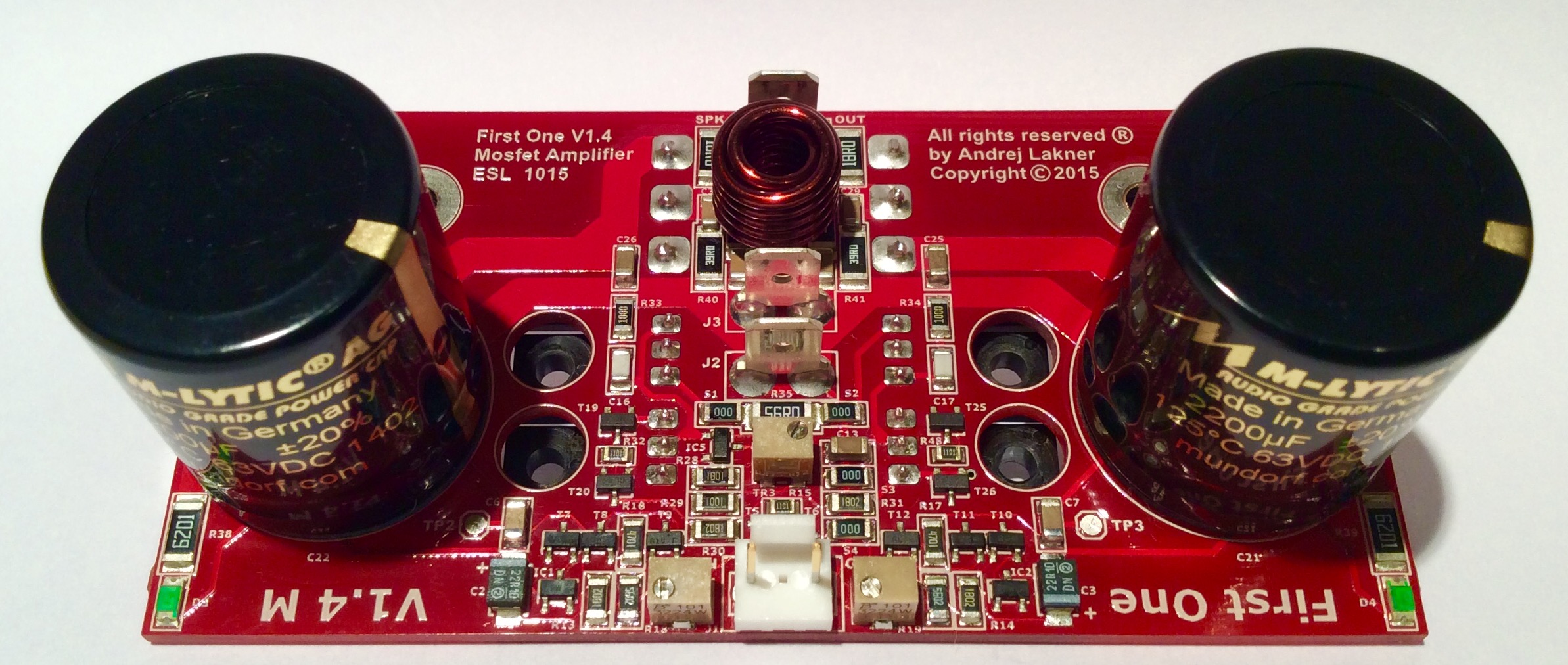

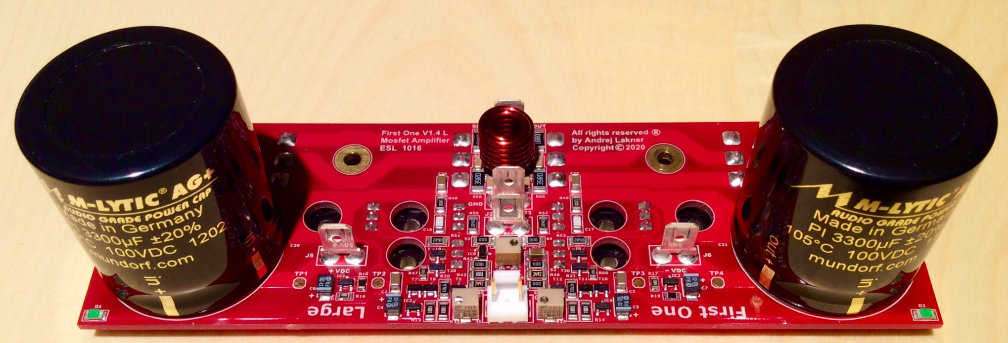

There are only First One M and First One L amplifier modules present currently. 😎
Supporting modules are:
- CapBank Positive
- CapBank Negative
- DC Sense
- VU meter
- stereo line gain stage with attenuator

However, when I connected today the system, I heard a noise coming from one channel followed by some smoke. I disconnected the amplifier and I checked the board. I didn´t found any burned element, but one of the big mosfets is broken (cero resistance between two legs). I used the Diyaudio store keratherm insulators for the mosfets and I didn´t found any problem.
Is it any (easy) way to repare the board?. What can I check to insure that everything is fine, and it was only a punctual problem?.
Regards
Hi kike01
Well the amplifier acts similar like tamed beast, its reactions are fearsome and ultra fast, so everything has to be in order, like gnd connections, correct source signals, loudspeaker impedance, cables, etc. I can assure you that FO M works fluently if all is correct.
Output mosfets got broken so far only if short circuit was performed or power supply polarity was reversed. What else is broken, could not tell, maybe just mosfets, in worst case everything to the input.
