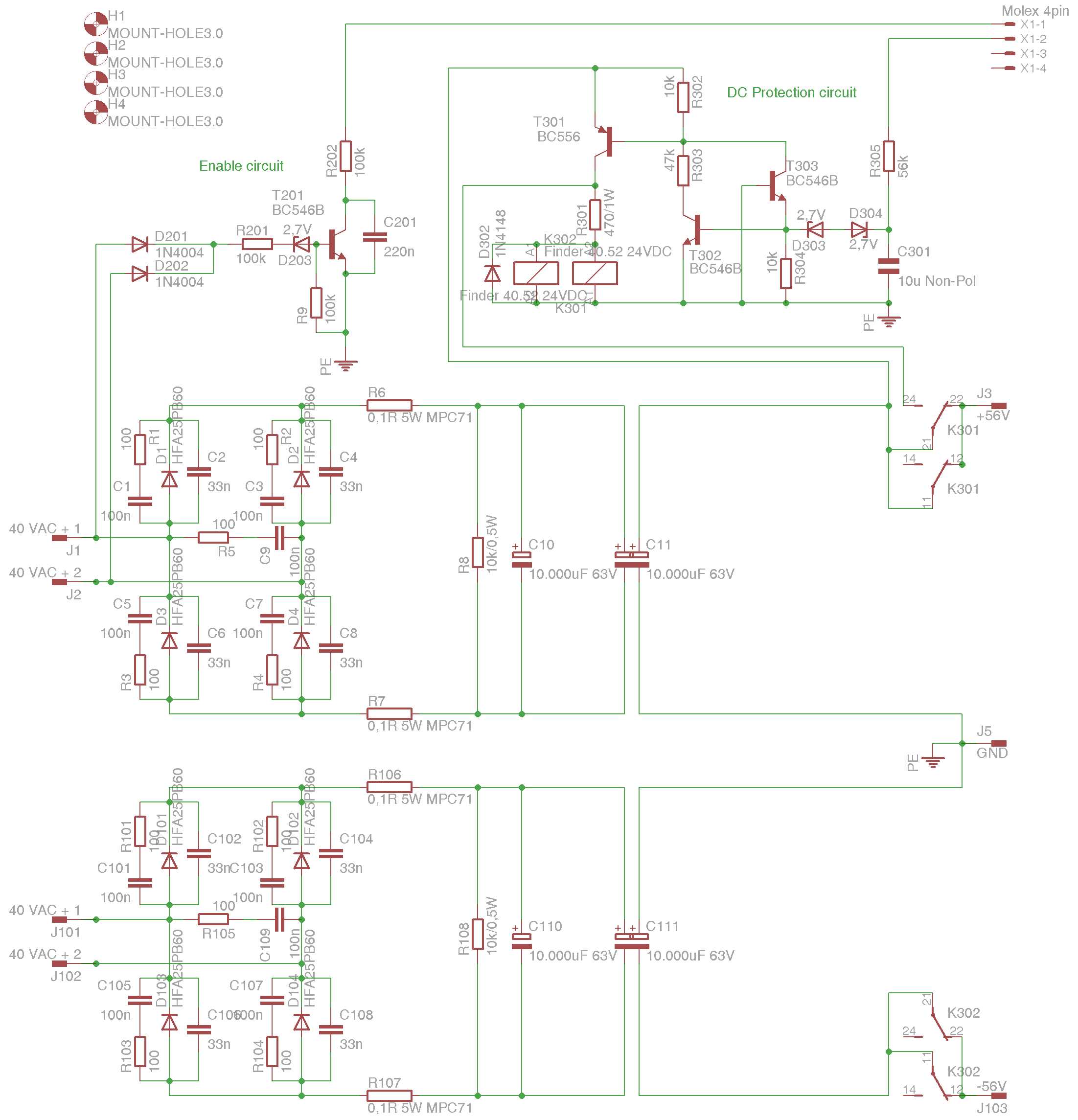

The question is that there are all these capacitors after the PS. Will they discharge in case of DC fault ?
This is clearly an issue. Imho extra capacitors defeat the whole purpose of this DC protection.

A small calculation, supposing the SMPS switches of immediately with 20mF behind the protection:
  • 20mF @ 63V = 1,26 Coulomb
  • 1,26 Coulomb equals 0,011 Wh or (a fake unit) 39,6 Wsec.
  • This means the capacitors can deliver 39,6 Watts during 1 second.
  • 63V @ 8 Ohm = 7 Amps
  • 63V x 7 Amps = 441 Watt
  • This means the capacitors will deliver 441 Watts during +/- 0,1 second (OK, that's very rough, but just to give an idea).
Disclaimer: I'm not sure there are no mistakes 🙂.
It doesn't feel like being that much. The heat will be negligible, but what about the movement the cones will make?
Anyway, I wouldn't trust discharging 20mF @ 63V straight into my PMC-speakers...
I have since 7 years a Hypex UCD400HG, driven by a DIY linear Power Supply. In the PS, I incorporated a DC-protection, with the relais at the output of the PS instead of at the output of the amp. An idea that I took from one or another forum.
As I do tests and changes from time to time, the protection has played it's role several times. I'm really happy I have it there, and I put a DC-protection in other amps I make if I plan to play around with them.
I'm now building a first One M, with the same linear Power supply, with integrated DC-protection. I know everyone here says a SMPS sounds better, but I can't imagine that with 20mF behind a SMPS, and 20mF in a linear PS there will be much difference left. I will keep some free space in the cabinet to be able to switch between the transfo and an SMPS going into the capacitor-bank. That will make it easy to compare. Maybe I should keep some space for the Hypex-modules as well. That would be interesting.
