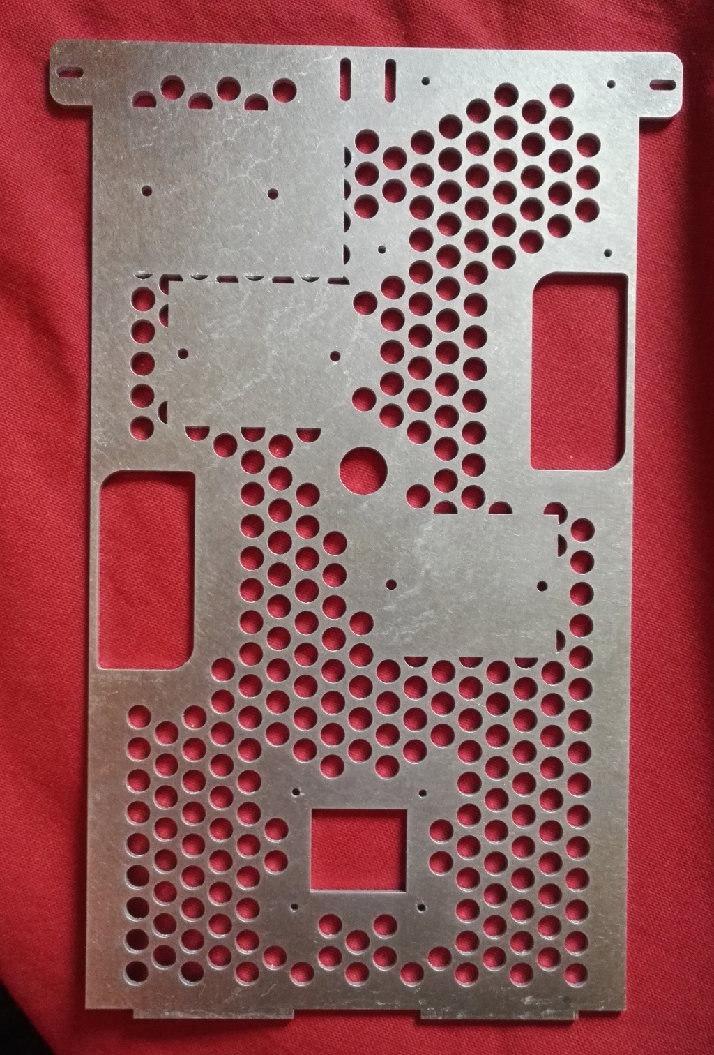

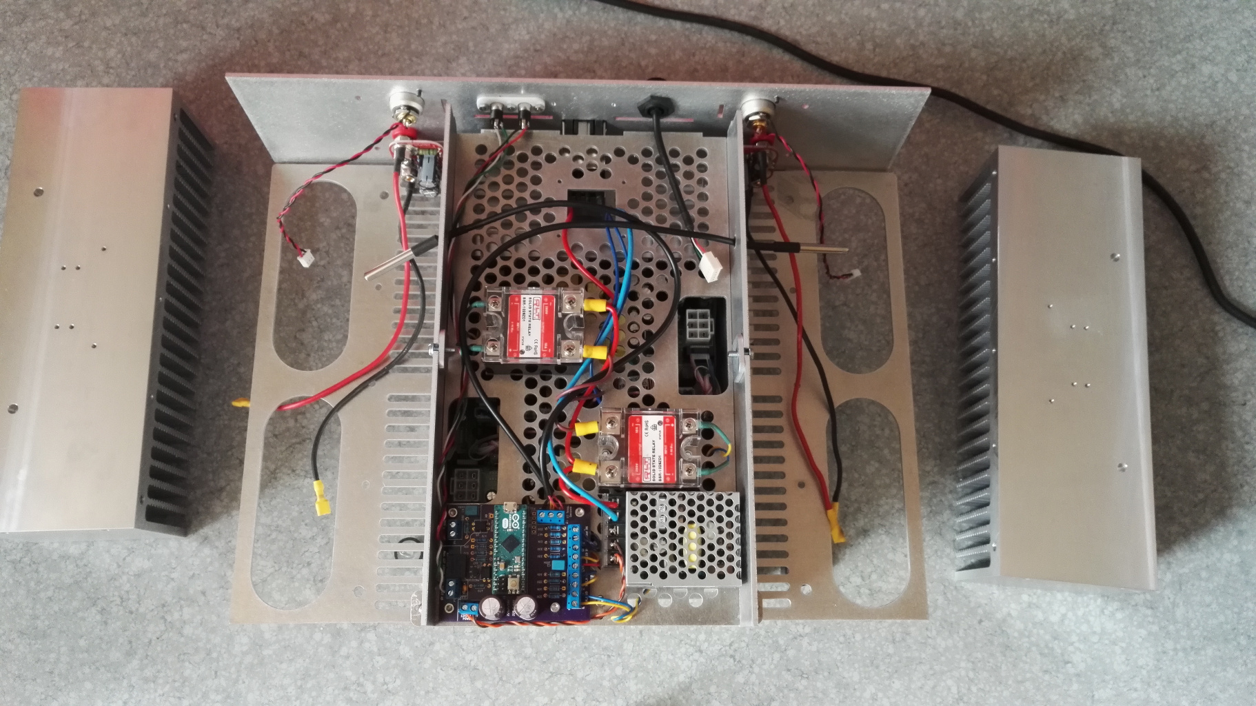

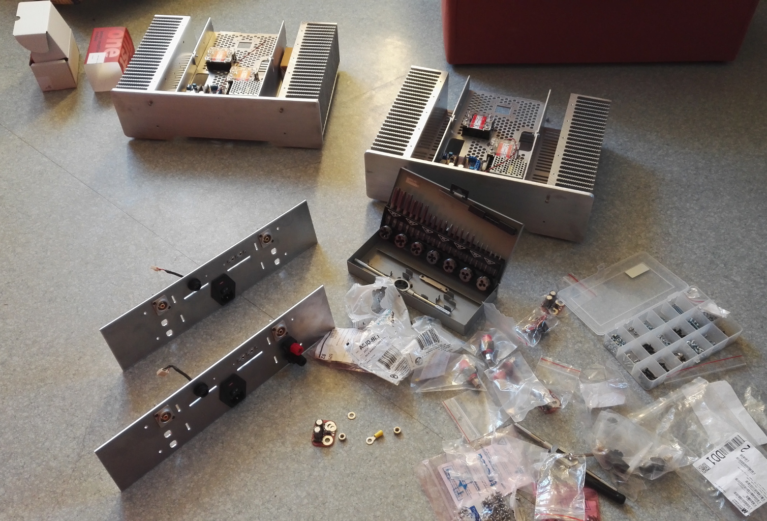

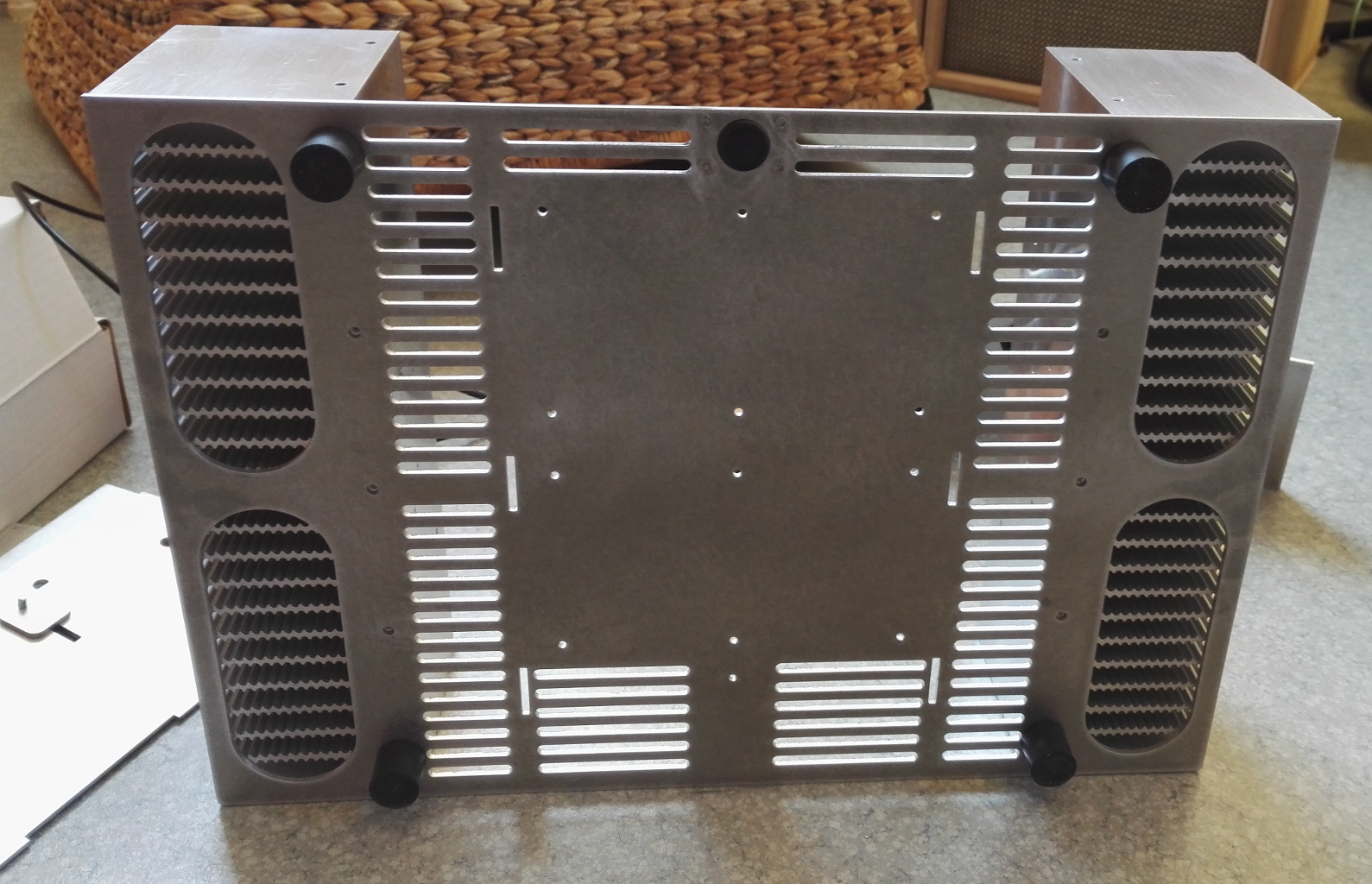

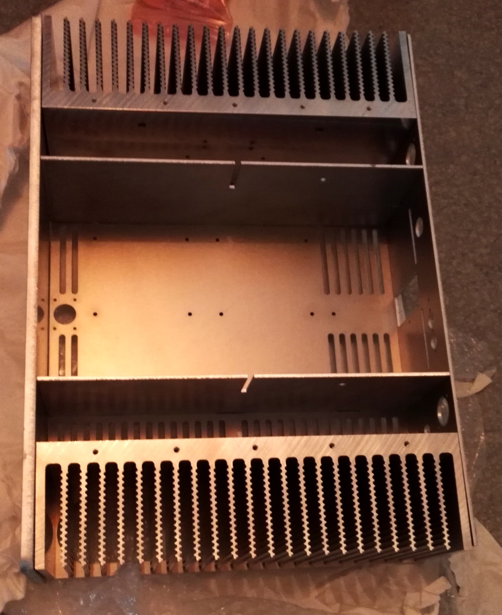

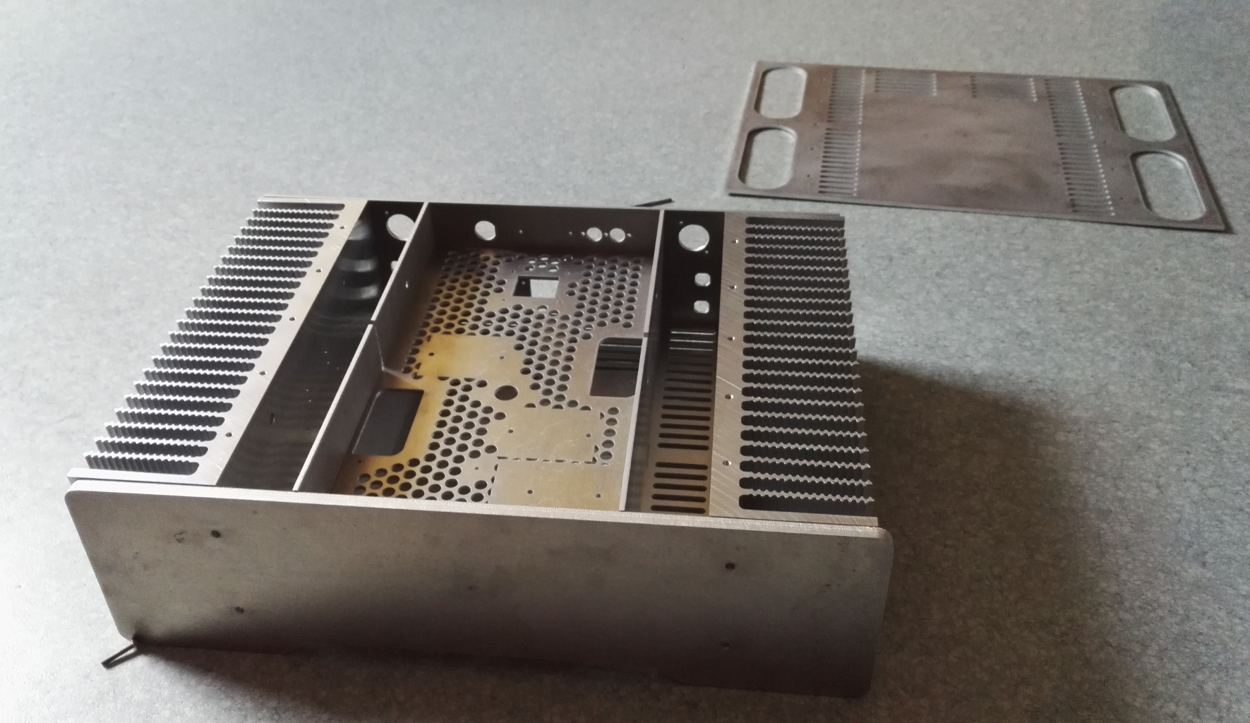

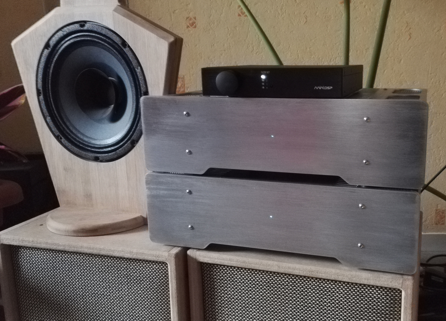

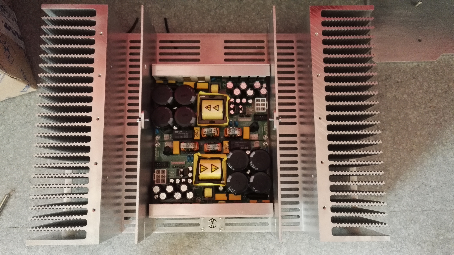

Here is my iteration of FO 1.4M amps.
I used Hypex SMPS as recommended by Andrej, laser-cutted aluminium cases of my design (mostly 3mm aluminium + 8mm on front), huge and beautiful heatsinks from CoolTec Gmbh.
Among added features, trigger 12v in & out, temperature sensors on each heatsink, low voltage power push button (invisible, bottom), RGB led on front (used for status, colors + blinking for sleep/startup/temp warning/etc), controlled by an Arduino.
On the back, i used fully isolated binding posts (Cliff CL159825, rated for 60A), Amphenol RCA sockets, 2 minijack sockets (for triggers), and USB connector.

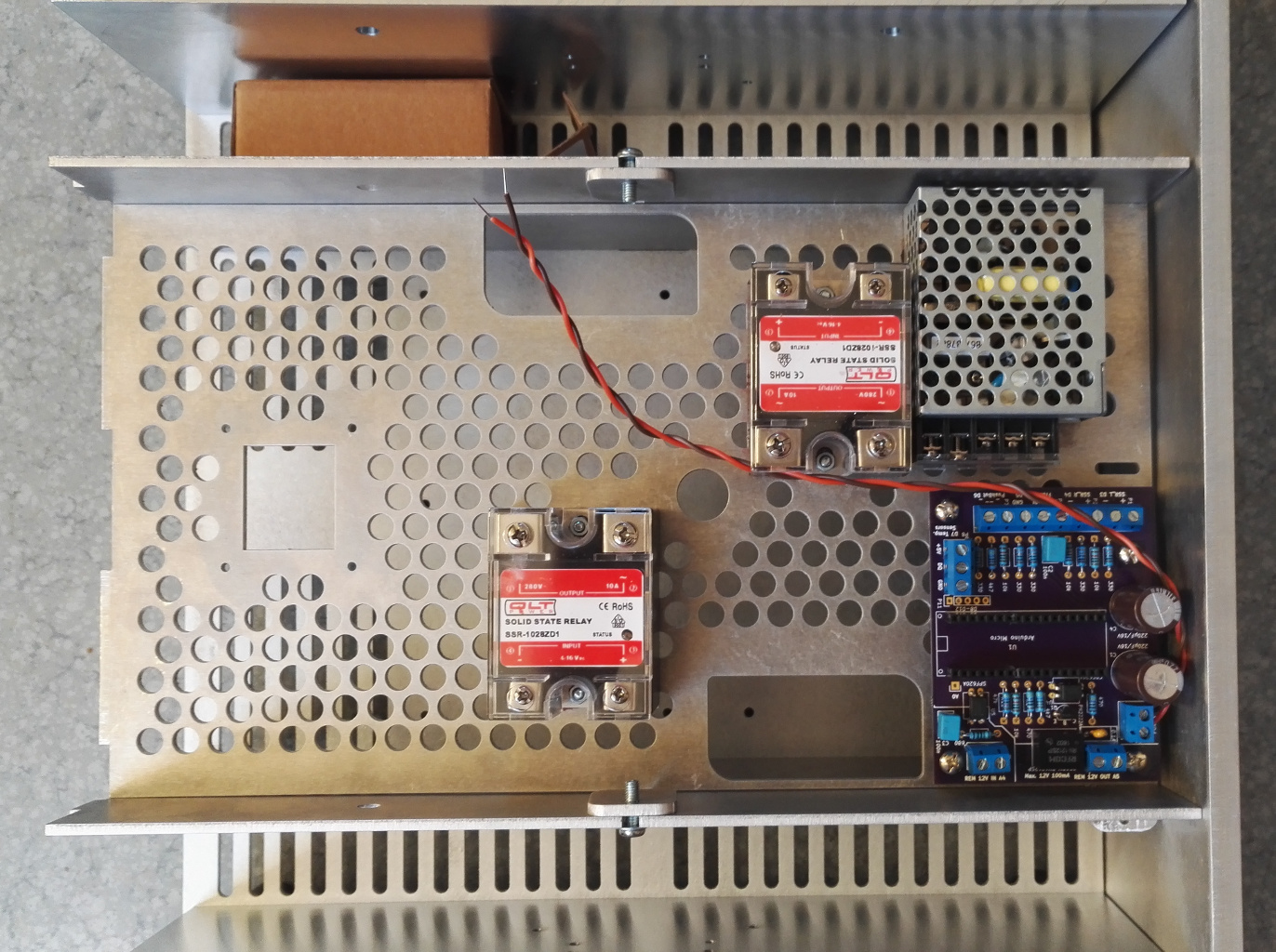

A small power supply with very low consumption powers the Arduino board, which controls 2x Solid State Relays, which controls power to SMPSs.
I used a medical-grade IEC filter with power switch and fuses to connect main line.
Control board & power supplies are enclosed in the middle of the case.
About the sound: well, i had more than 30 amplifiers during last 25 years, this one beats them all. It sounds very natural (clapping hands are just perfect for example), very fast (percussions are great), everything seems under control, clearly high end sound, i'm very happy with the result.
Drawback: input impedance is on the low side, my passive volume control doesn't work well (at all) with those amps (resistors/relays), that was expected, but it is even worse i thought 😉 I had no issue with amps with 70kohms input impedance.
Distorsion suddenly appears at some point, i had to remove this element for now, still investigating for a solution.
With an input impedance >50k, FO amps would be perfect.
Conclusion: buy those, follow Andrej recommendations about power supplies, no surprise it will just work and sound great.

Hi Danny_66,
Nice built, I like your implementation and wiring route.
Could you please share what softstart module you used?
Many thanks
Claude

Hi Zas,
Great effort, congrats aswell, and thanks for sharing all this.
Regarding the low input impedance and the use of passive pre, that is something that bothers me aswell. I asked LC about it and my understanding was (back then):
- indeed FO has a low input impedace with low values resistors to reduce the noise
- it seems easy to alter this somewhat without being to detrimental to sound by just changing 1 resistor.
=> Perhaps worth asking LC?
What passive pre are you using? I figured out that a basic 10k log pot should do the trick though (as its worst case output impedance is likely to be in the 2.5k region, whereas FO 1.4M has about 10 times that input impedance). Please let us know what values you are using, interesting...
On an other note, you said you had more than 30 amplifiers, could you name a few of the best ones? What loudspeakers are you using? I have recommended FO to a friend of mine, but sadly somewhere direct comparisons with this little gem are scarse... making absolute evaluation not easy.
Many thanks
Claude

I used commercial amps from Electrocompaniet, Marantz, AudioAnalogue, Rotel, Bryston, etc, plus various chip amps (class AB, D, E, T), plus various DIY projects. Either in stereo or multichannels.
I'm now using DIY loudspeakers derived from Hestia V project, open baffles / full dipoles, requiring 4 channels (bass in H-frames up to 120hz with 4x30cm, actively crossed to a mid-bass/med/high "head" with 25cm + 10 cm + tweeter, passive crossing between those). All speakers have been chosen mostly for their low distortion and my use of them.
I would say the whole system has a very hard to beat quality/price ratio, and FO amps are just fitting very well in it (being very high quality and realisticly priced).
FO amplifier isn't as warm (sound-wise, not temperature-wise) as some amps, but i'm looking for natural & neutral sound (read high fidelity sound), bass is tight and here when needed, highs are clear, metalic sounds are ... metalic, horns sound like horns, air is vibrating, rythm is there, what more to ask ? FO amp is just a great amp, that let me concentrate on other parts, that is the source (bad source=bad sound, good source=possibly good sound), and the loudspeakers+room (which are by far the weakest point in any system).
I'm listening any kind of music, from classical, to the heaviest metal, FO amp just does it, whatever i play, it just sounds good.
Anyone looking for a good amplifier should consider First One, together with a very good power supply. Setting up FO according to LazyCat documentation, isn't hard at all (though it requires patience, mine were just off, now all have 280mA, 180mV, <+/-5 mV DC as recommended). I started the project in last october, designed cases, and control board, ordered heatsinks, etc... it would be much simpler to order assembled amps from LazyCat (and not expensive, if you consider the quality), especially if one isn't used to DIY electronics. I don't regret my choice, the result is fitting my expectations, dead silent amps (when no sound) with impressive dynamics and neutral sound.

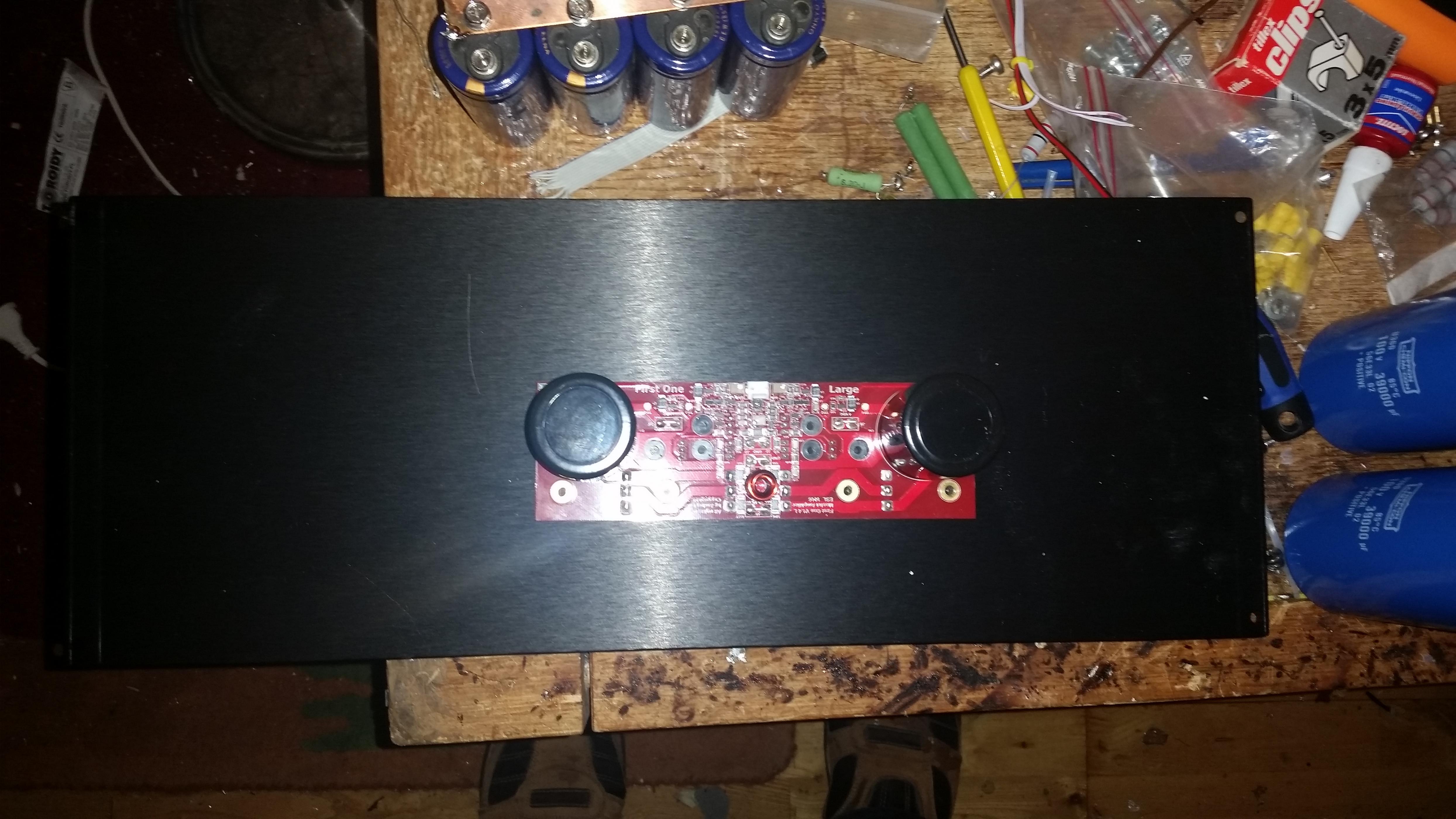

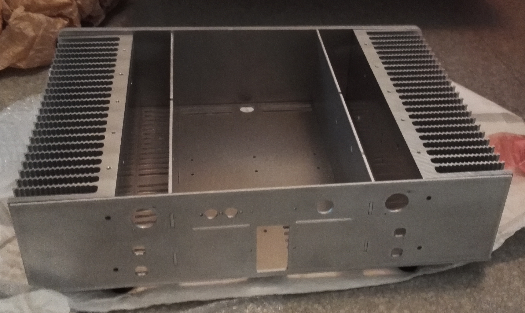

Here's my new build coming along!
I will post more pictures when completed. So far it sounds quite good!
The SMPS are mounted on the front panel as you can see and the chassis kinda looks empty but it will eventually be filled with the FO L modules so it will leave room for the cap banks.
