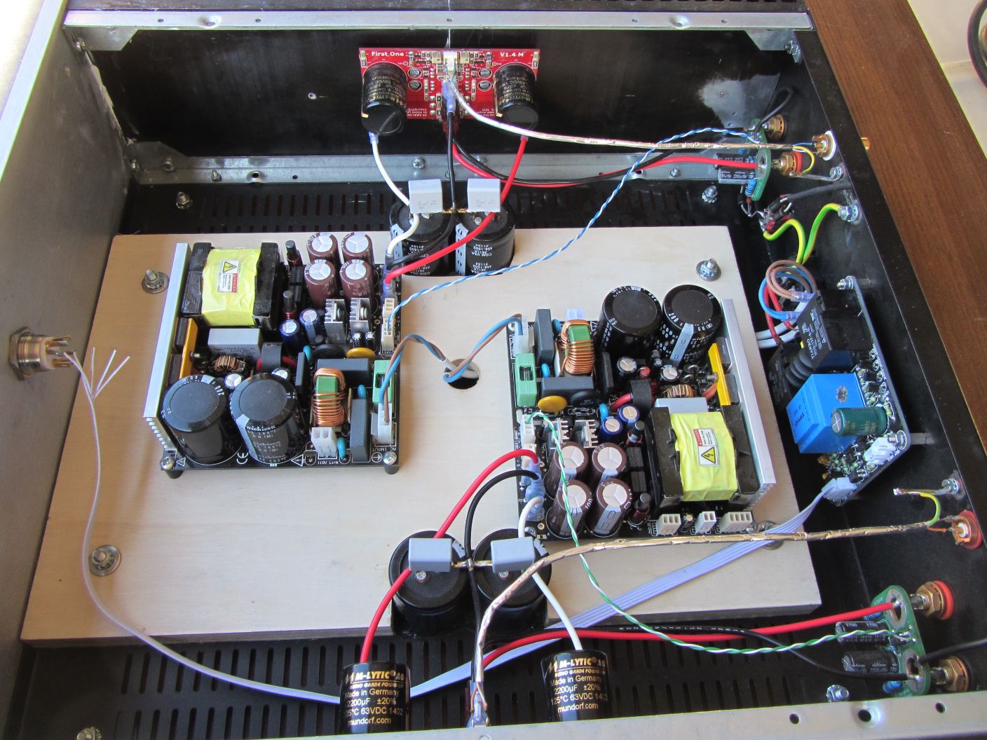

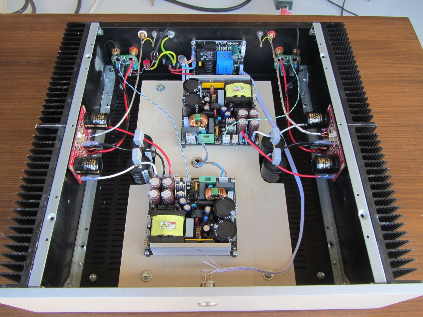

Hello,
Here are some pictures of my FO 1.4 build 🙂
I used the zero switching SMPS from Cresnet, works great.
There's also a softstart module mounted on the back panel, that allows me to use a low DC switch on the front panel and keep all the mains AC wire at the back, far away from signal.
There are also extra CDE LX381 caps on each rail, works great with the SMPS.
The softstart keeps the inrush current at startup low, even with the extra caps.
It is also a very good sounding amplifier 🙂
Danny

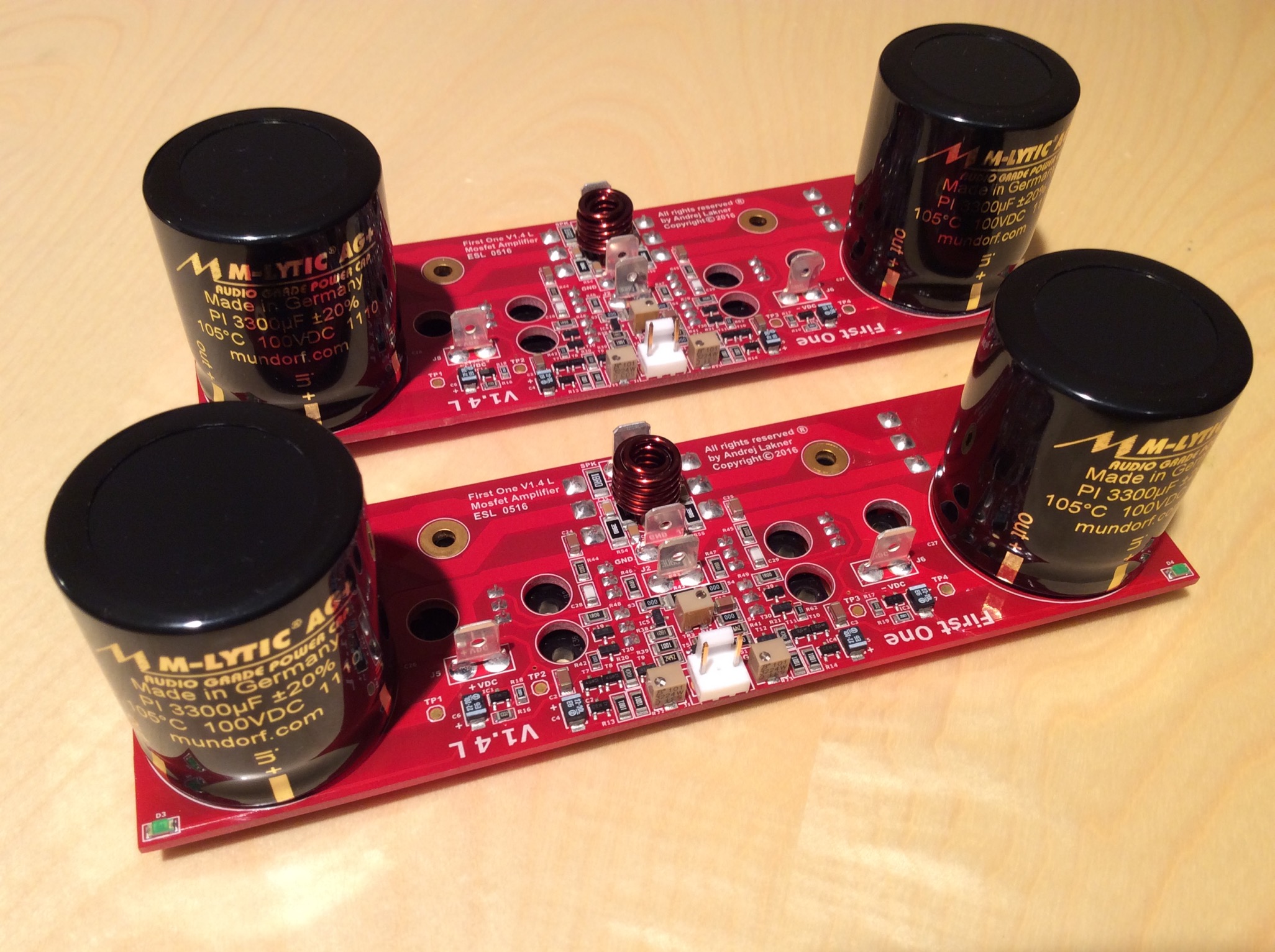

First One L deliveries started
Hi guys :wave2:
Happy to announce that the First One L modules series is tested (personally by me) and ready for deliveries (first four modules already sent). 🙂
Measured at +/-80 V supplied by SMPS3kA700 it gives 648 Wrms/4 Ohm, 20 kHz. :hbeat:
Members already sent inquiries expect to get proformas in next following days, all other requests welcome, contact email in the first post. 😉
Happy Seasons Holidays, L.C. :xmastree:
