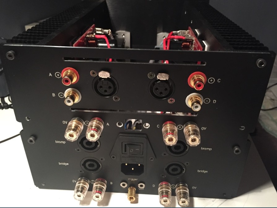

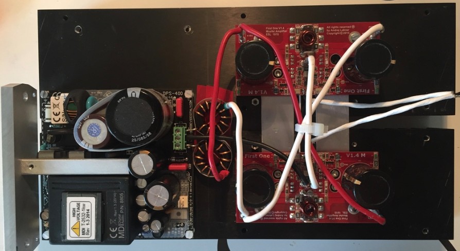

I ve been recalibrating my quad FO box this week so I can suggest the folowing
you can use a 0.22ohm resistor. I ve got a rectangular 10W but you can use a 3W (P=R.I^2 you are safe) and then you will read 62milivolt (U=R.I)
LC is right, adjusting the driver stage for reading 180mv has to be done when the temp is settled, and from my experience this is an iterative process over say 1 hour (after 1 hour of heating) . also you should do the adjustement in the same condition of the final implementation of your amp in a case with the cover part as this will change the inside temp.
Finally I d say do not uderestimate this topic, if you have less than 150mv (ish) the driver stage will leave class A and will produce lots of harmonics but once you are at 180mv the driver stage is cleaner than your bathroom and you're the king. If you have to make tradeoff with the offset adjustment then this is more important than few milivolt of offset on the output.

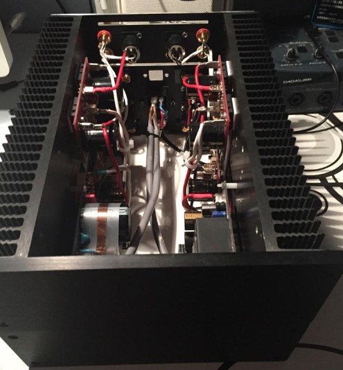

VAS bias is very important, as we have TO-126 on the main heatsink power dissipation is not an issue. Personally don't like DC servo and its influence to the sound so few mV DC on the output seems like a fresh breeze.
Please consider that audio output current likes low impedance across supply rails to flow happily, as closest to power amp the better. Adding 10 mF Mundorf per rail is good enough, empty space in your chassis looks promising.
And finally, congratulations on your four channel's amplifier, it looks very professional and very seriously build. If you could write something about the sound it would make me happy and thankful.
L.C. :cheers:

Hi Fredlock, thanks for your feedback

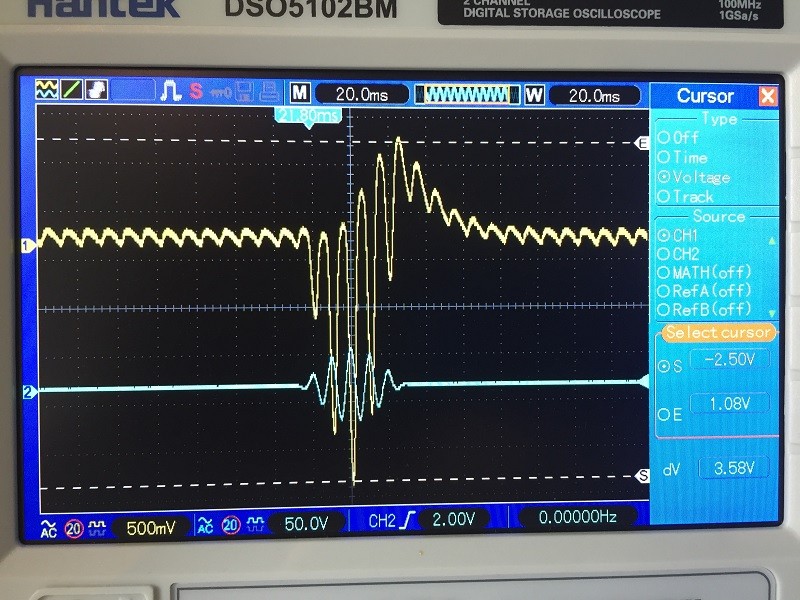

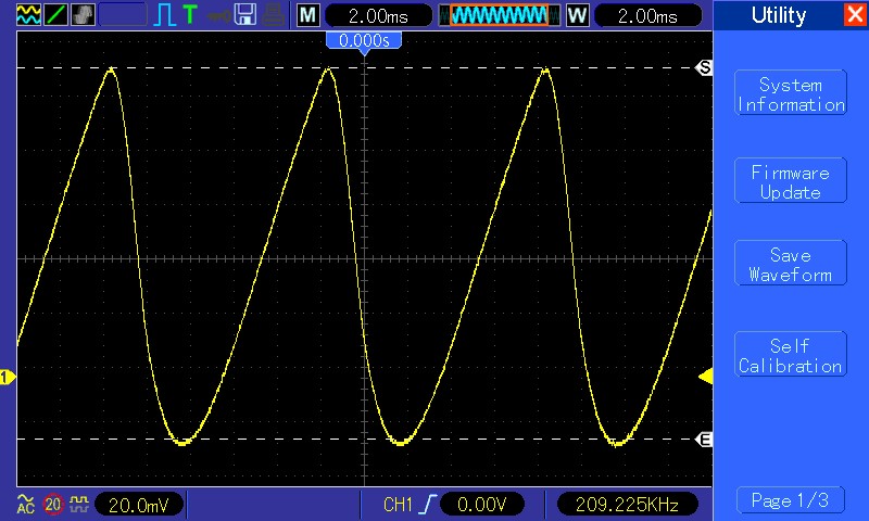

for this configuration, I m using an audiopower DPS400/S2 providing 52V on each rail for 2 modules. But a "S1" version would be more than sufficient for a single module. Here below 2 pictures from my DSO scope showing 52mv rms ripple @100hz (averaged 128) which is very good considering 2 modules load. and a burst at 100hz with FO providing 25vRMS into 3ohm load (=200w) you can see the rail droping only 3volts and recovering quickly.
I ve lowered the overall bias to 240ma per module per rail in order to get a 47°C when the case is closed. each module mounted on standard 300x40x80mm heatsink.

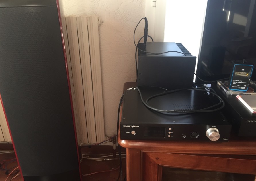

when it comes to sound , and with the gustard a20h 😉 this is just fantastic and clean. For me the FO is like a magnifier
