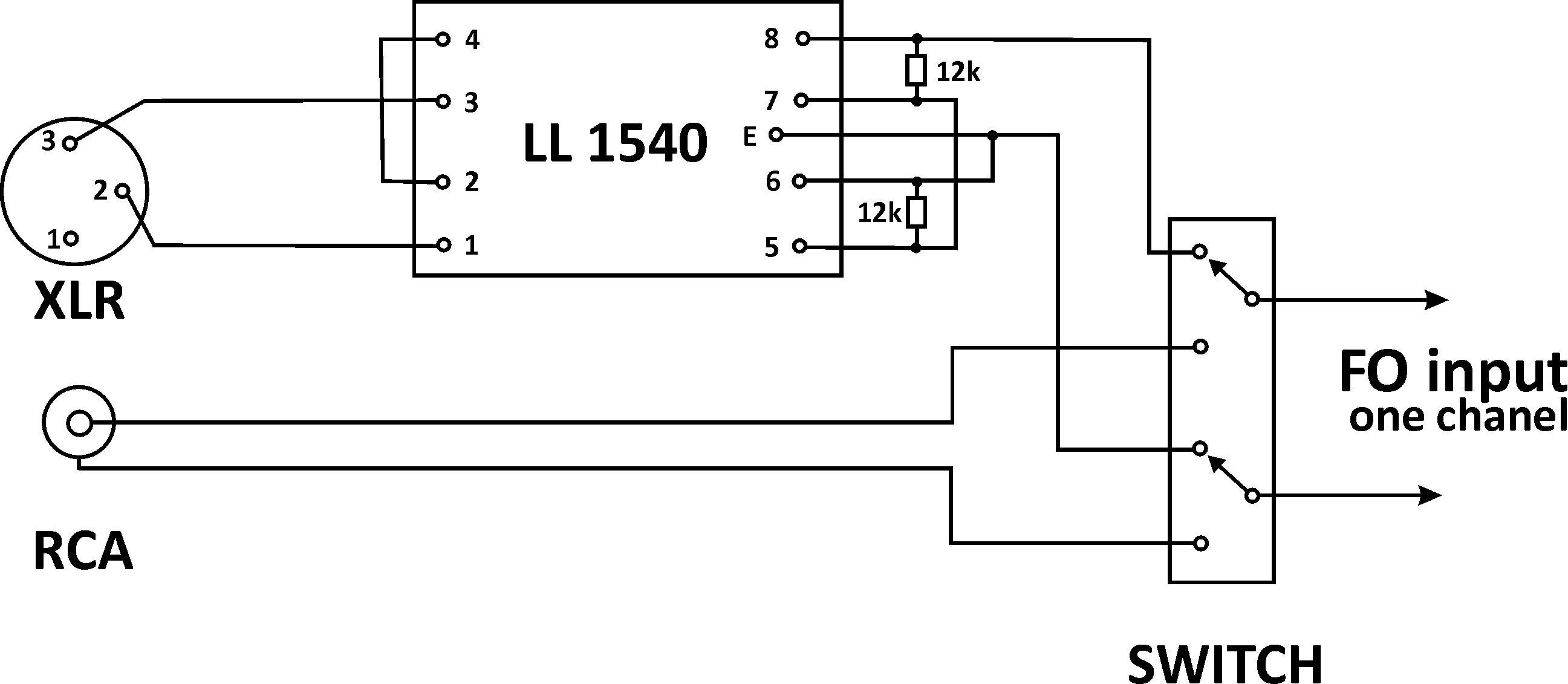

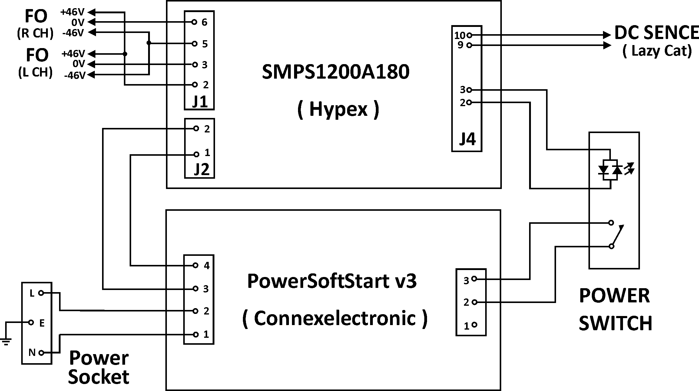

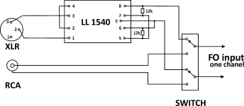

Hi! Congratulations on your build and result. In your pictures I saw that you use Balanced and unbalanced inputs separated by a switch and a transformer??? I would like have the details on that..
Also in the middle of the pictures i see a "soft start???" or something? I would like to read the details on that also...if I could...

You can read the article on Audio components grounding and interconnection in the wikipedia here.
It is quite huge but useful and they have a section describing the balanced unbalanced switch as well

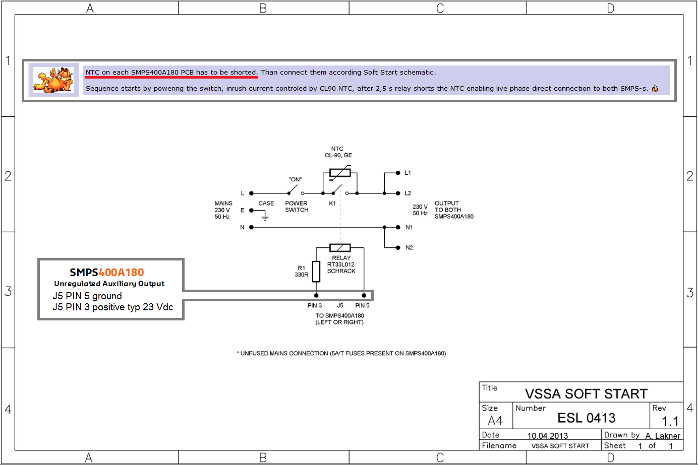

....."soft start???" or something? I would like to read the details on that also...
For softstart Lazy cat came up with this simple 3 components schematic over at VSSA thread, maybe you can adopt that to whatever model or brand of SMPS you intend to use.

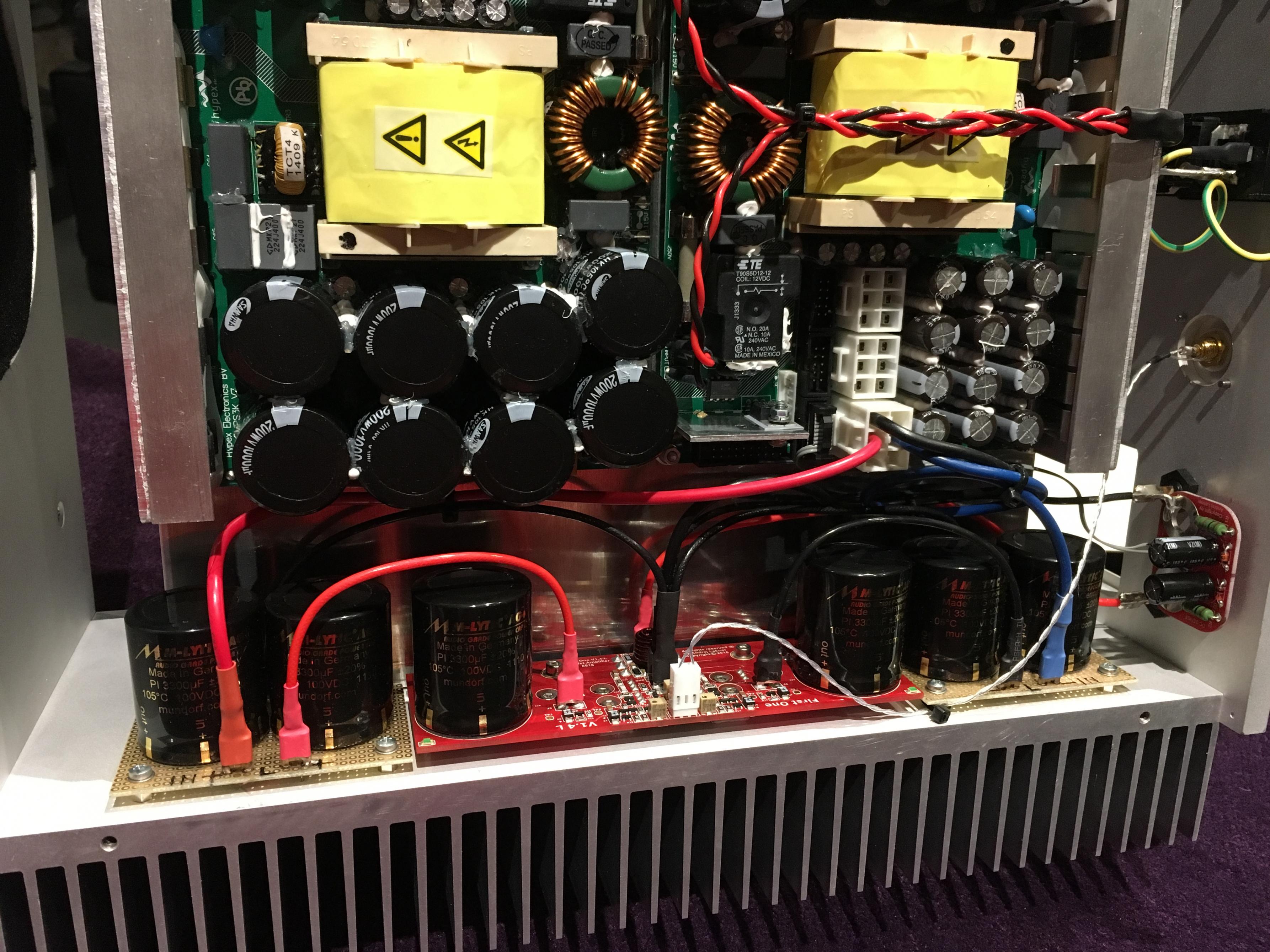

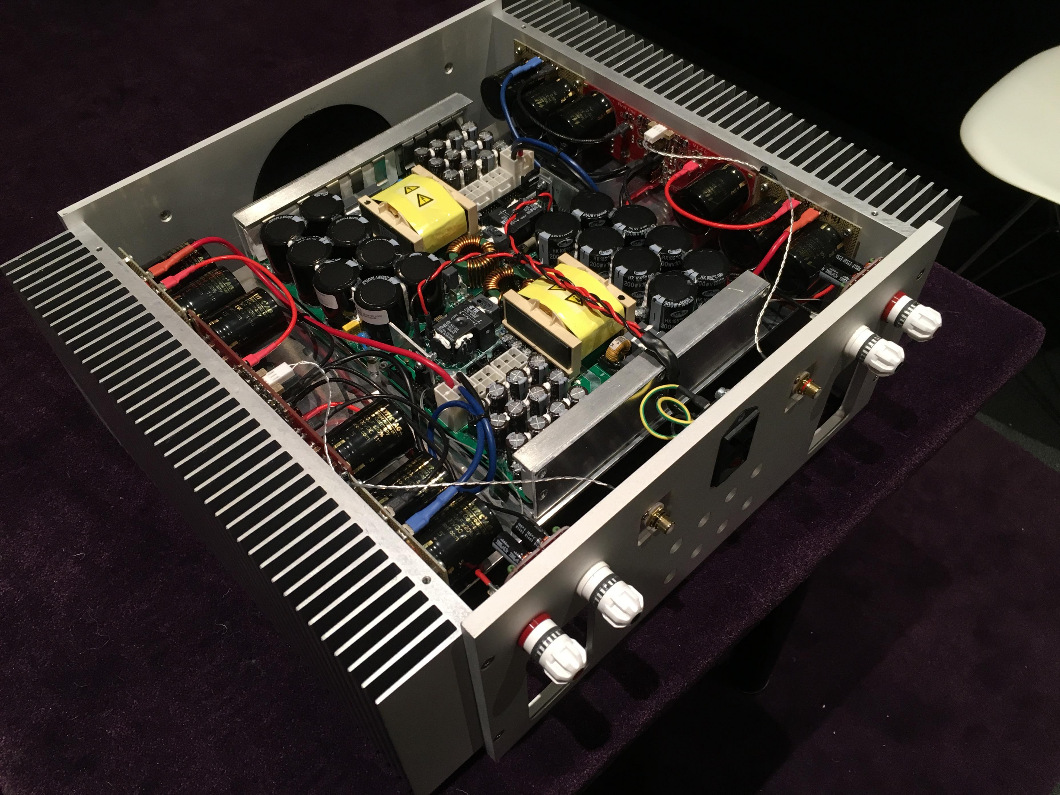

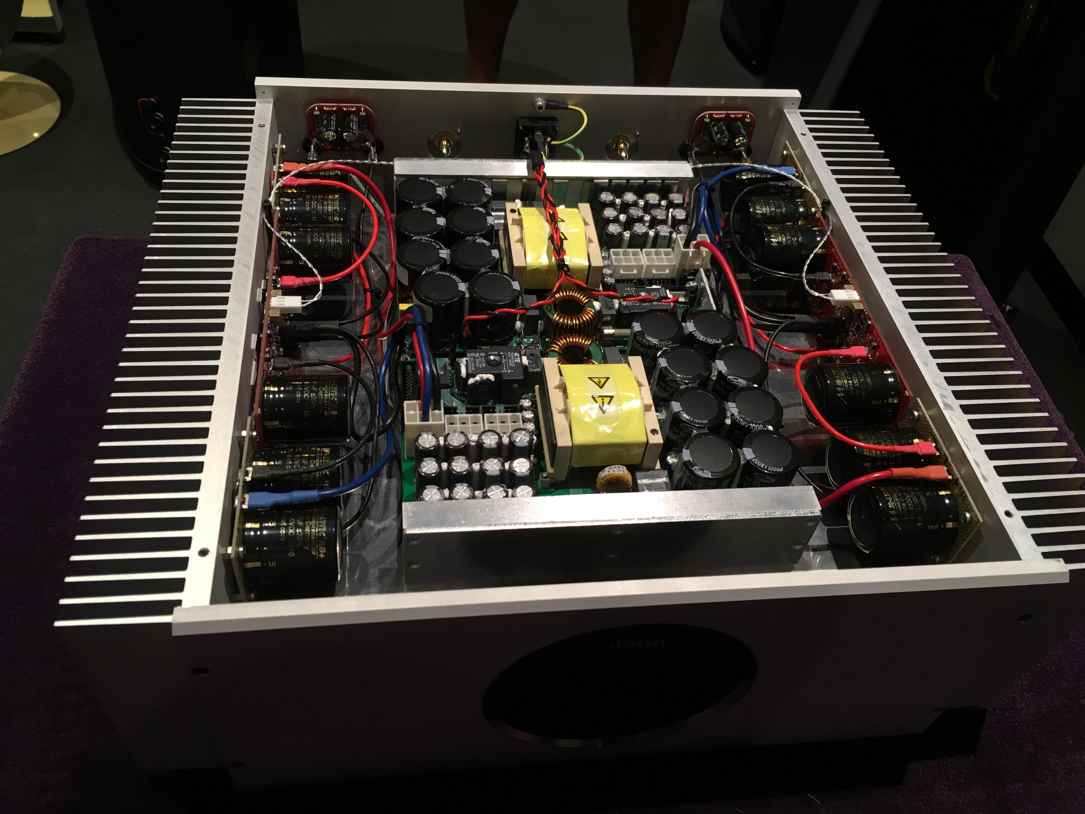

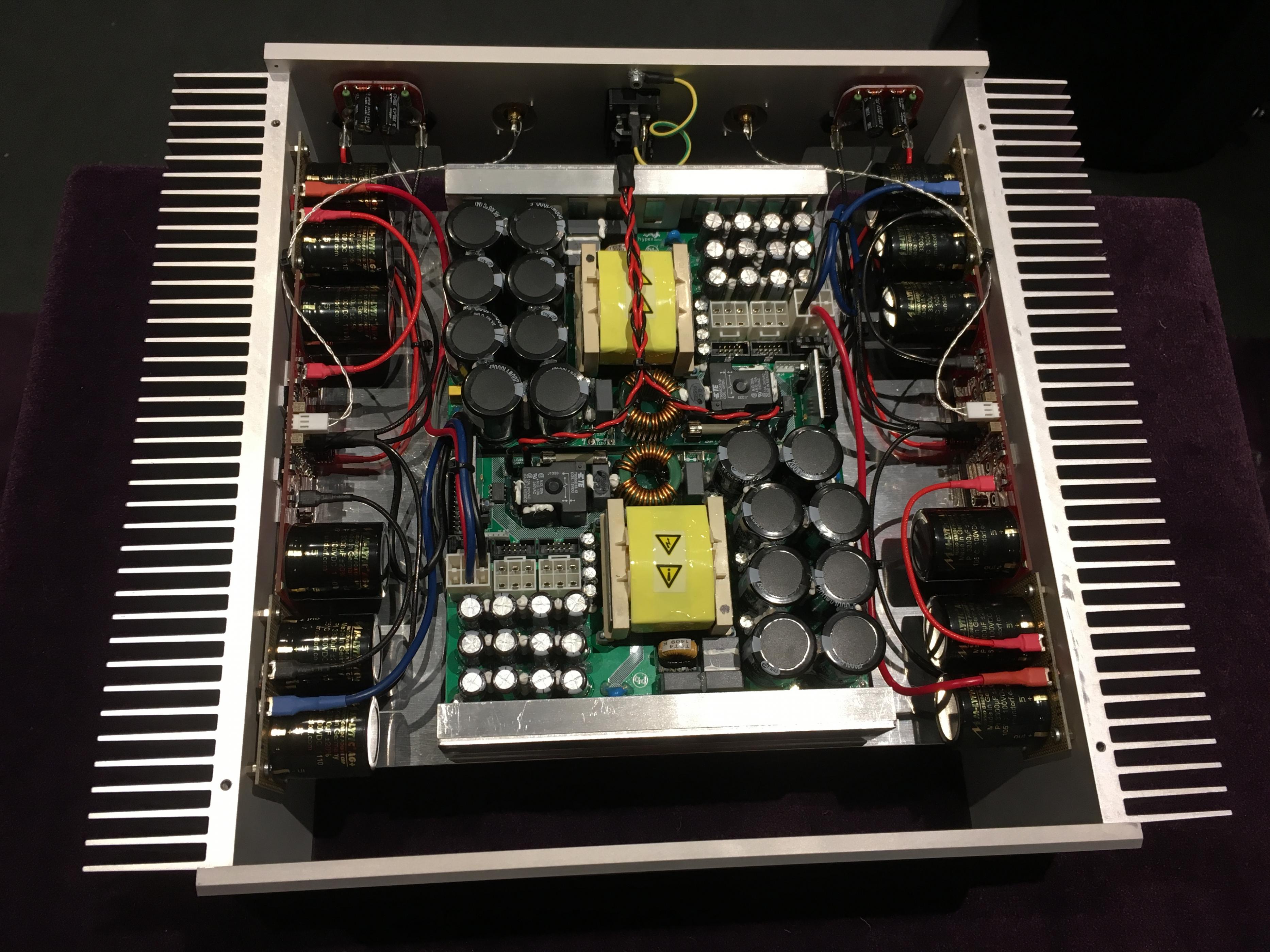

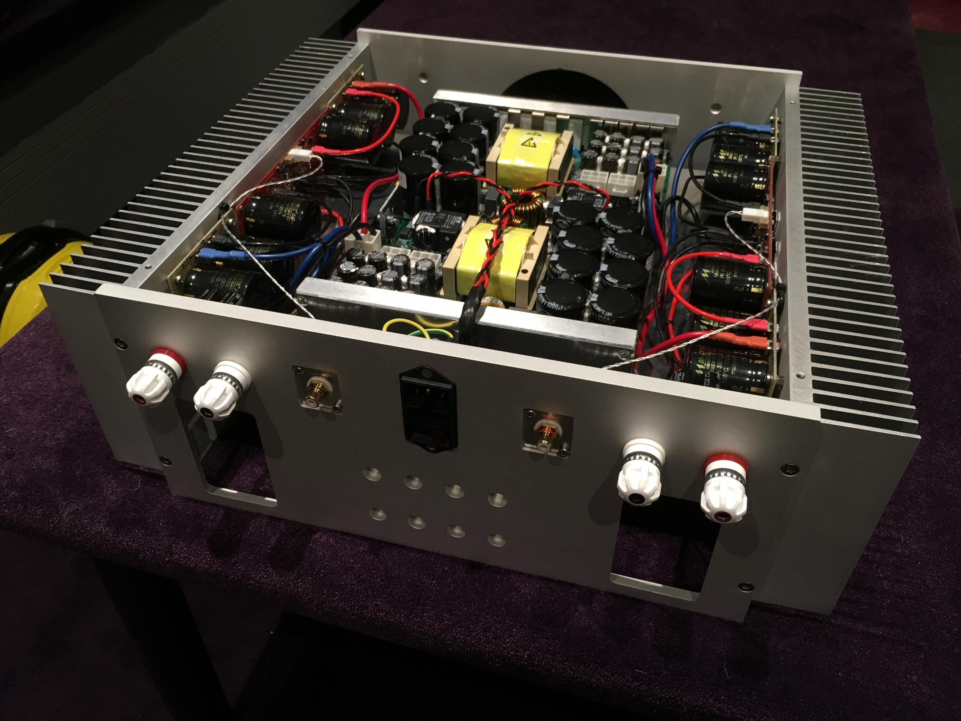

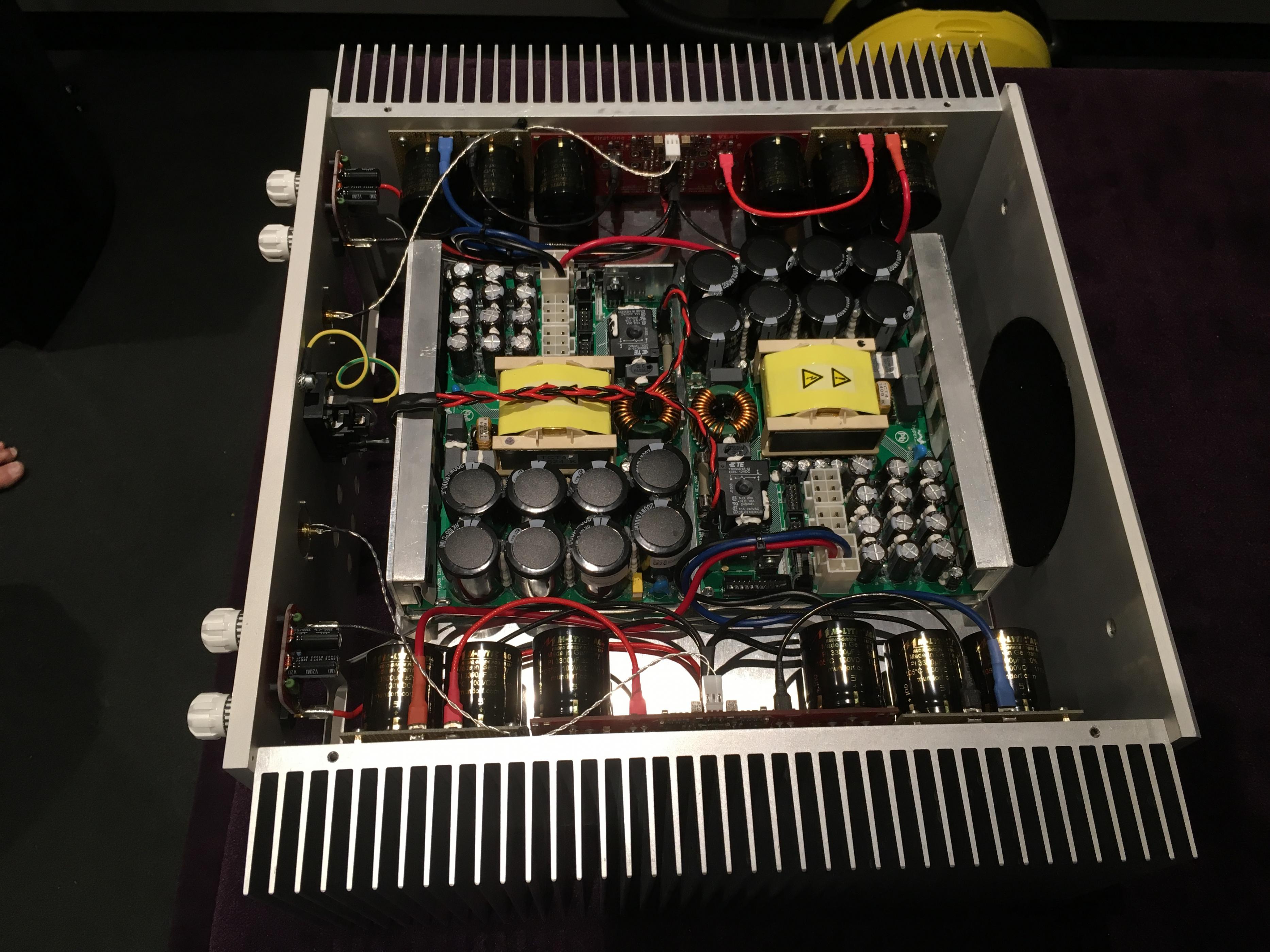

It lives..
.. a glimpse of what was happening in Sin Bin 😎

Looks good.
Is the capacitance not big enough on the hypex SMPS since you have made 3 times bigger than usual. ?
BR
Sonny
Based on my own humble effort, sound quality is also (as in linear PS) dominated by the quality of capacitor used and by the total capacitance, even if SMPS seems technicaly flawless. I am about to make the same with Hypex than I did for Connex.
http://www.diyaudio.com/forums/soli...pictures-reviews-comments-here-please-72.html
post#1797
If experiments are successful, it will make me think if there is a benefit in buying "premium" SMPS.

Thanks .. shaping the SQ 😎

FO L pics says it all 😉
we need more info about this beast
real life experience in the neighbourhood
First One was best all the way.
:yes: :yes: :yes:
Very nice beast LC!
Question for you... Are those original WBT Nex Gen binding posts or copies? If copies, could you please send me a PM of the source?
Do
all seen in pics are genuine parts: WBT, Mundorf, SMPS, FO L .. :cheers:

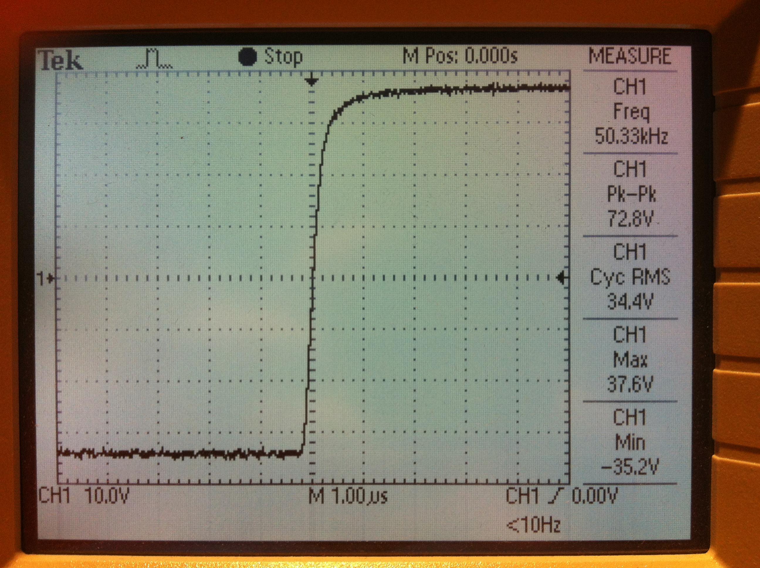

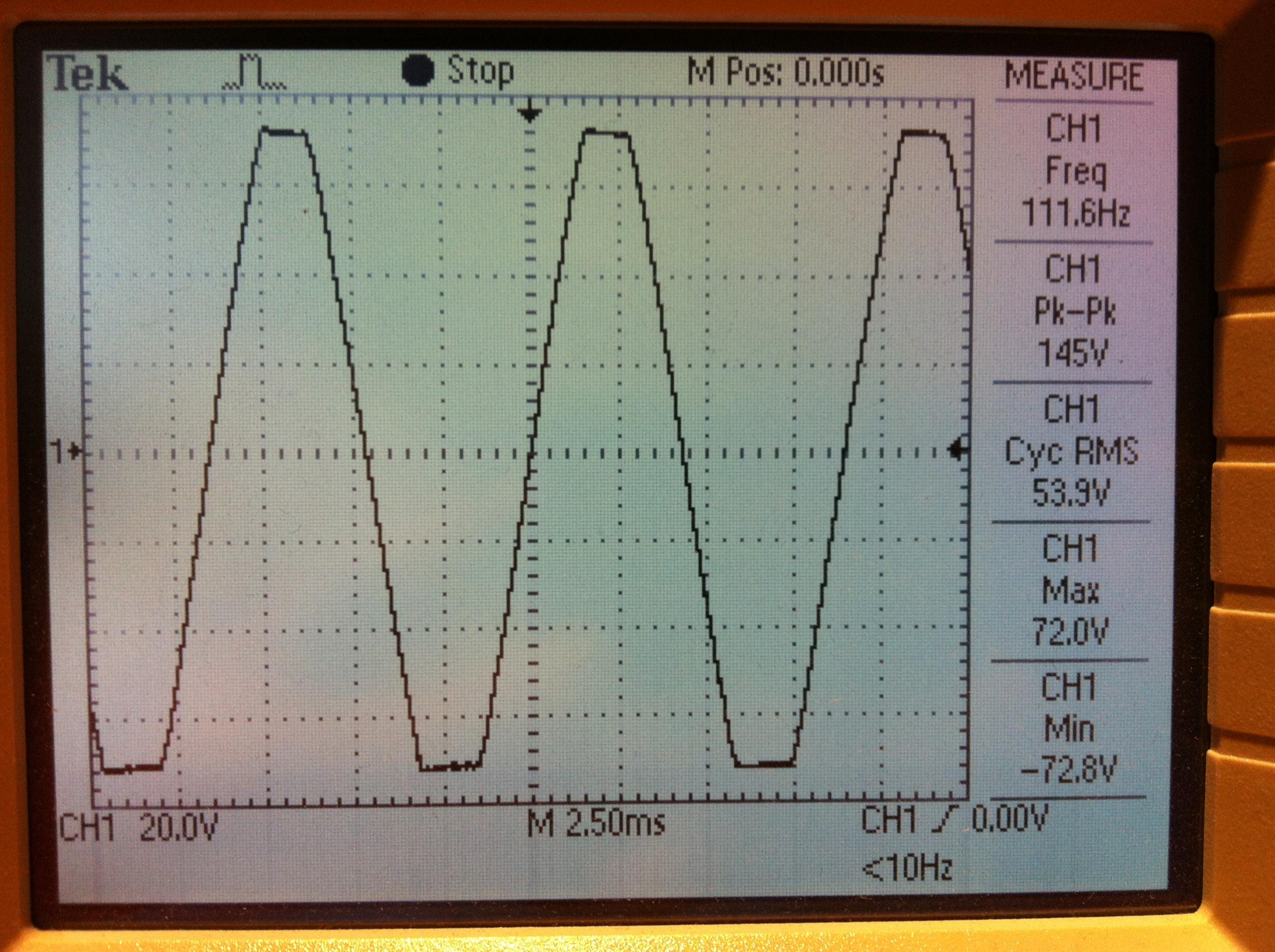

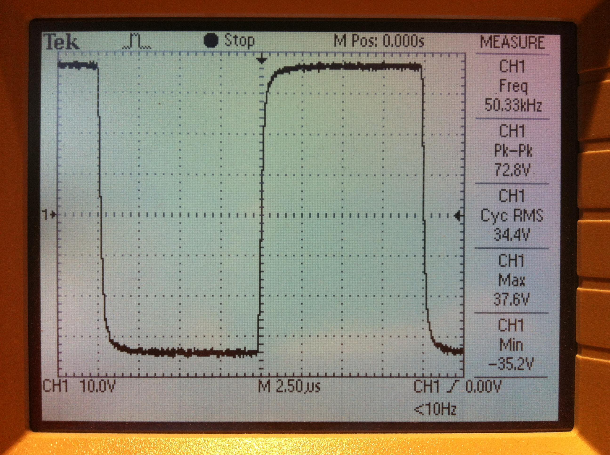

First One L
Hi maxidcx :wave2:
You're right, monstrous First One indeed, look below what I got at measuring it, all three pics on 4 ohm load. Square wave's shape & step follows slew of the signal generator, actually FO's slew alone is few hundreds V/us. FO L is a rock stable in all conditions, even hot as hell.
How's volume control with display and remote?
L.C. :cheers:
