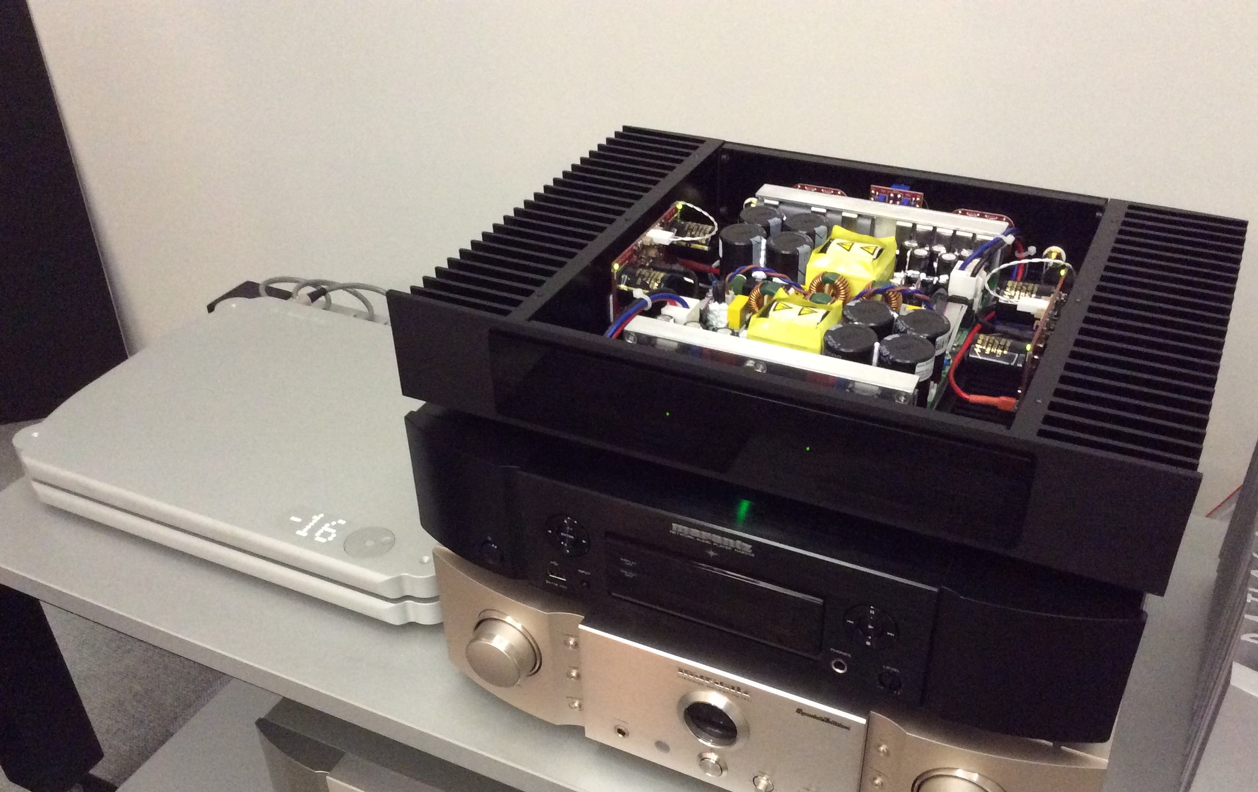

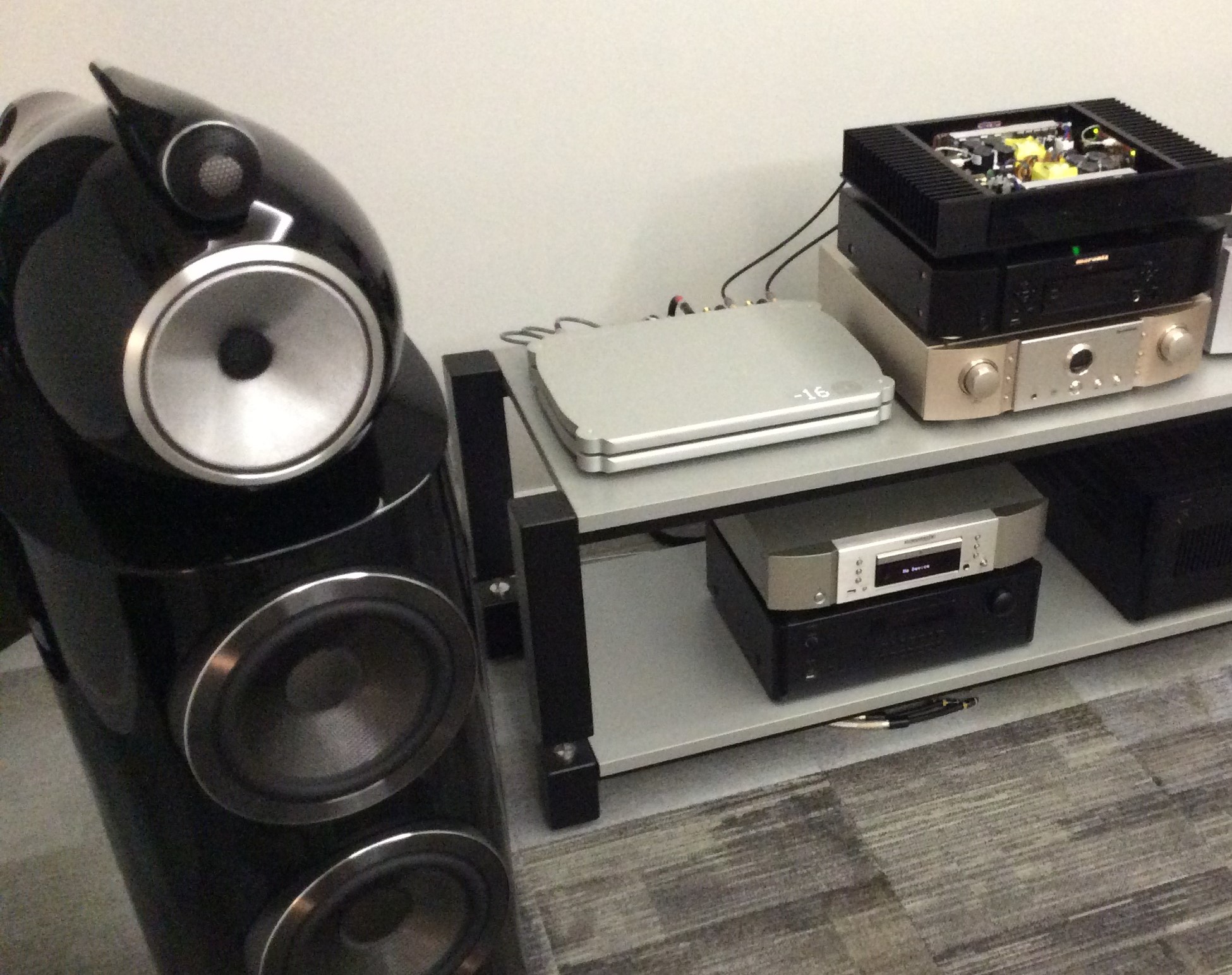

Much better, the 1.4 a completely different amp.I am very curious of the sound from the new models though..
R.
With the 1.3 I was missing transparency, detail. The 1.4 has it all 🙂

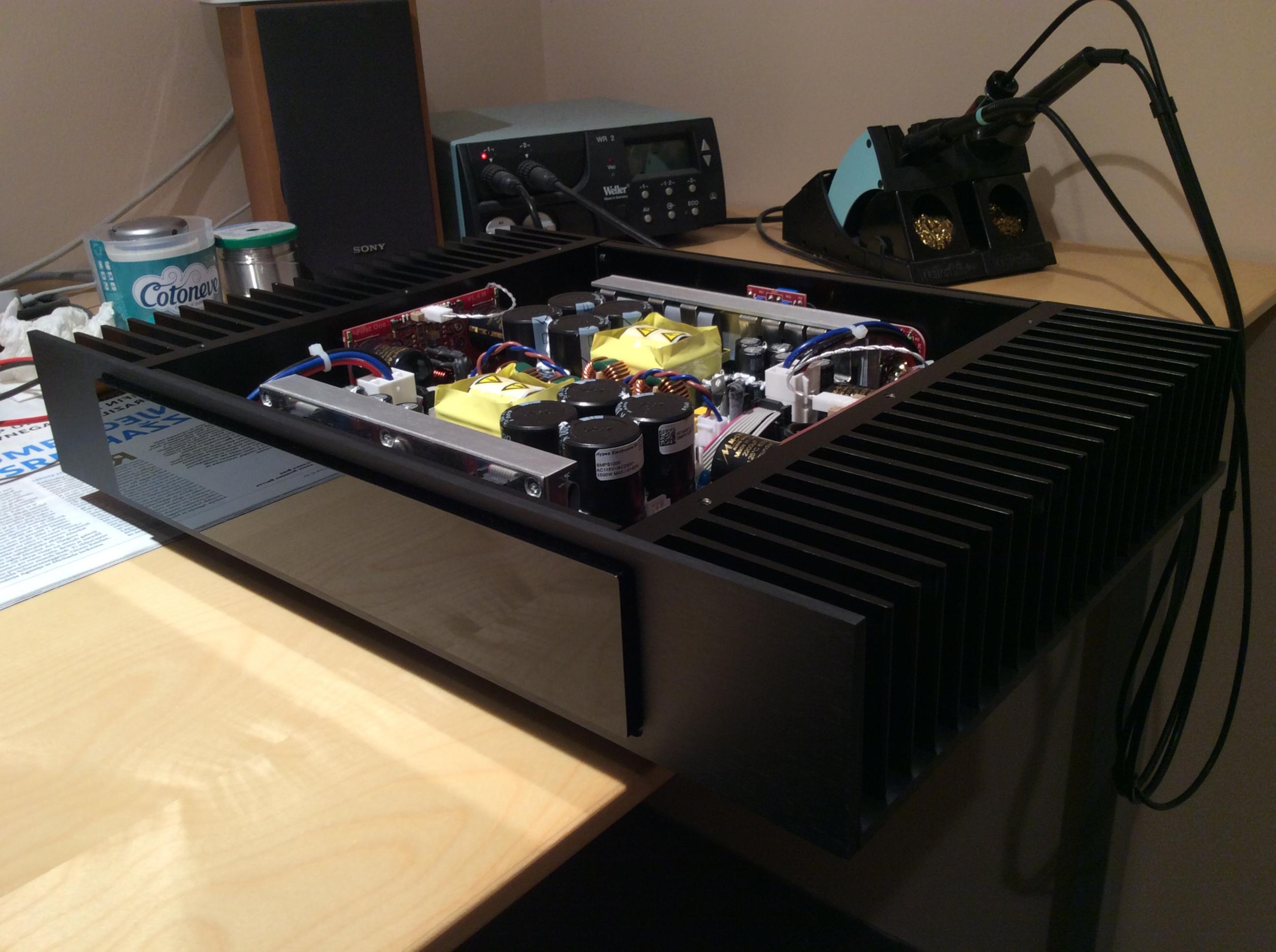

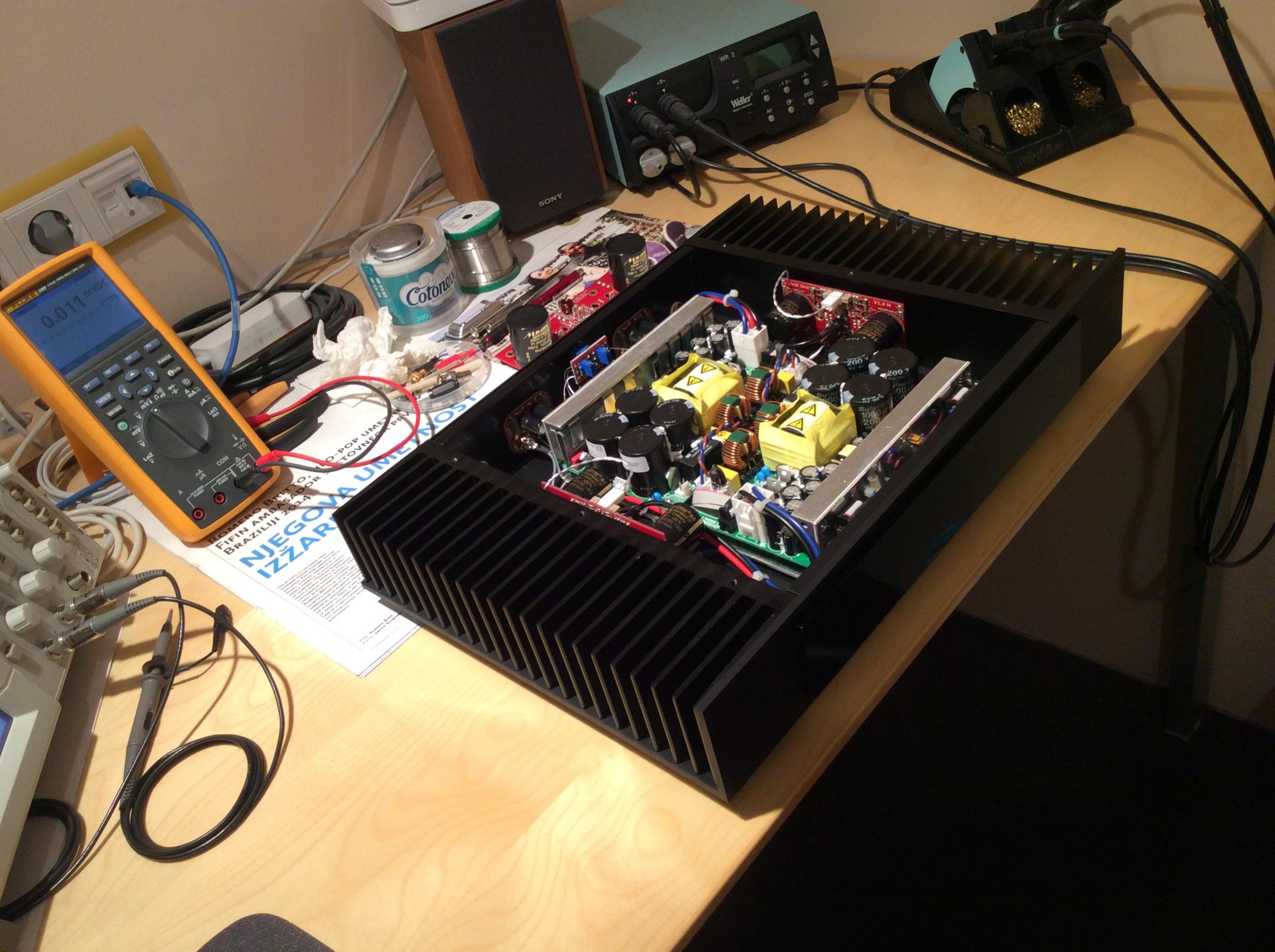

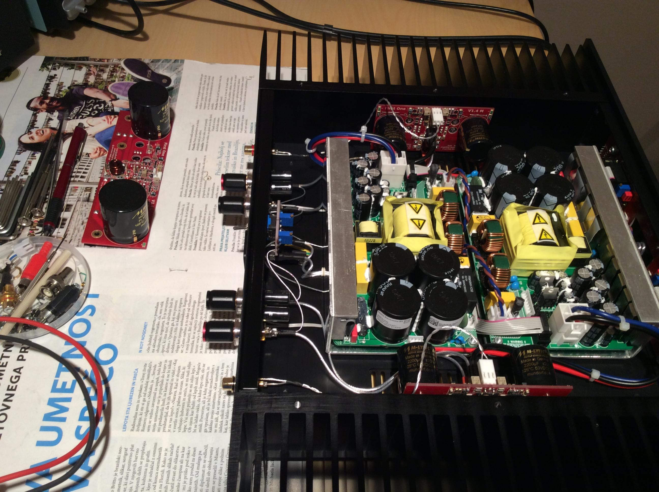

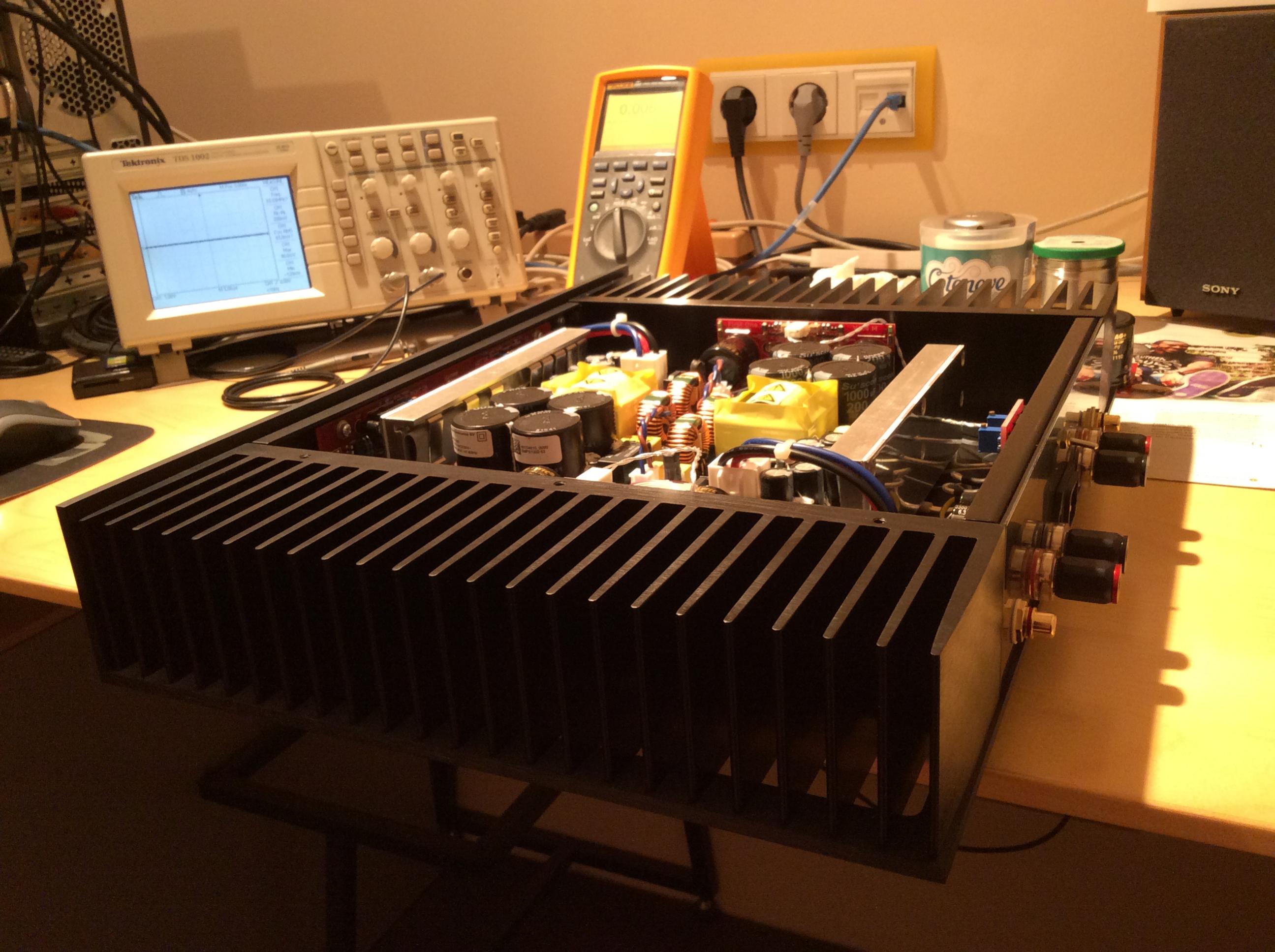

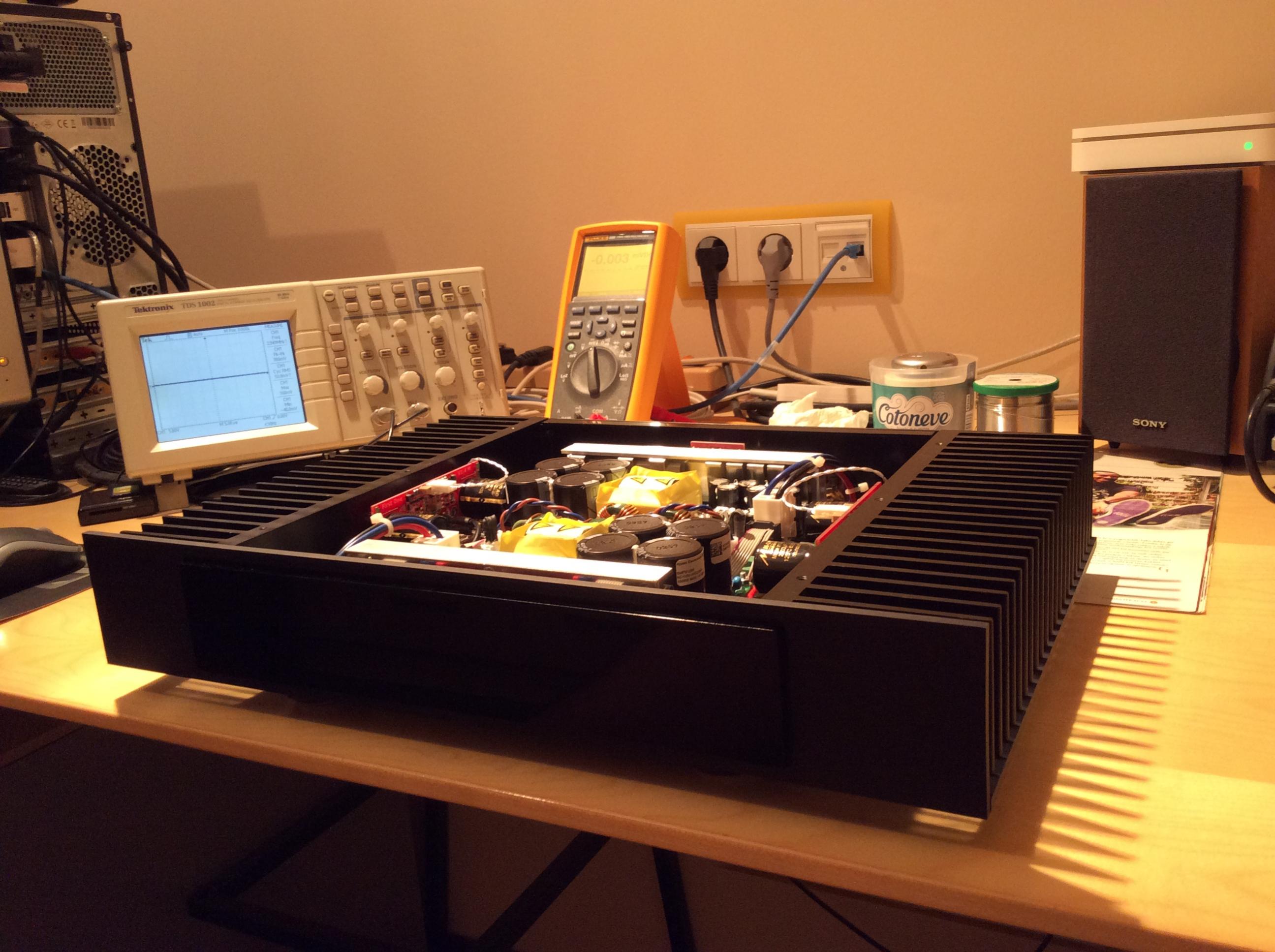

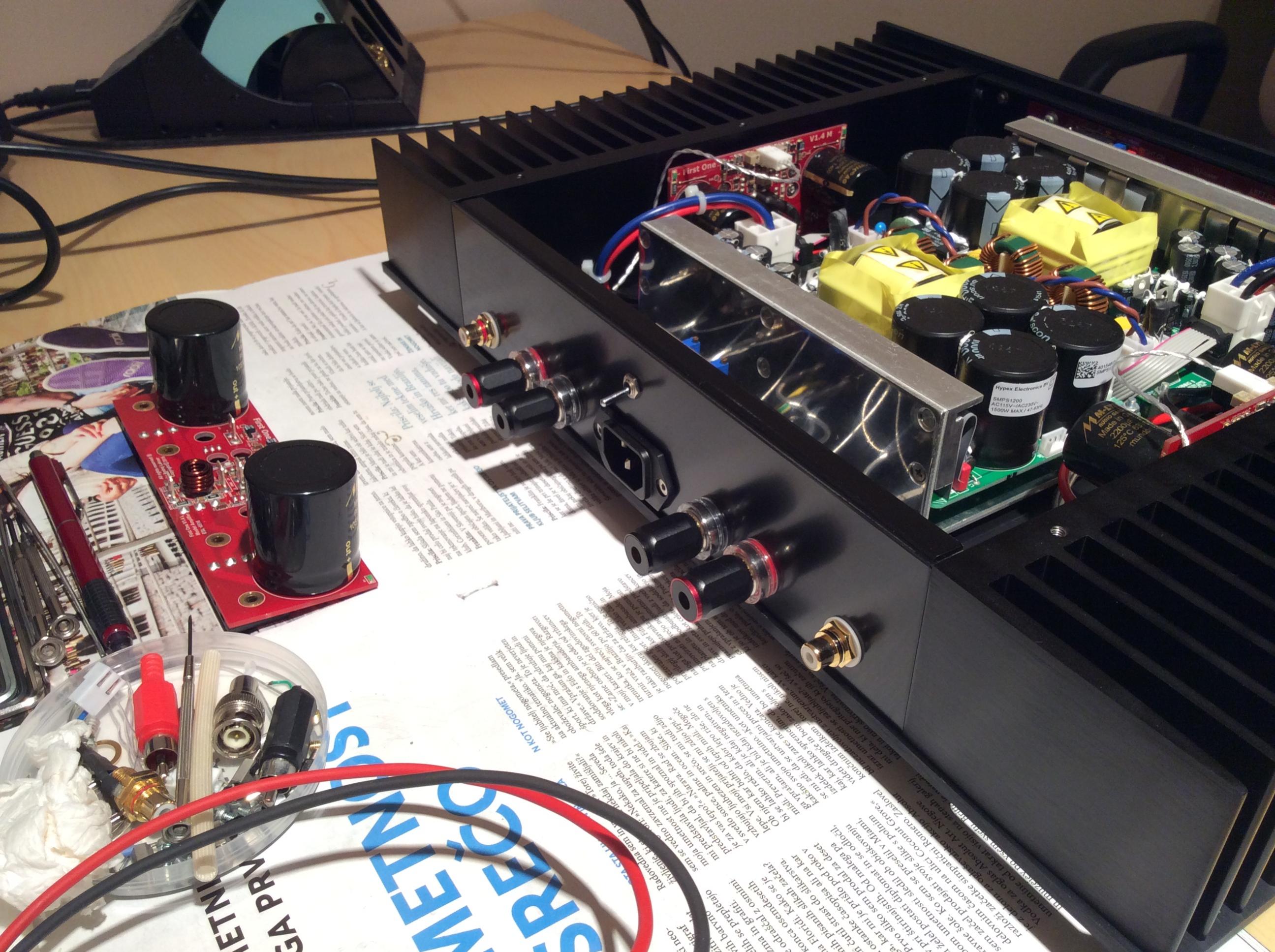

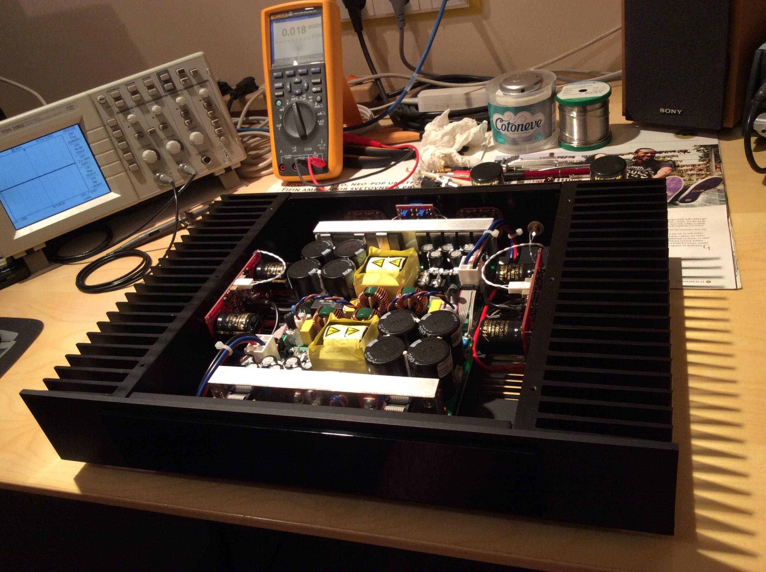

New First One M Black Mamba
Just made new Black Mamba for my friend. 😎
Cool build Andrej, and lucky friend! 🙂

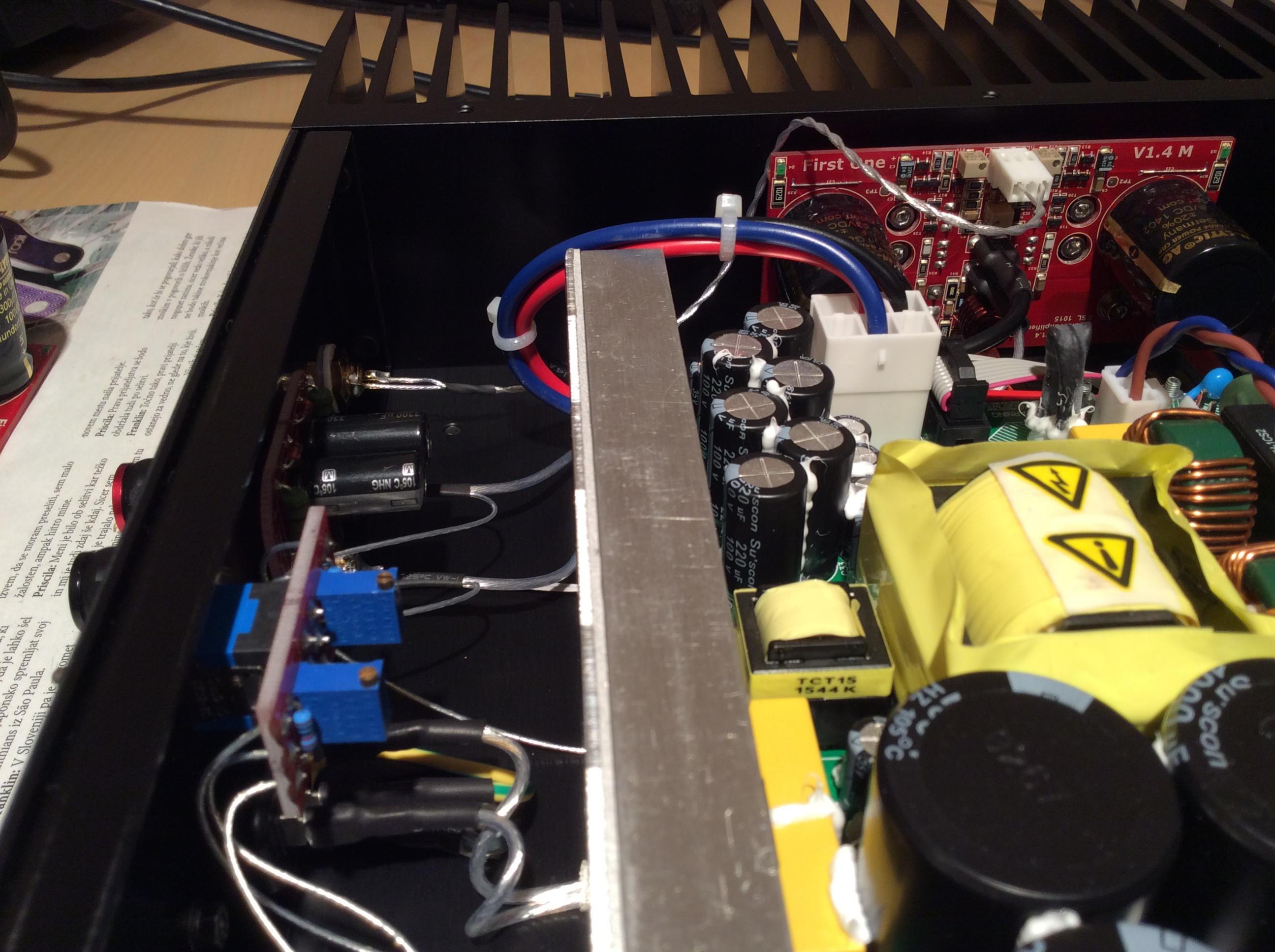

Looks nice! Is that switch on the back of the amp for Bridge mode?
Hi LC,
Very nice build. Would First One L fit in the same chassis?
Sent from my ONE A2003 using Tapatalk
Thanks. Indeed. 🙂

Fred, the switch on the back panel has three positions and it serves to set VU-meter's activity-range:Looks nice! Is that switch on the back of the amp for Bridge mode?
OFF, -10 dB, 0 dB

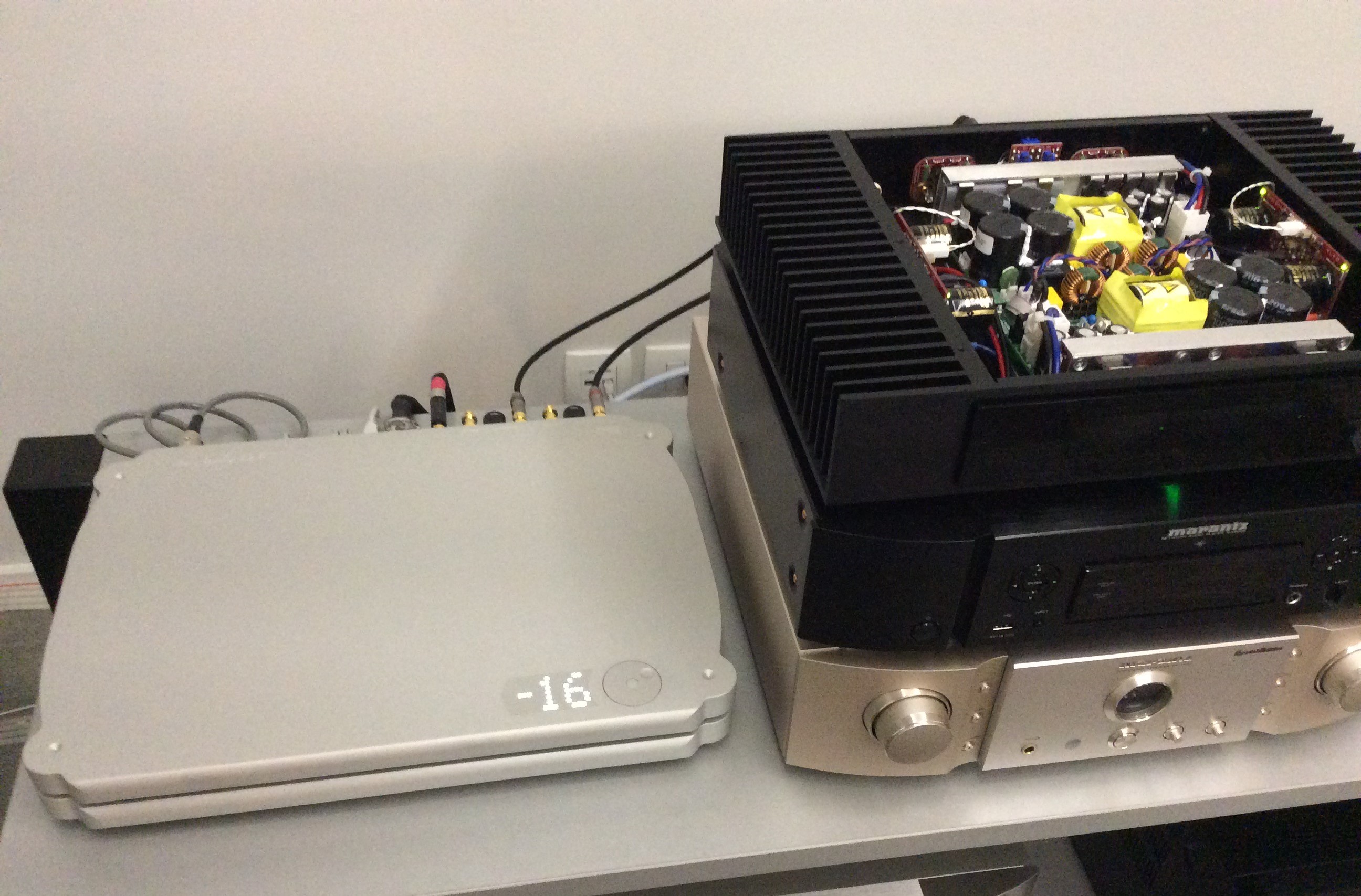

Andrej,
I've just checked VAS current biasing and I have about 280mV on one board and 250mV on the other and amp is on 24h/7d. It's a little higher than expected (180mV) but then again I think it wouldn't hurt much. I didn't check output transistor bias current but I feel it's a little warmer than previous V1.2 on the same power supplies(Hypex).
FO is directly coupled(no cap) to SEN I/U converter because I didn't finish preamp yet, so output DC is little bit off during first minute or two and then it's settles from 70 mV to about 10-20 mV.
Hi miksi
It is ideal to set VAS and output bias when amp is settled to operational temperature, since both of your readings are too high, please recalibrate and set them to recommended values. First One doesn't have DC servo meaning, going from cold start to operational conditions, output DC offset starts from -70 to +/-10 mV, that's completely normal behaviour. Heatsink's operational temperature should be 42-44 C, of course without input signal present.
Pleased with SQ of v1.4 compared to v1.2? Drives your speakers well?

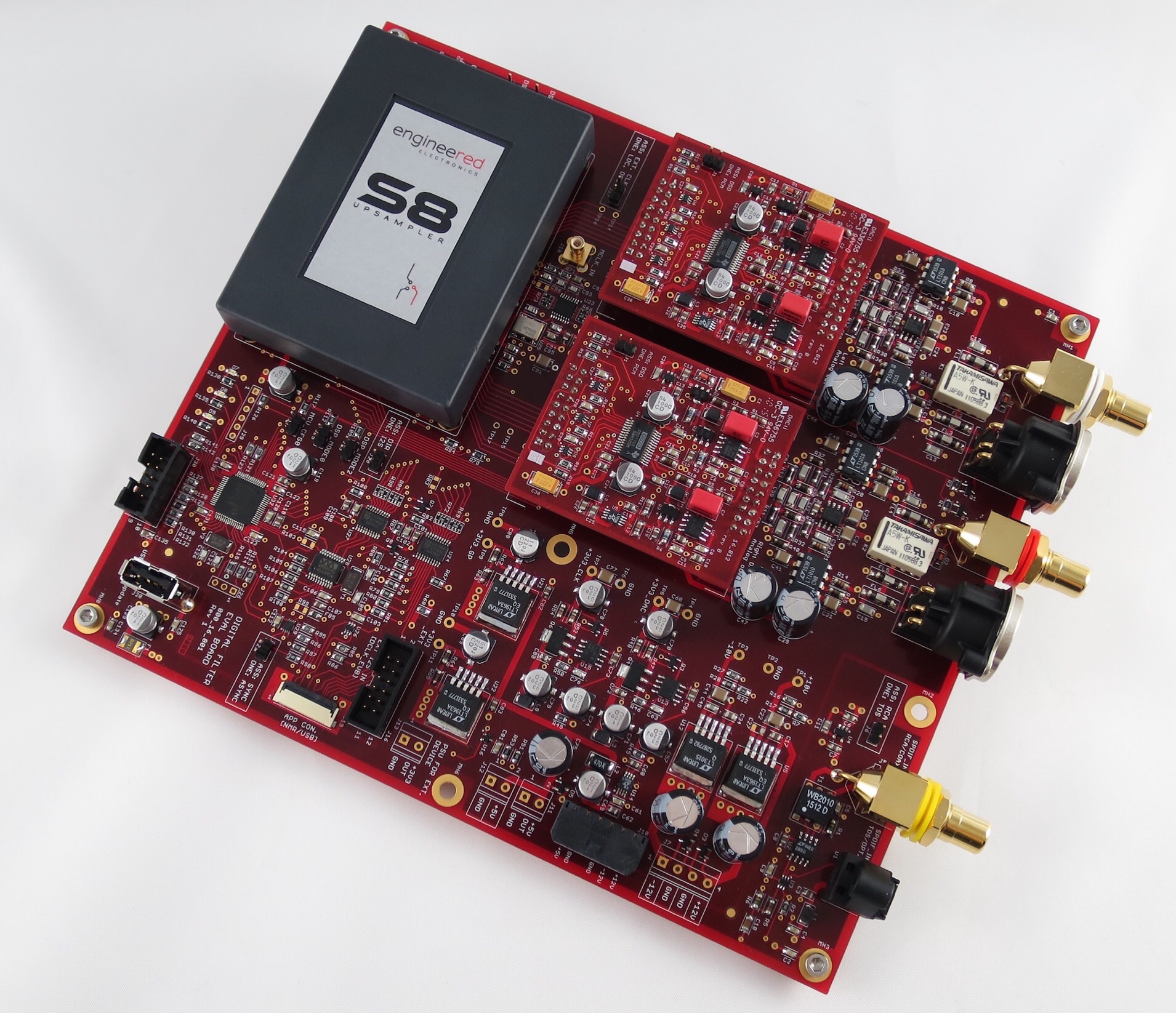

LC,
Is this your own DAC design? If yes, will it be something we can DIY or commercial product? Could you share a little details?
If not something you've made, what brand/model is it?
Do
Do
Analog DAC is MSB product, 384 kHz discrete Ladder DAC. This one on pic is the latest version, full option package with Network Renderer, Quad USB, analog input, volume control, separate PSU. I have it for FO testing purposes and it is by far best DAC I ever had.
Besides also having DAC on pic attached, but it still needs some upgrade work to be done to come even close to.
Analog DAC enabled me making FO L sounding even better than expected, every little tweak could be evaluated with ease. Very happy with the 'tools' available. 🙂
