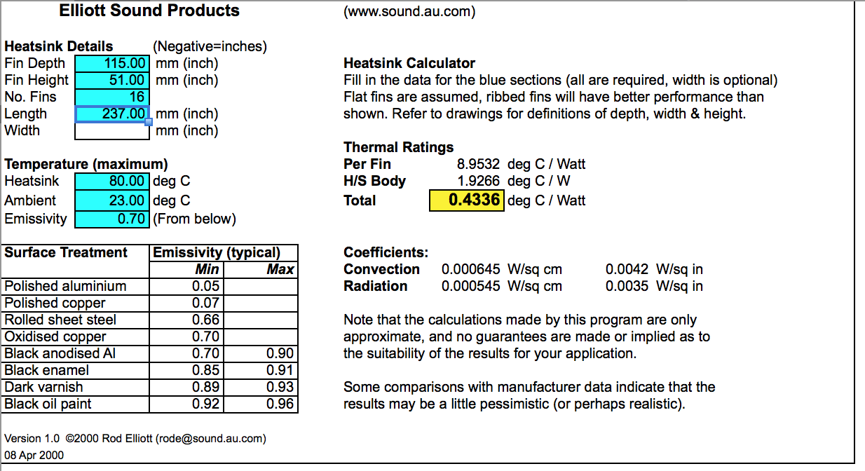

Hi guys
Just picked up a non-functional Hafler P225 (DH220 equivalent) and would like to repurpose it for a FirstOne M build. I can't find any details about the thermal resistance of the aluminum heatsinks online and am curious if you think it will work.
Here's an example of what the Hafler enclosure looks like:
Heatsink dimensions:
Depth - 237 mm
Height - 115 mm
Mounting plate thickness - 5mm
Fin size - 51mm x 2mm thick
The height appears to fall midway between a 2U (89mm) and 3U (133mm) chassis size. I plan on using a portable bandsaw to remove both of the existing mosfet mounting plates, to allow the FO modules to be mounted in the center of the heatsink.
Speakers are an 8 ohm load with most listening at a moderate level.
It certainly looks like it will work or at least be pretty darn close. Worst case scenario I suppose the bias can be lowered until everything is relocated to a proper enclosure.
Thanks for any insight you can offer on this. It's much appreciated.
-Sten
