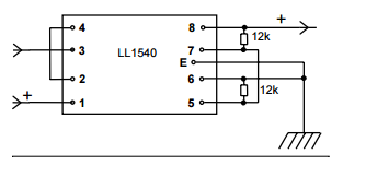

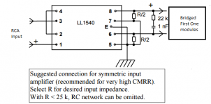

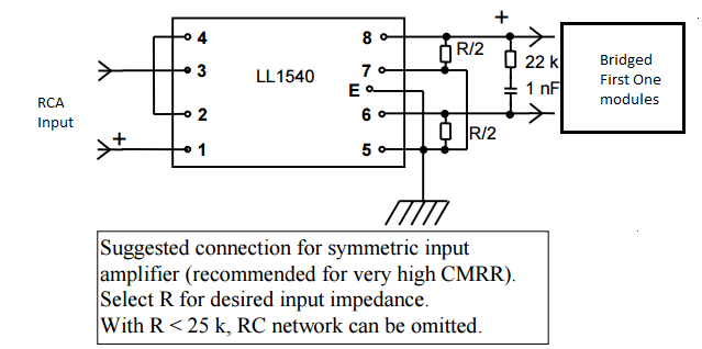

Hi, what should be the value of R for best SQ ?

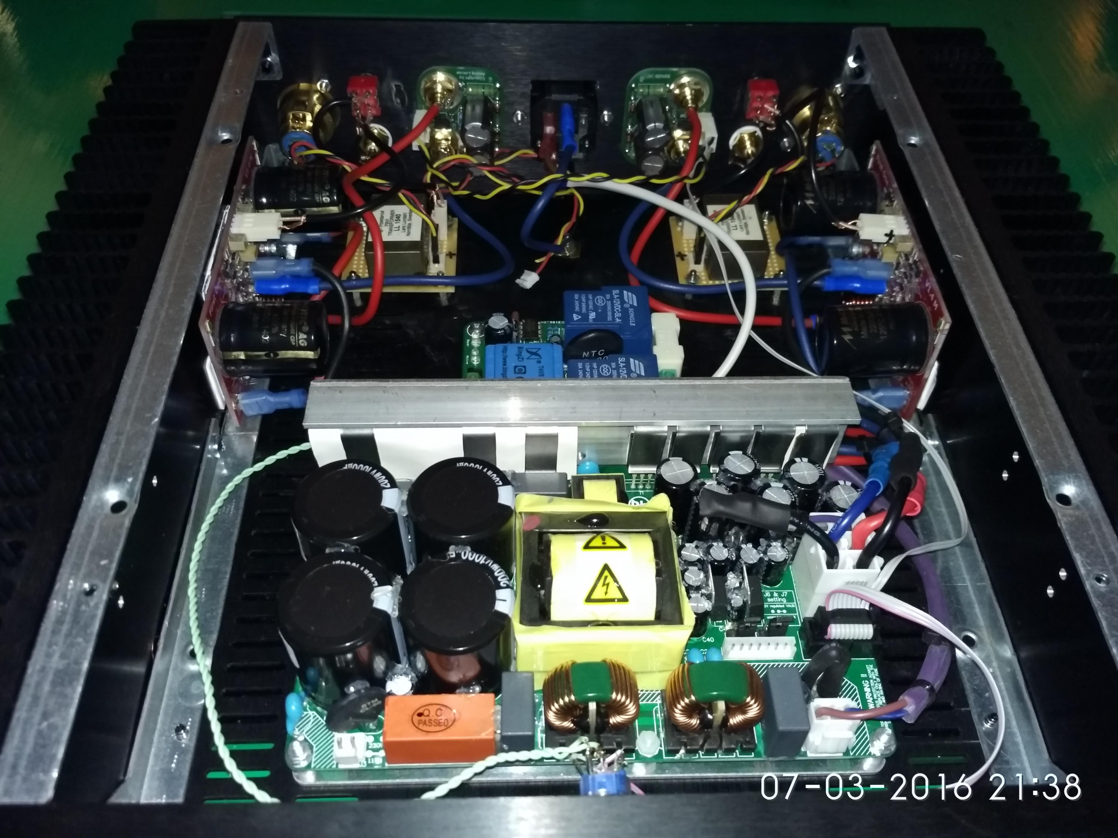

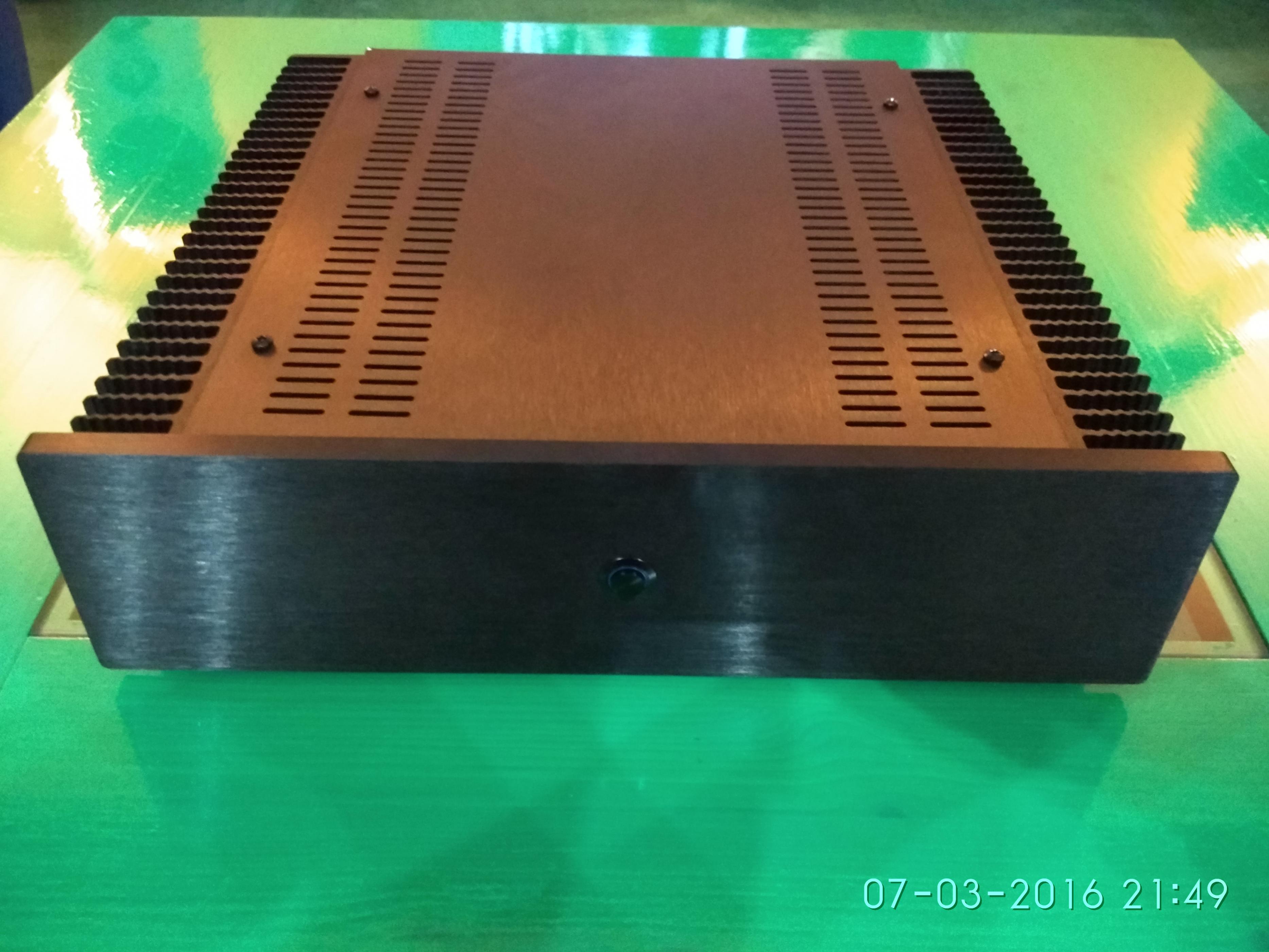

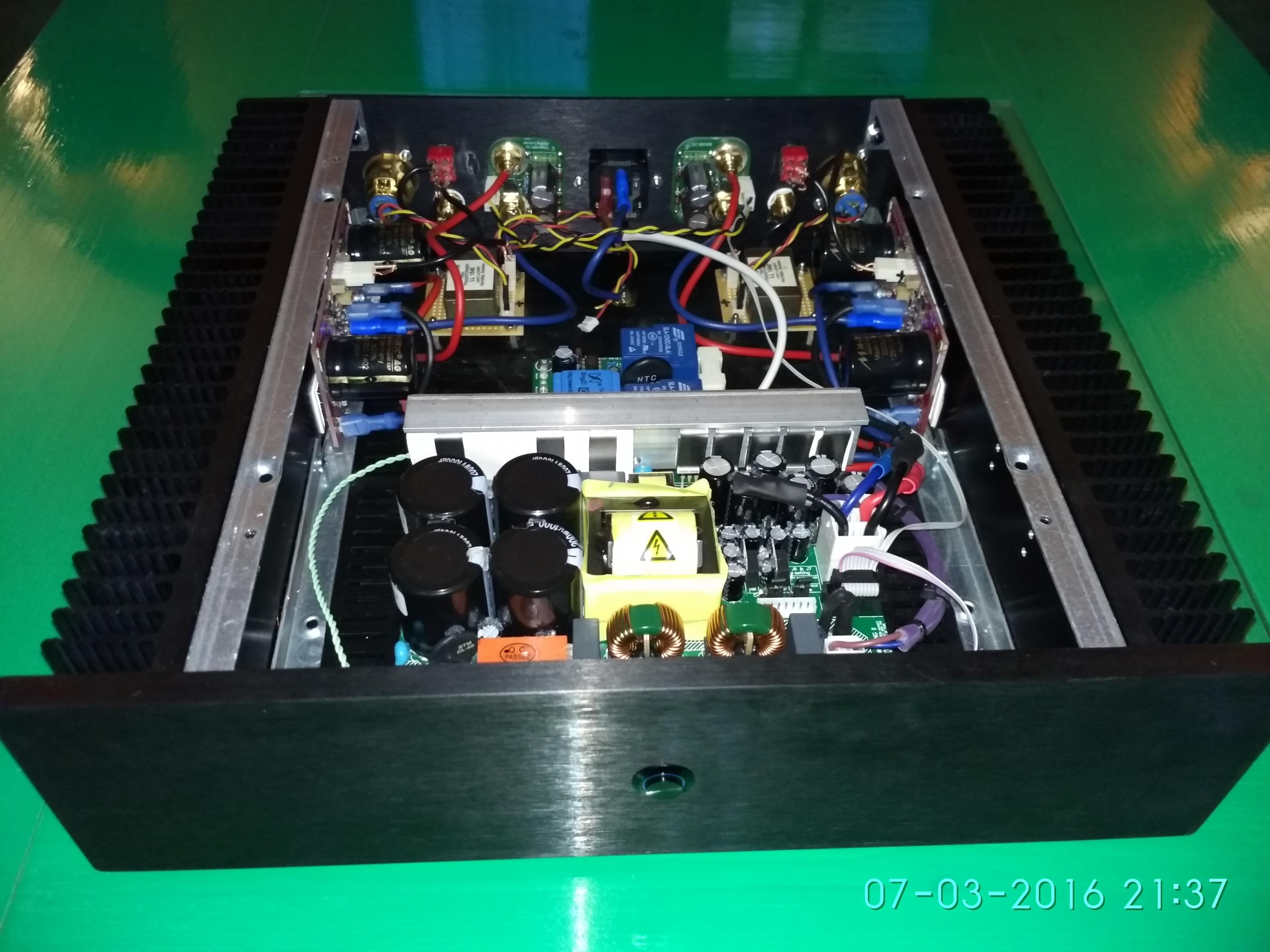

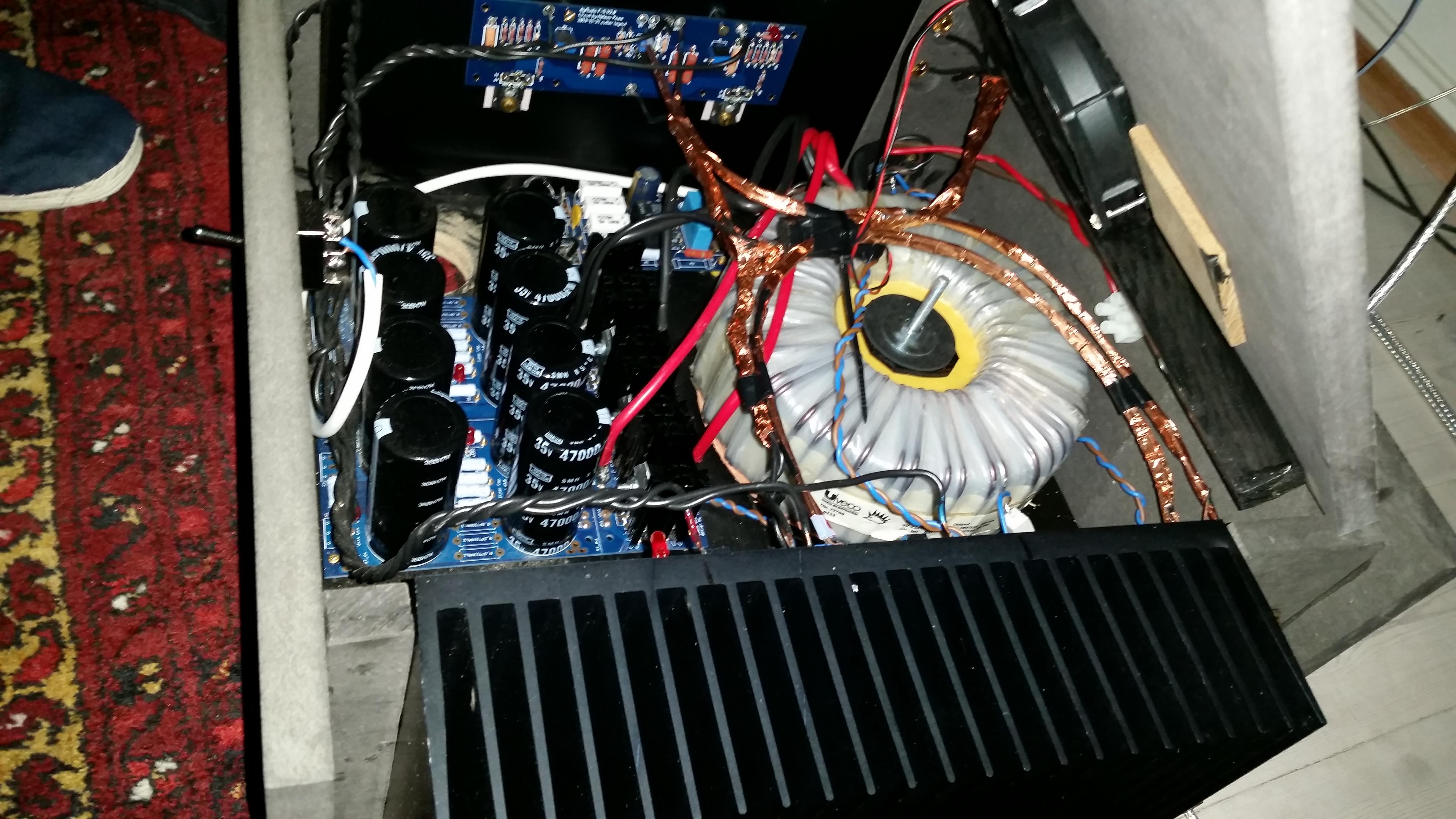

Today, the first time I listened to the amplifier I built based on the modules "first one amplifier". First impression: WOW !!! The class better than my another amplifier based on the modules UCD400HRX. Cool!!!
Hi maciekw
well done. I see you use a single hypex. This is fine only if you use differential input. Otherwise the cross talk is too bad, and the damping is very much reduced.
using a LL is a very good idea ! but I see you have a switch on the rear panel with potentially a direct connection for the RCA plug to the FO : just avoid that and put your RCA on the primary winding of the LL, as the XLR !.
if you want to be convinced, just put a single tone sine on one chanel, and mesure the output on the second chanel, you ll be amaized, (I ve got a 40db crosstalk on mine!). The FO is designed for dual supply, if you use only one supply then you must accomodate some tricks to keep this amp to the level it deserves.
also as you have transformer I would suggest to invert one chanel and connect the loudspeker of this chanel with the reverse polarity (which will then restore the correct phase) and then you balance the power consumption on the 2 rails, especially for the lows which usually are mono.
then you will get a wonderfull FO
cheers
Hi maciekw
Good idea, thank you.
I forgot to mention that to mesure the crosstalk I was refering to above, you have to put a dumy load (4..8 ohm) on the chanel 1. Because in fact this all about the current going back in the ground wire and then impacting the 0V reference of the second chanel. even if you wire the RCA 0V together, a resistance still exist and exhibit a voltage accross it. Easier to understand with a simulation or a measurement of course 🙂
