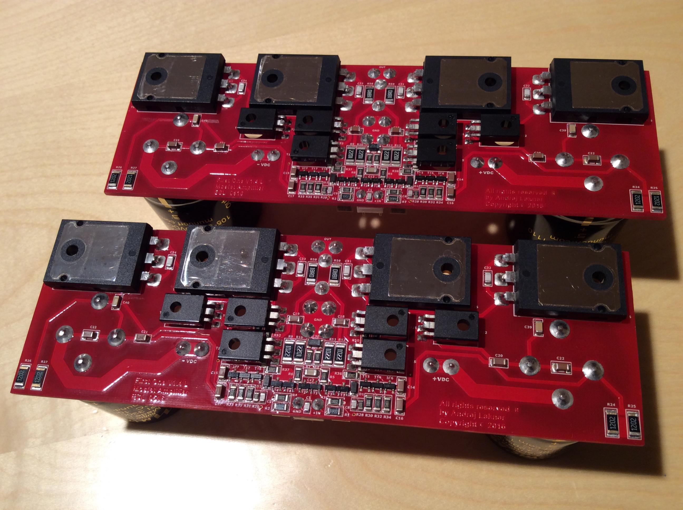

It is posible that bass can be improved. LC just sent me these pics of the new freshly baked L modules where the output transistors are in paralell.
Since they are prototypes there are yet to be installed. Probably till the end of week. Then we shall hear the product (hopefully the LC's ban will be lifted by then).

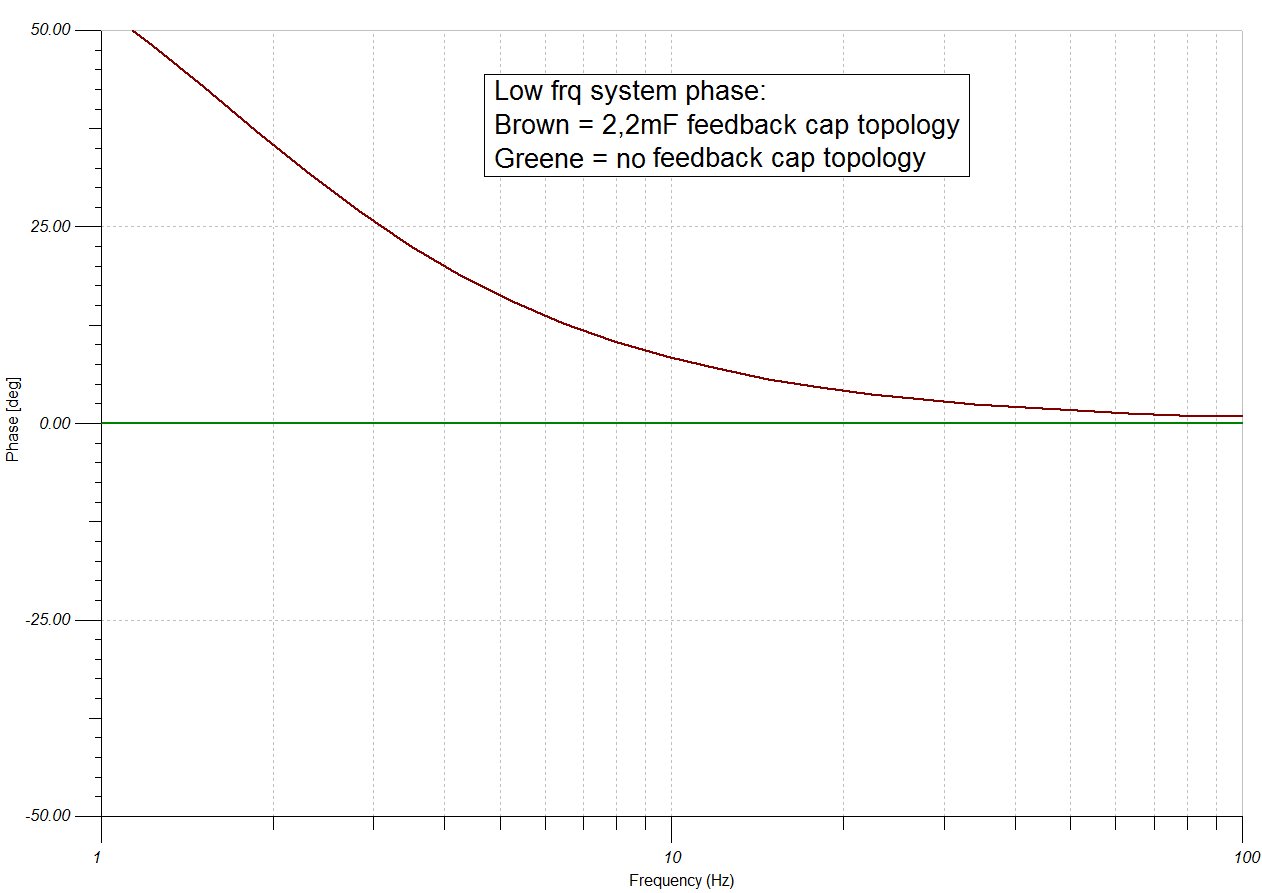

Not sure how related it is for sound stream but all versions prior to v1.4 including VSSA had feedback cap topology, with no feedback cap beside better linear amplitude response from down DC and up bass speed will also improve.

I am not sure about what you mean?
Your statement that one pair is not sufficient, that is my conclusion too.
Thank you very much for posting.
It seems the height of the modules is respected. Can you post the dimensions?
