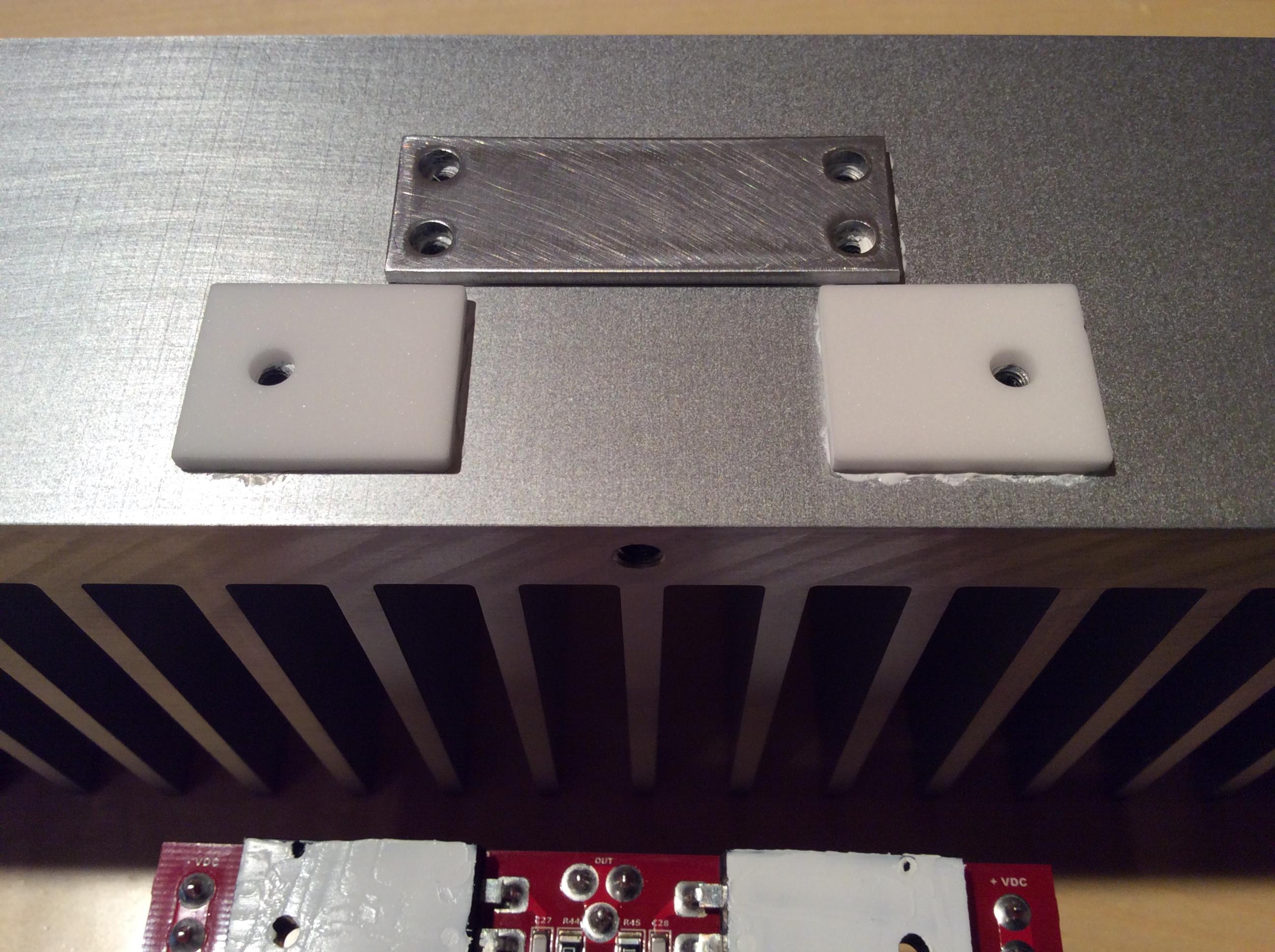

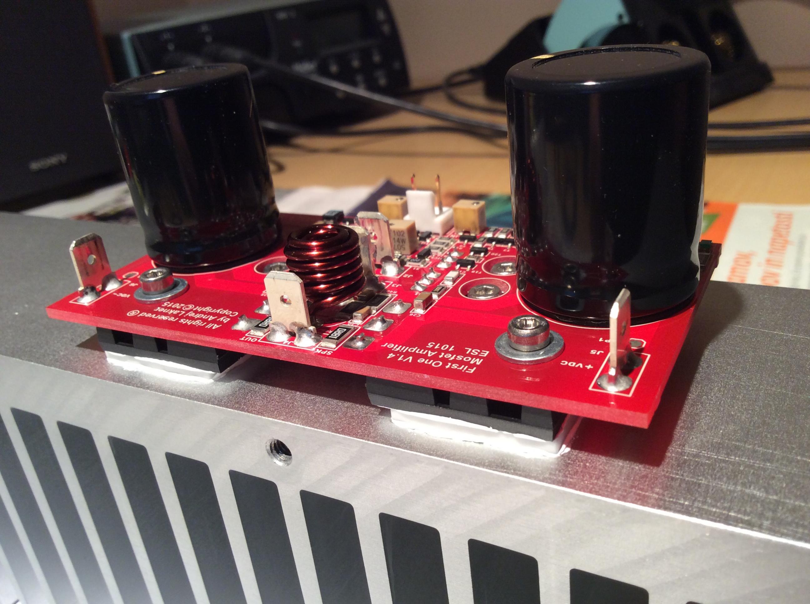

AAVID Thermalloy for First One v1.4
Another v1.4 upgrade takes place today, customer requested Naim's approach with 2 mm Al-Oxide thermalloy insulators. Now 2 mm extra distance means serious drop of capacitance to chassis. We'll hear the results over the weekend. 🙂
Offers started today, expect an e-mail. 😉

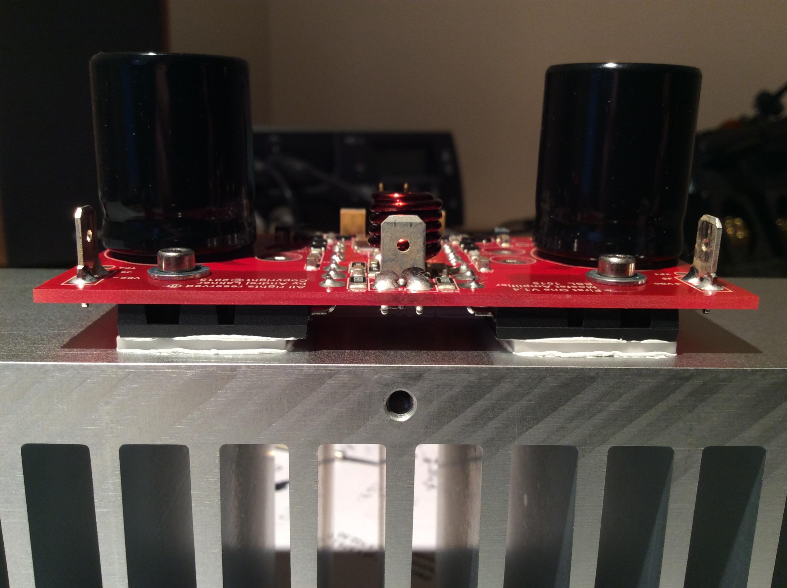

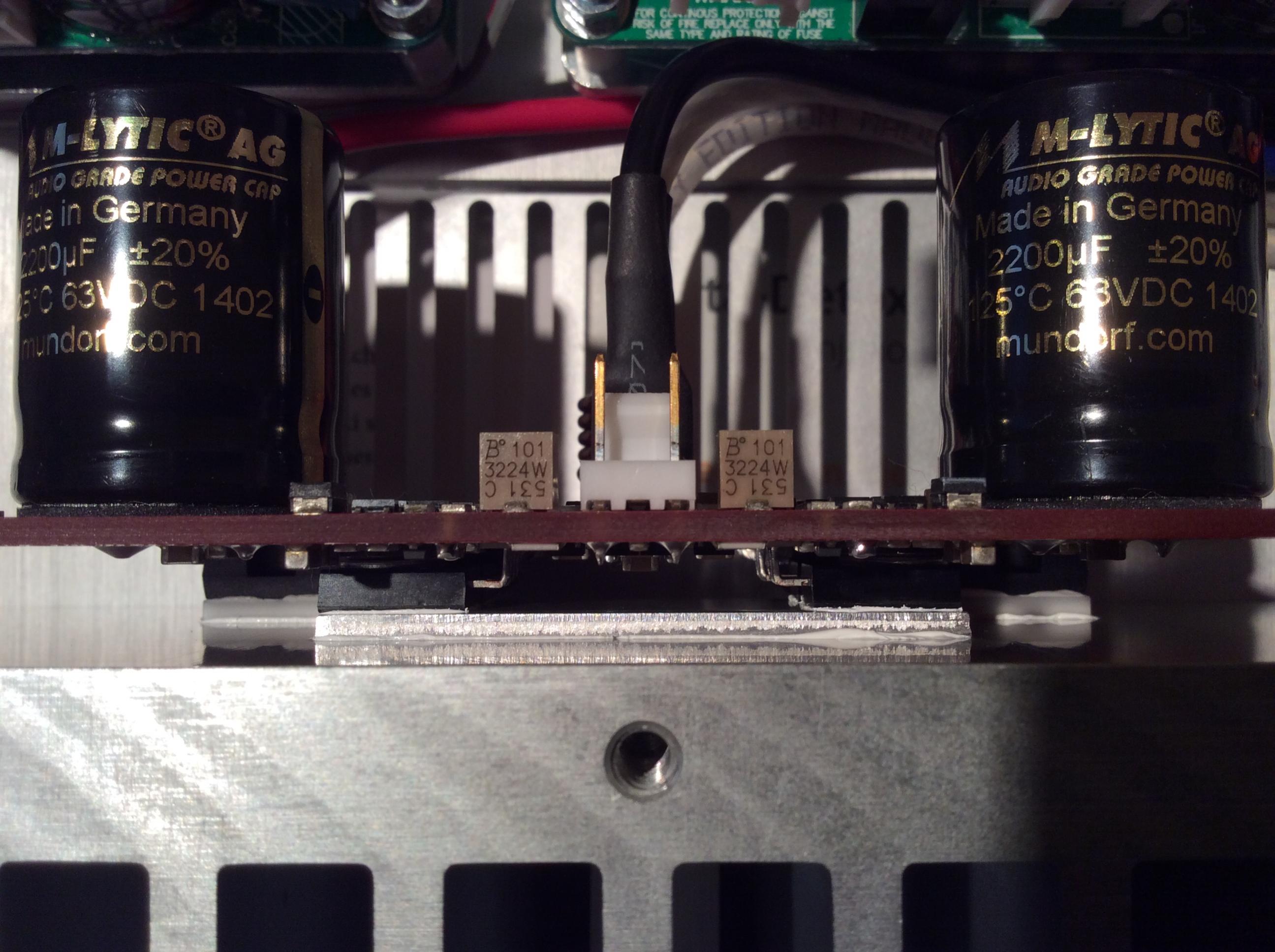

We'll taste the difference first, if any, and report back. Indeed insulators 2,5 mm shorter than the mosfet case but the width is perfectly aligned, also metal plate is covered in full, so no significant thermal transfer reduction expected.
There were always M3 fixation bolts used with First One modules, also as many times highlighted v1.4 is direct replacement for v1.2, same dimensions in full.

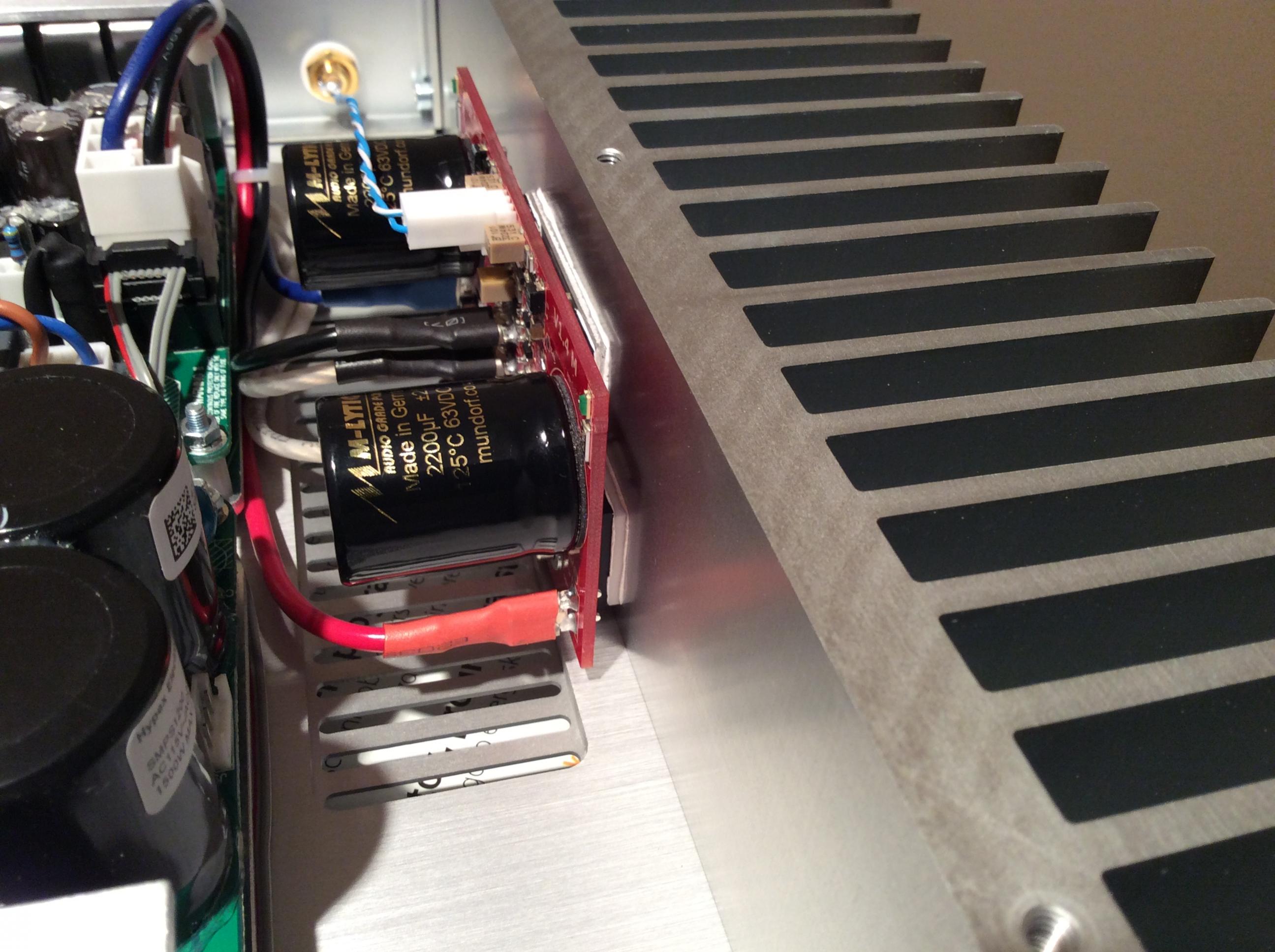

Heatsinks and the rest of the chassis were not grounded even before, only RF decoupling, otherwise complete galvanic isolation from chassis to module. The chassis is of course mandatory earthed, otherwise GND lift was always in use with my First One amps.
In this case, using 2 mm ceramic insulators, output to chassis capacitance droped to less than 1/20th which is noticable in extreme hight's details, with remark on extreme, probably not revealed in all systems. Heat transfer is good, according to specs even better than a thin mica, which is remarkingly surprising to me, in practice amp shows no output's overheating or strange bias behaviour. Definitely highly recommended to use.
I suppose your Heatsinks are mechanically screwed to the chassis, so connected in common ground with the chassi's ground, no ?
All parts of the chassis are on the same potential and that is earth potential - mandatory for metal chassis. GND from both SMPS-s are in complete isolation from chassis - GND lift in use, as known from PA. This gives best sonic results and the amp's channels acts as real dual mono as they were in separate chassis.
