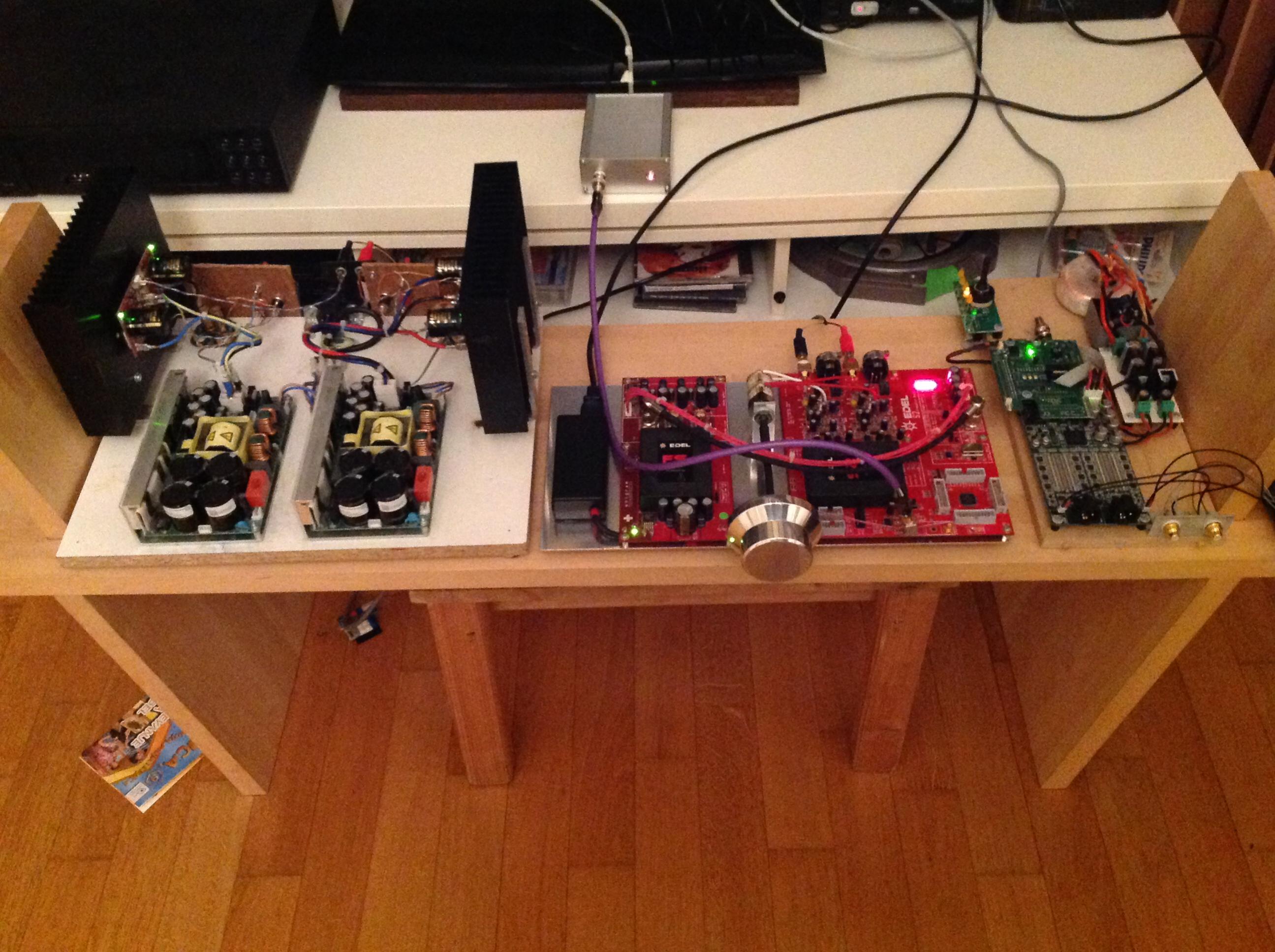

FO final rev 1.4 test
Yesterday I finally heard FO1.4 at home.
We used anagram sonic2 and soekris r2r dac v1 as a source. Sonic2 is heavilly modded by lc. Soekris is as originally proposed, regulated power supply only. No extra mods.
The amp is really good now. It plays music in a more relaxed way, is more forgiving to a weaker source, but still preserves the little things I enjoy in the music.
Soekris has really down to earth presentation, the notes are naturally presented, lack of soundstage is obvious. When thing are complex the quiter sounds get masked by louder sounds.
Anagram still stays as a reference, bettering Soekris in all parameters.
