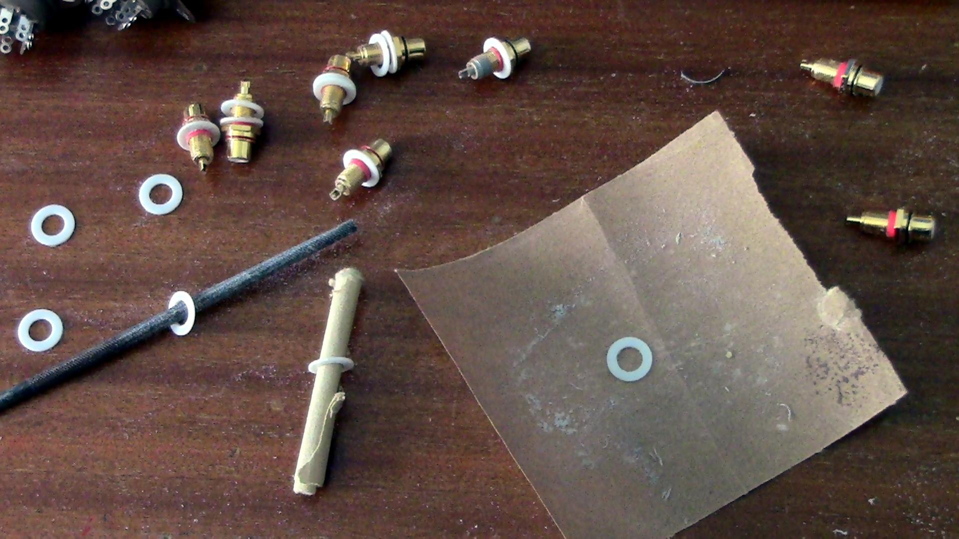

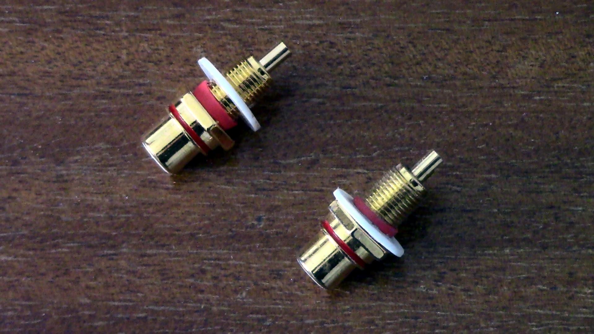

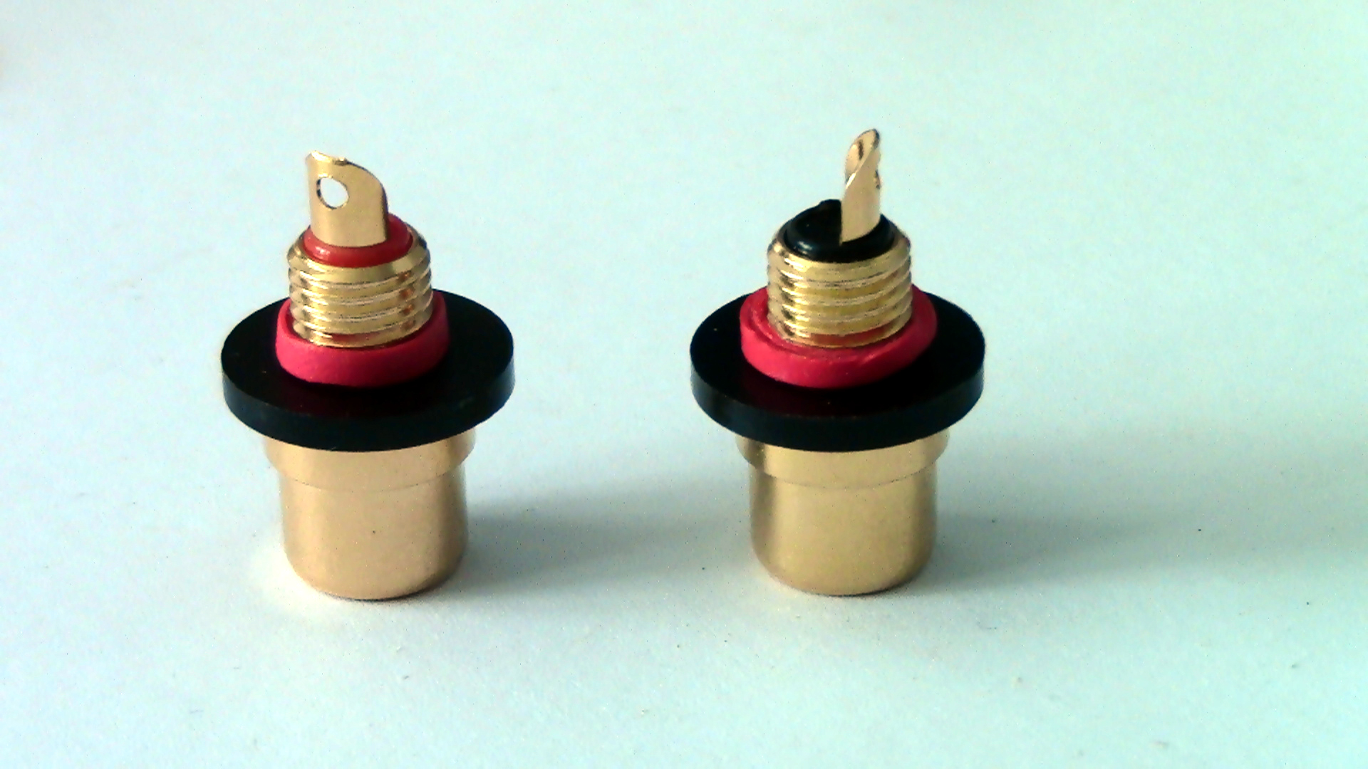

Hardware induced Hum
I am sure most of You have figured this out already, but I am sharing this, because I have overlooked this a couple of times. :eek: Most RCA Jacks and Binding Posts have pads that mostly insulates the part from the faces of a metal earthed chassis. But these pads do not insulate the shaft itself - the part penetrating thru the hole in the chassis wall. If the part is perfectly centered in a larger hole, no problem, air is a great insulator. But, what has happened to me, is the part moves when tightening - so the shaft ends up touching the chassis; therefore connecting the signal ground to the earth ground and causing a hum. :eek: I solved this problem by covering the shaft with wire shrink wrap cut to the thickness of the chassis wall. Of course, I had to enlarge the holes on the insulation pads also, but this worked, no more hum. :)
I wish manufactures took this into consideration when they manufacture their parts, but then again, they do not know the thickness of an end users chassis walls either. ;)
I hope this helps
Allen
