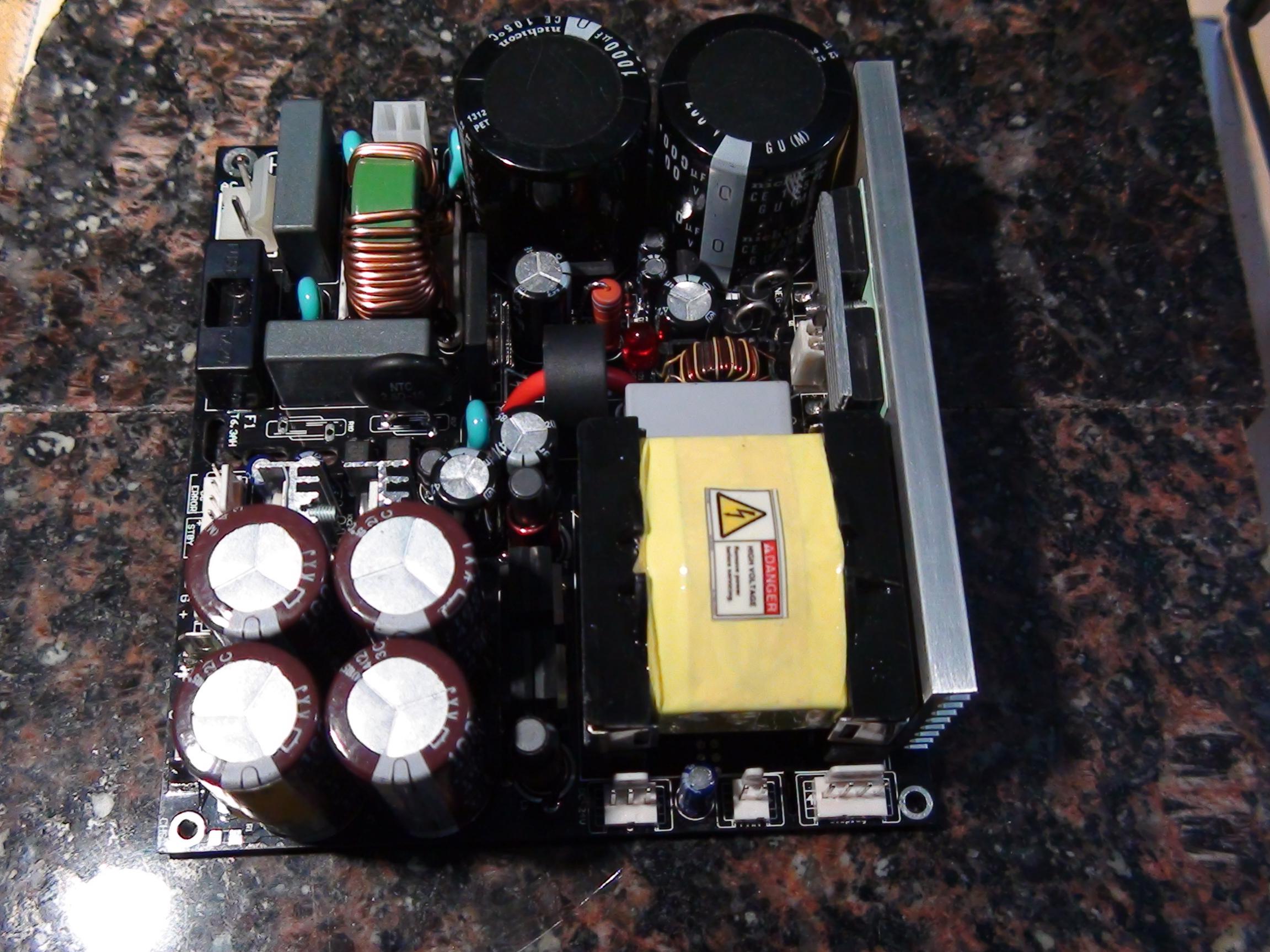

@PAX1
Currently I have this 600W version
1- * Shutdown input (needs to short that input to activate the function) .
2- * Standby input, needs to apply 5VDC to that input in order to keep the SMPS into sleep mode.
3- * 12VDC FAN Output
4- * +-15VDC Regulated output
5- * +-24VDC Unregulated output
* Display output, so you can put power and the fault LEDs to front panel of your amplifier, if you wish
Regards

As read in other thread, SMPSs NOT using synchronous rectifierare are better (sounds better) for class AB amplifiers. And it seems you are offering such SMPSs. But the voltage (above) is not convenient for the FO amp, so do you plan to make a more convenient SMPS for FO? (Voltage +- 50-63 V)
Those voltages you see are the aux voltages to spice something else like pre amp etc.You just have to say which output voltage you need.
Cresnet,am I right?
I am sorry, forgot to mention those are the standard voltages, in ADDITION to the main one, witch is anywhere from +-40VDC to +-100VDC.
+-40
+-47
+-53
+-61
+-70
+-90
Regards

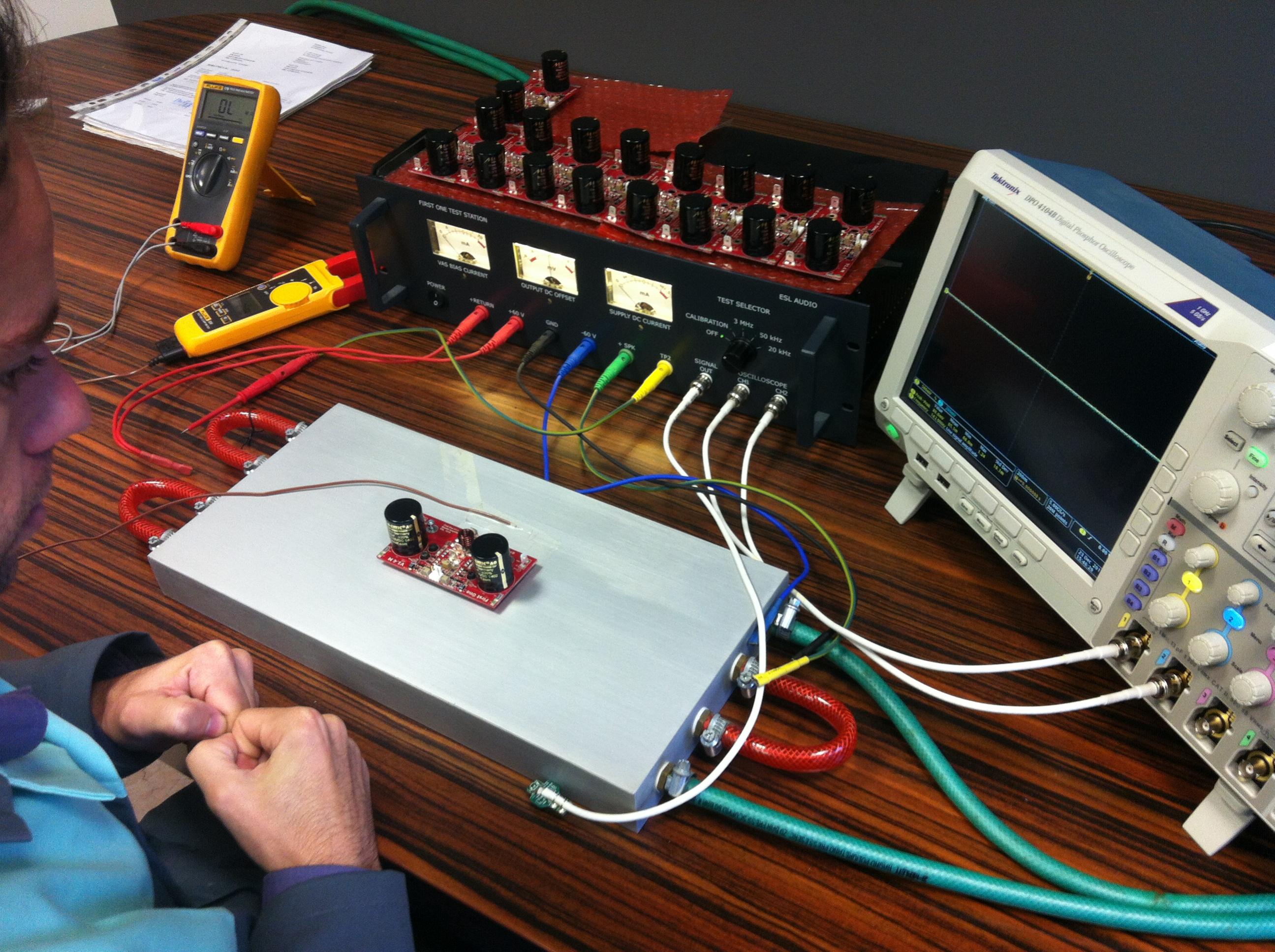

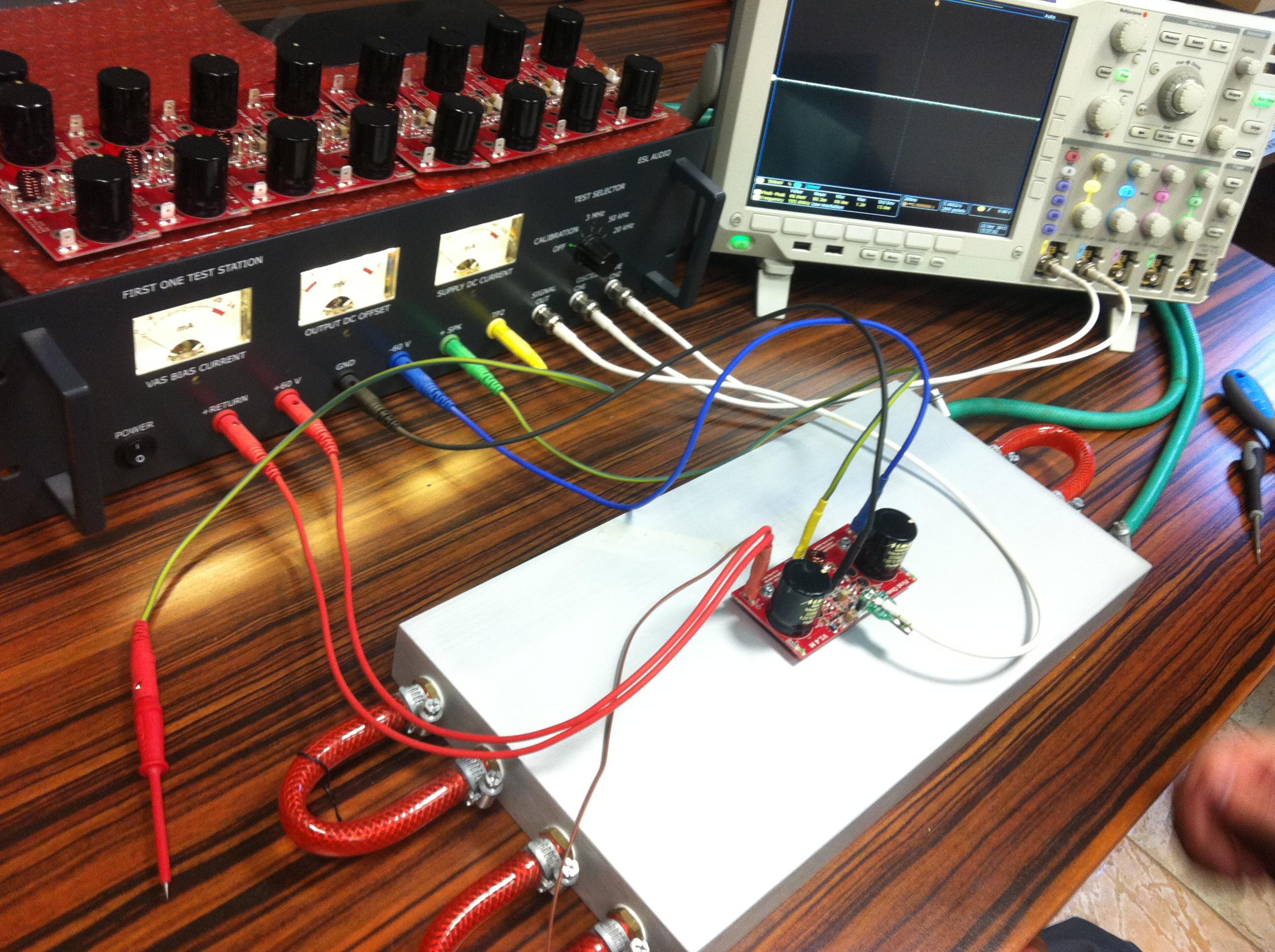

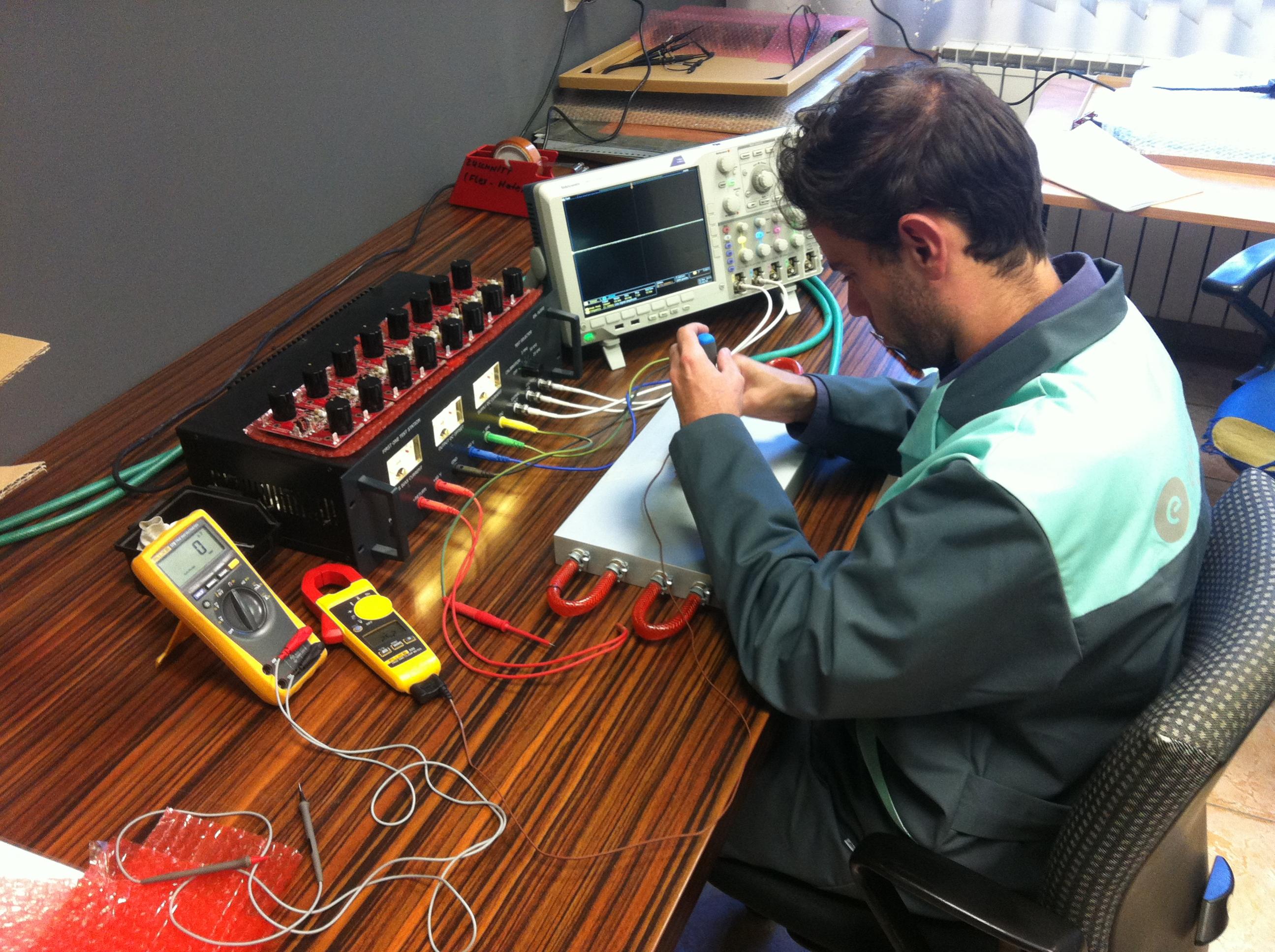

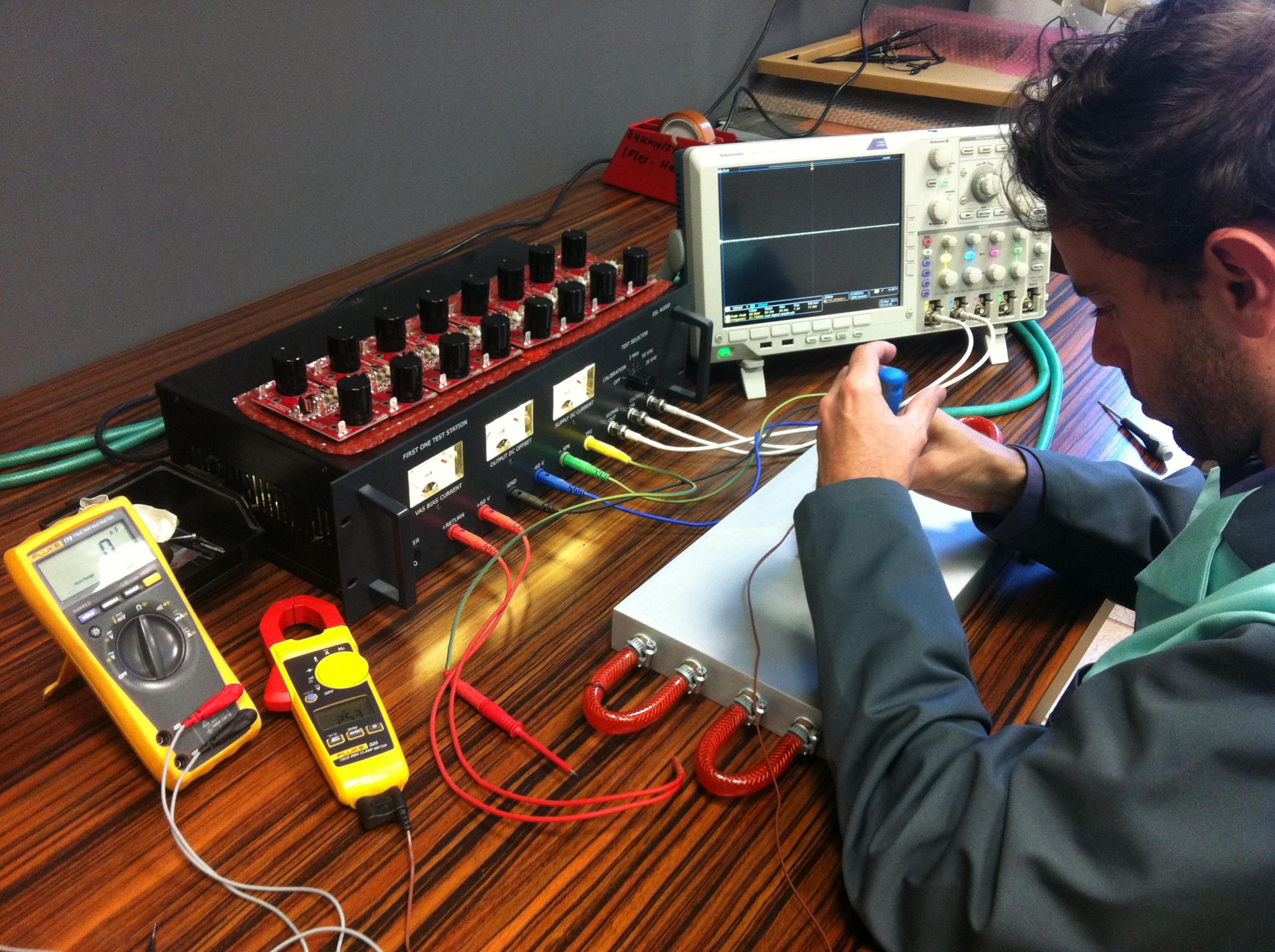

First One v1.4 calibrations in progress
Hi Guys
First batch of 12 pcs. send out to the ones already have FO (local and abroad users) in chassis to perform upgrades. Next week we'll start with regular deliveries to all new orders. Some calibrations pics attached.
L.C.
Hi Guys
L.C.
