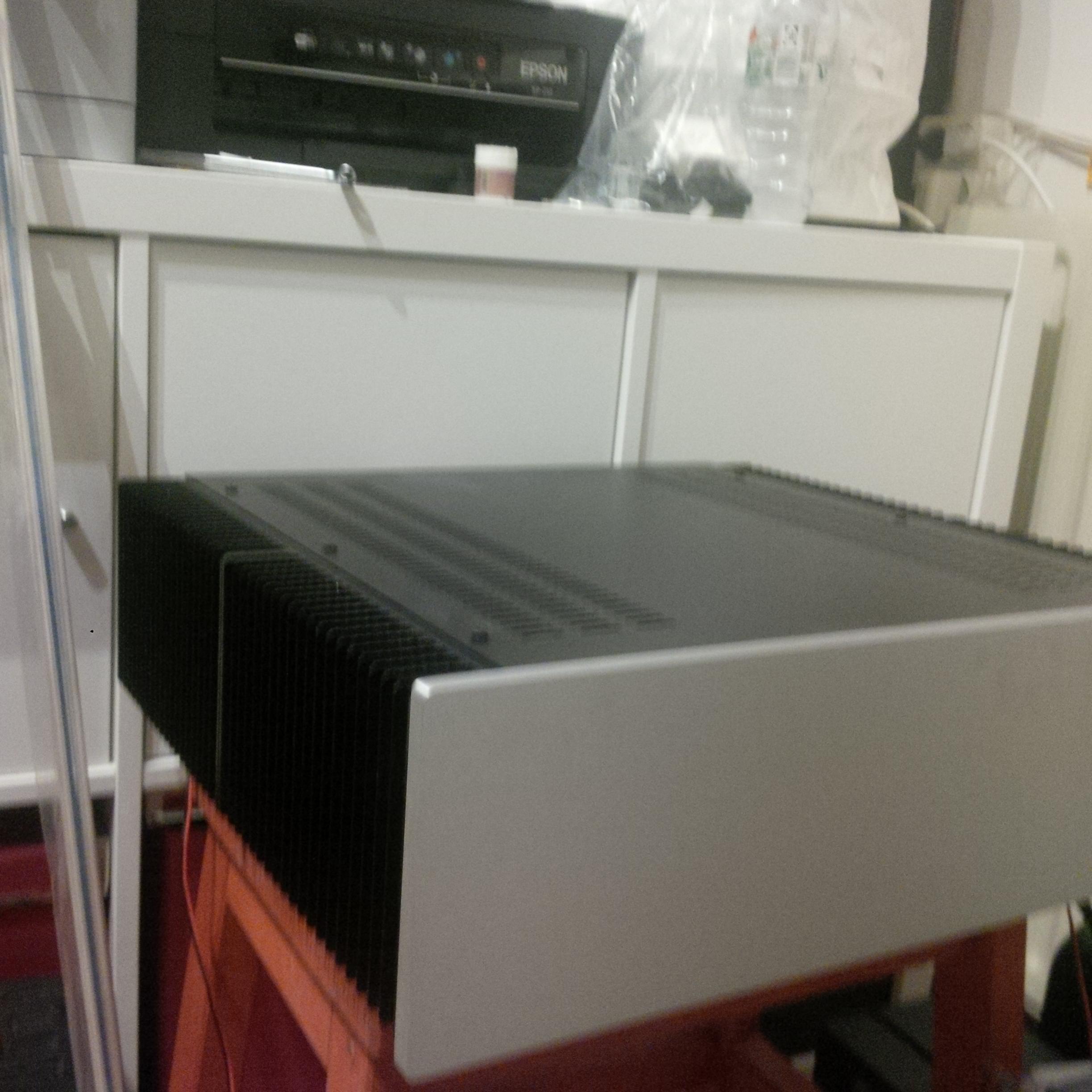

First One v 1.2
I know I am a bit late, but I just finished my First One v 1.2.
Anything I can do to upgrade to a more recent version? probably just Andrej can help me do that.

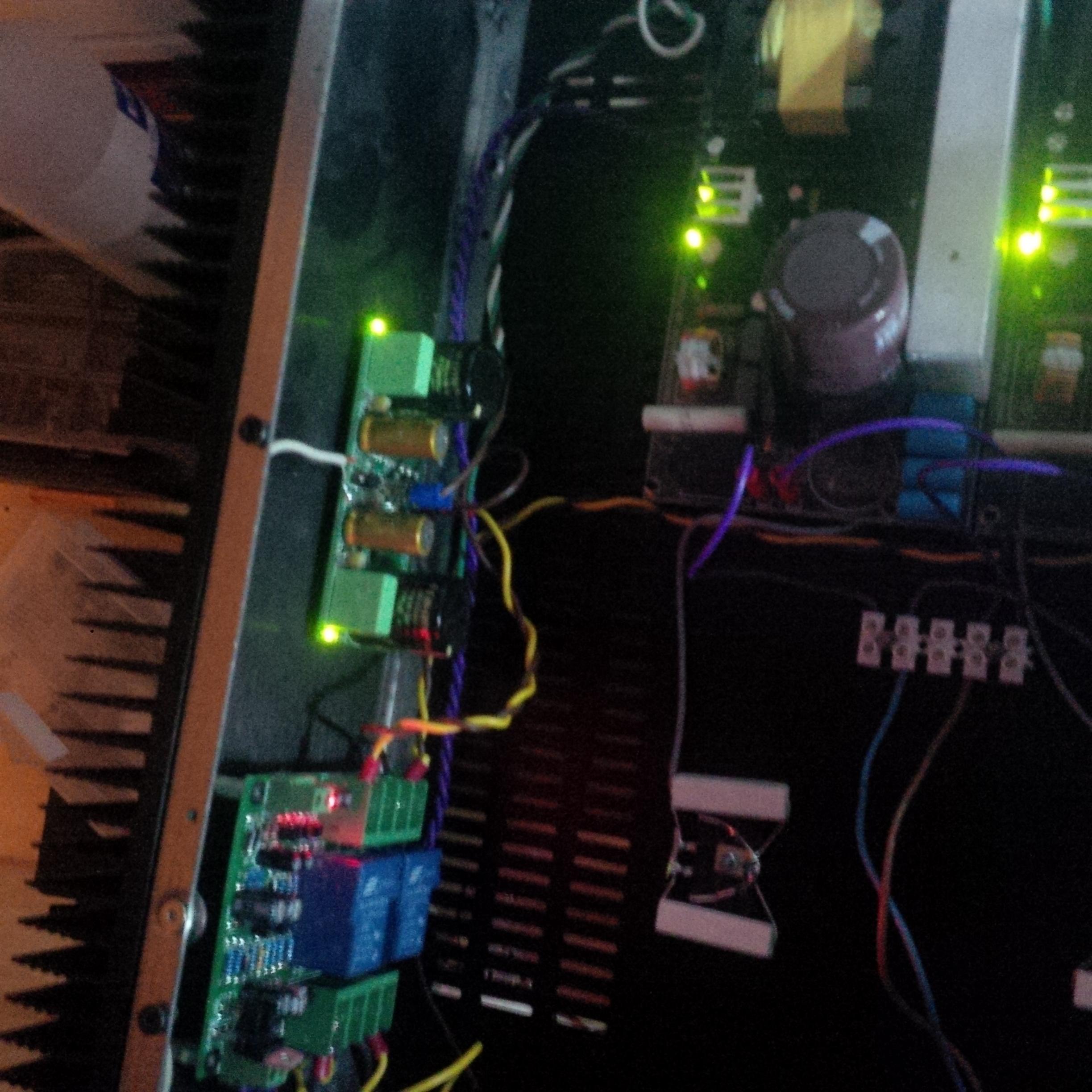

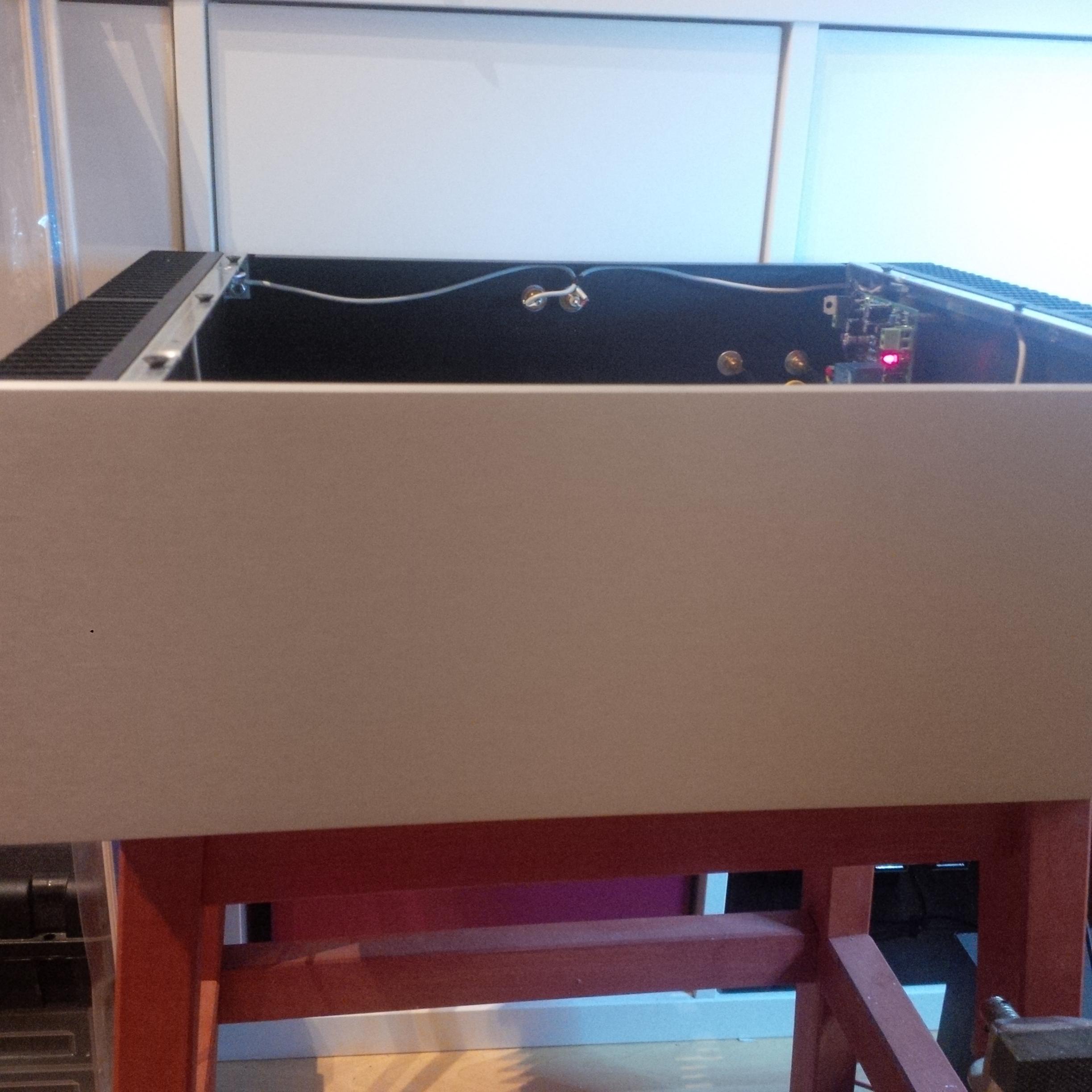

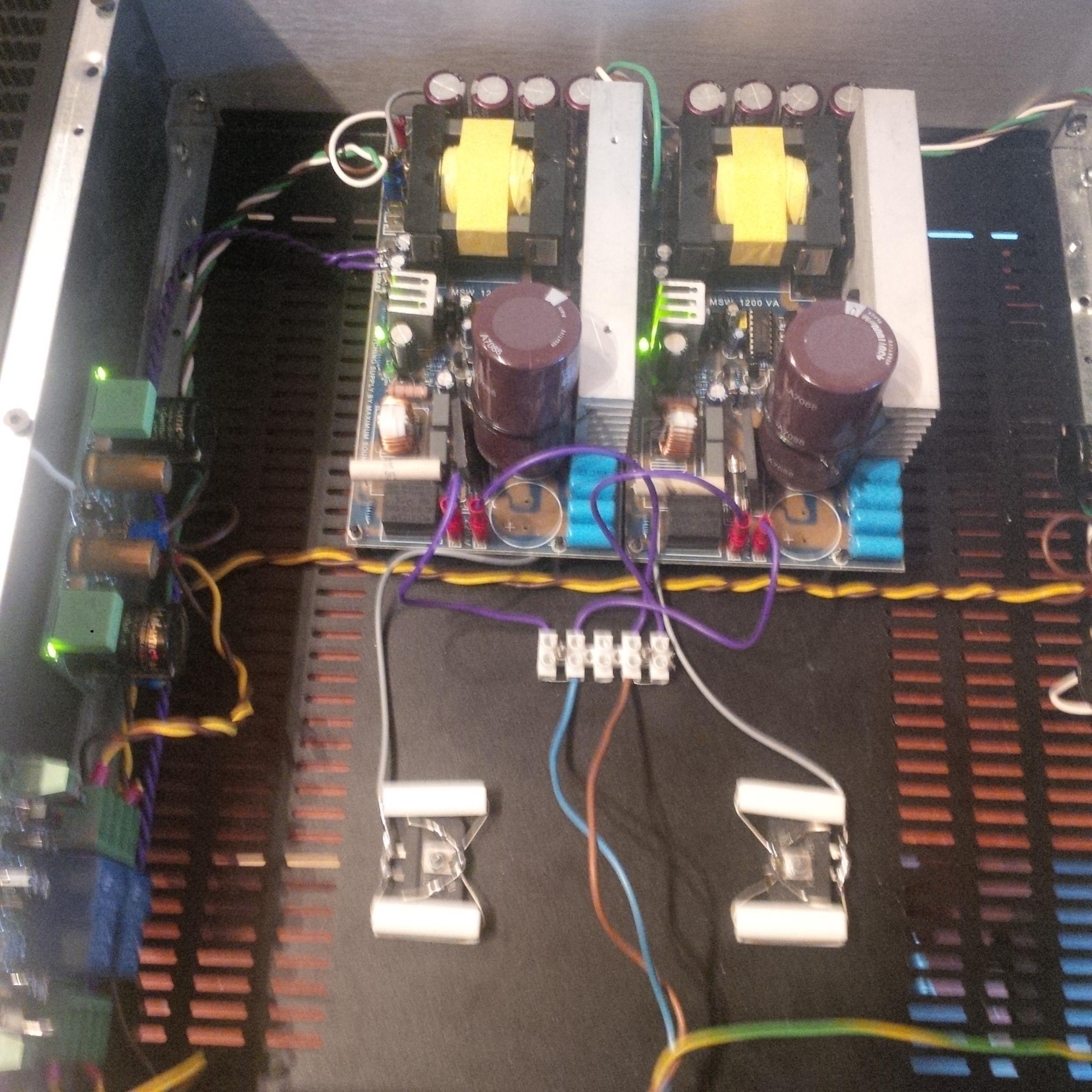

Anyway, here I attach some photos from my build.
I used some power supplies from eBay (eBay article number 121478378676), without regulation, and they are doing a wonderful job. With 230V input they deliver 2x55V DC, 1200W each. They have a relay that shorts a slow turn on power resistor after charging of the main reservoir cap. I have increased the value of the cap from 2x220uF to 1000uF/450V.
The sound is excellent, with even more bass than my XVSSA (which is still a reference to me). I wonder what can be improved over this 😀 The destination loudspeakers will be Monitor Audio Bronze BX5.

First off, I know most people are using two Hypex SMPS600 for the PSU. I know earlier in this thread it was discussed that one Hypex SMPS1200A400 could be used for a stereo pair of amp modules with the side effect of the F1 modules creating a little more heat. Was there ever a sound comparison made between the two?
Also, if I get the Standard 4U Amplifier Chassis from the diyAudio store, how many v.4 modules can I fit in there? (I am assuming at least 4.)
Thanks for your tolerance and patience if these questions are repeats. 😱
Allen
The best result you'll get as dual mono with two SMPS1200A400, one per channel.
I suppose you could install 4 FO modules, just be aware that one FO module sinks 280 mA at idle, so the idle power dissipation has to be calculated and taken into account at specific chassis thermal capability.
