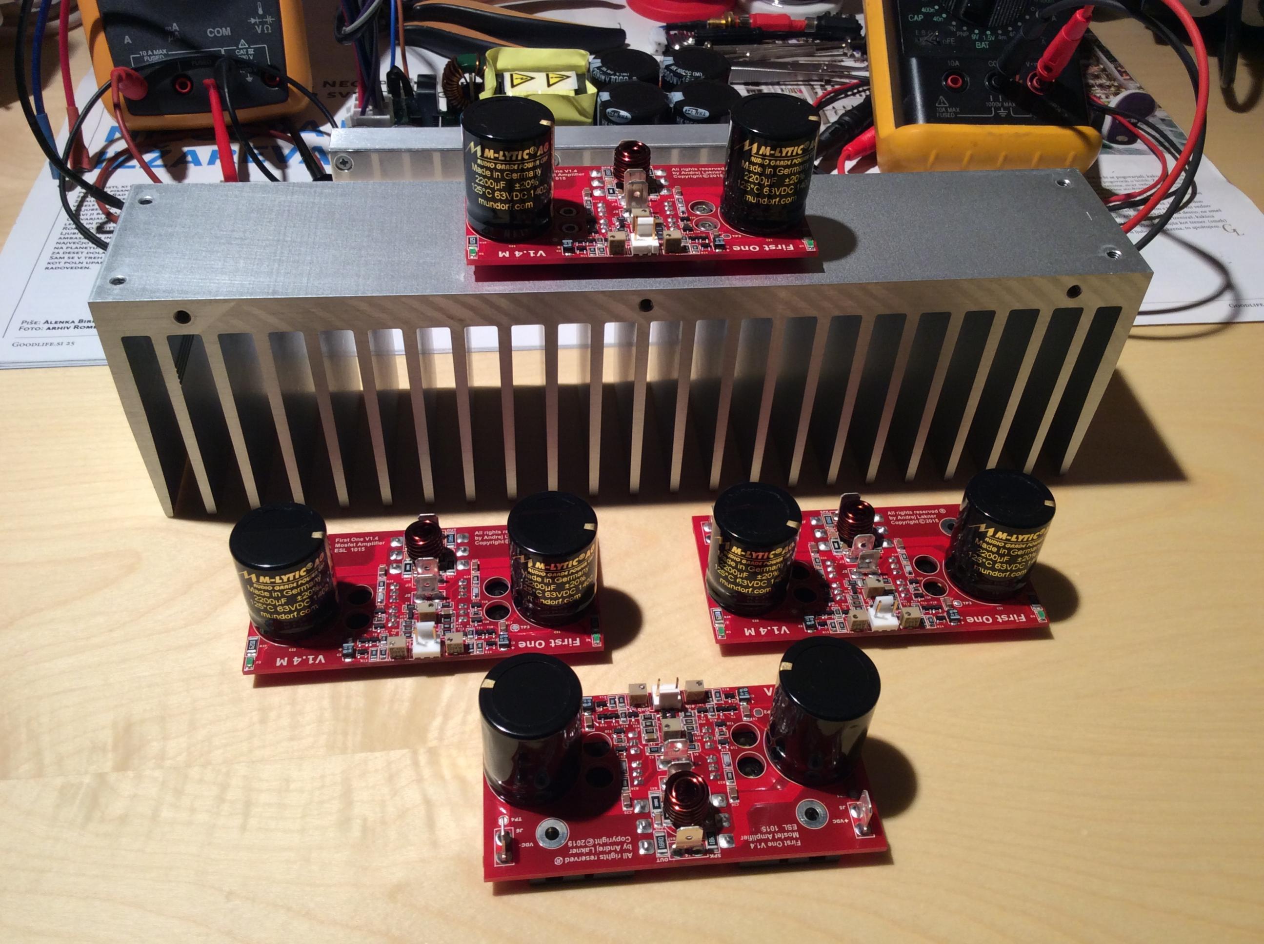

These are the last four modules from test series prepared to be send out.
Almost there to accept the orders, if everything as planned, this week we'll start the production, last reels expected to be received shortly and then automated assembly line will be ready to start the step motors.
Please give me few more days as I don't want to get payments before material is ready.
