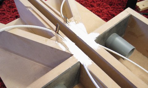

Looks good. The cross braces will help support the stuffing.
At the danger of entering into elderly relatives sucking eggs territory, I'll mention that at this stage I usually wire the enclosure, giving the opportunity to thoroughly caulk the cables to a corner to prevent any buzzes. This design lends itself to fitting terminals to the base of the main enclosure.

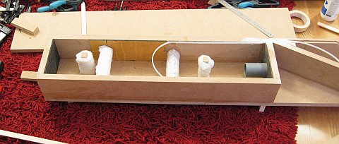

I assume there will be a massive baseplate and the cavity will be filled with something inert, such as sterilized sand, kitty litter, or similar. Also, apparently not much stuffing is required so I suggest wrapping the braces.

I was thinking about wrapping the braces but I desided not to do it for some reason. I'm glad that you recommended it.

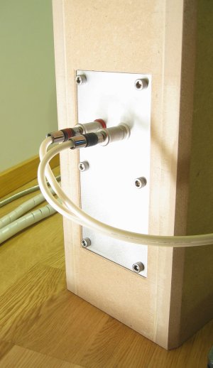

I haven't desided yet what to do with the bottom. I will place the binding posts there and possibly the passive network. The hard part is the sand that is required. I will probably divide the bottom to two sections and fill the other one with sand blast sand which I find excellent and cheap for this kind of applications.

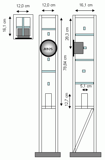

A 'typical' reflex with a high aspect ratio isn't a BR, but technically a ML-TL. IOW, a BR assumes a ~uniform particle density whereas the ML-TL has one dimension long enough for 1/4WL action to contribute to the vent's action, reducing its length for a given cross sectional area (CSA) while increasing its damping somewhat.

The "labyrinth" type design just folds up the pipe to make it more compact (but not smaller). The Jordan design is somewhat confusing because the drawing respresents 2 or 3 different boxes.

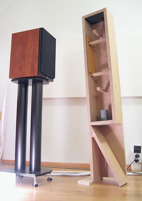

After building Gm MLTL as in the picture ,I stuffed bottom about
10 Kg sand so the speaker got twice as heavy as original; I noticed low-end separation much better , but the midband become litllebit cloudy, and very highs started to Peak??
Have anyone some advise/explanation on this??? Thanks!
