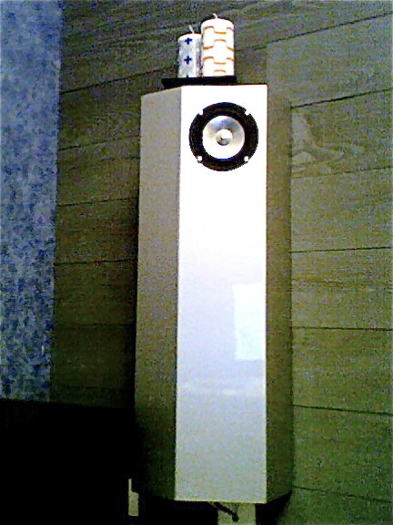

JX92s + BSC and supertweeter
A year ago I built the jX92s GM 31 MLTLs which I mixed with Jimmy Griffin specs in terms of baffle size and the addition the Aurum Cantus G2si with Mr Griffin Crossover (which rolls over at 3000 Htz).
While I was happy with the above, I felt that the life and soul of the jordans were somewhere hidden behind. I do not why this happened. Maybe it is because although I used reasonable good caps (clarity ps) I combined them with cheap inductors and resistors.
Anyway, after lots of trials I believe I have found what works best for my ears/my room and my system: I am running the Jordan's full range with the original BSC configuration suggested by Mr Griffin (1.5ml inductor and 4 ohms resistors) but I am running the 2GSi as super tweeters just above the Jordan's high frequency limit (ie 21500 Hertz) with a first order crossover using a cheap 1.23 Uf radio shack capacitors in parallel. The super tweeter idea wasn't mine, I took it from here: http://www.vanzylaudio.com/6_Steps_to_Faster_Sound.html .
This way I feel the Jordan's keep their main characteristics and coherence while the top and bottom get a nice kick that results in a very balanced system.
I just have question for those who know more:
Which type/brand of inductors and resistors would you recommend for the BSC and which type of of capacitors for the super tweeter xover. Are better components critical in this case?
Many thanks for your answers/comments.
Antonio
