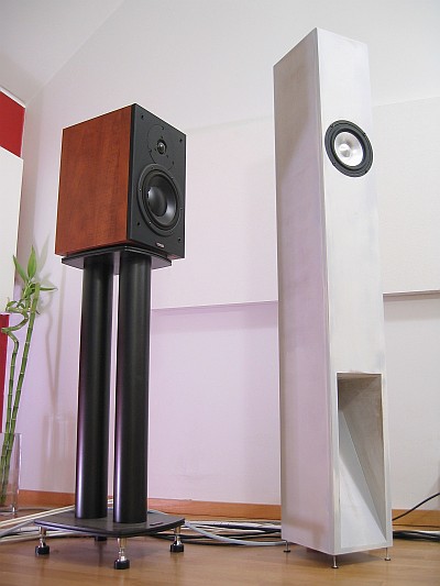

How it will affect to the sound if I will do 30cm(external) wide ML-TL cabinet instead of 22.25cm wide cabinet. I will keep the area of the bottom and top as same than GM's design. (9.84" x 3", internal)
Earlier in this thread, Bruce posts details of the taller (48") MLTL, which he built with a triangular cross-section. For this one, he used a much wider front panel (about 11"), so less depth. As long as the cross-sectio remains the same, a wider MLTL should be okay. (Jordan recommends the shallower, wider enclosure for a number of reasons - the shape is more akin to an 'infinite' baffle for the driver and the reduced depth means that only higher frequencies are reflected into the back of the driver, which are easier to absorb. The traingular cross-section also addresses this last point.)

Colin said:the reduced depth means that only higher frequencies are reflected into the back of the driver, which are easier to absorb.
Low freequencies are still going to reflect -- the time smear will just be less because they didn't have to go so far before they pass back thru the cone (the Jordan cone is likely fairly opaque). HF are easier to absorb, but with less distance, you also have less distance to absorb them in, so they can be more of a problem than with a deeper box.
All-in-all the triangle is a good solution. Pretty too.

I finally finished my version of GM ML-TL. Earlier I had a VTL which is presented on Jordan webpage so I know what JX92S is capable of. I decided to do 30cm wide GM ML-TL. Depth is only ~8cm. Shape is very similar to VTL, except the driver positioning.
Now I have listened to GM ML-TL for two days I did not need to burn in JX92S's, since they are already about 2 years old.
Sound is pretty similar to VTL, but bass reproduction is tighter. I had to adjust the amount of stuffing two times. Now light stuffing is placed only on the back wall behind of the driver and upwards.
Upper bass region sounds little bit colder compared to VTL. I remember when I listened to VTL for the first time two years ago, I heard some coloration in the bass reproduction and I must have got used to it. Now after two years I built GM ML-TL and coloration is disappeared...
Biggest difference is in the bass region-> GM ML-TL performs better. 😉 I am surprised how detailed, clean and deep bass this 4 inch driver can produce.
In my opinion baffle step correction is not needed.
As you know, this is a great speaker! Thanks GM!
