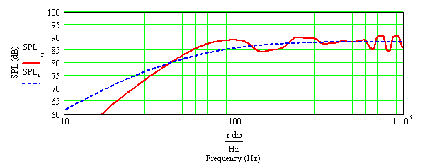

Just for the fun of it, I modeled the TL that's on the Jordan web site. I don't know if I got everything exactly right. (Someone else want to try it?)
Here's the SPL graph. Sure enough, the bass response and ripple are not nearly as nice as the ML TL design.

I don't recommend reducing the CSA much, if any. If you want more pipe loading, ergo a lower Fb, then maintain the same CSA and try longer lengths. The optimum driver position will shift upwards some and the vent length will shorten.
FWIW, this came up in another thread and I calc'd a max practical length of 48" using the same CSA, density, vent diameter, but with driver down ~15.46"/2.75" vent length. AFAIK, no one's built it so as always YMMV, though I see no reason why it won't perform as predicted.
