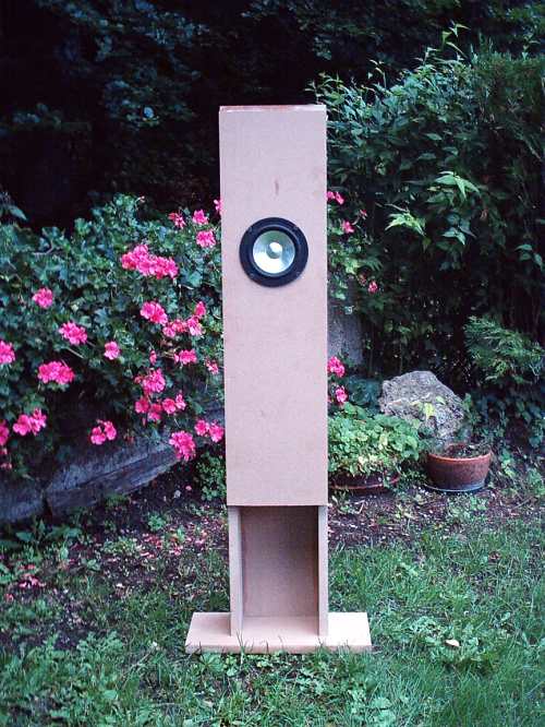

Sooo, I'm waiting on the Jx92's and decided to build the cabinets. (I have the time now, won't have the time when they arrive.) They are per the original GM specs except that right now the ports are about 6" long so I can cut them to tune. I made the cabs a little taller than abpea's original, boosting the height of the lower chamber to get to my desired listening height. I also cut the lower "bend" of that chamber to 45 deg so it's only in the bottom 1/2. So, that external chamber is 7" wide, 12" high (internal) with a 45 deg bend in the bottom, oh, 4".
I'm finishing them and as I'm sanding the finish, I get a real resonance in that area! Did I just build some kind of back-loaded horn at the port exit? 😱

I plan on building these speakers too
. The sound seems to be top notch and I really like the enclosure shape. 😀

Damping the MLTL
DIAR,
Here's some good advice I got from GM on stuffing/damping this MLTL:
GM said:
"I usually just cover one wall, top, and back of a ML-TL with 1" acoustic rated fiberglass or 1/2" felt and rarely needed to adjust it. When the driver/vent is at ~the right point along its length and the vent is of reasonable dia/length, it's just not much of an issue.
Unfortunately, the Jordan has such a small Vas that the vent is on the large side for the pipe's Vb, so some experimentation may be required. The sim indicates ~0.5lb/ft^3 stuffing density if polyfil is used, so if the FG is used, then it would be ~0.35lbs/ft^3."
Hope this helps -
Bruce

My first impressions!
whoa😀 😀 😀 😀 😀
Just finished the speakers on Monday. Brought them in & set them up... after a couple of hours breaking in, they are amazing. My brother-in-law and I sat down and went through about 20 different CD's ("let's see how this sounds!").
I've got a bit of a tin ear & am a speaker noob, but I can tell you that the clarity of these things is amazing. We heard things in songs that we'd never heard before. And the percussion - No, you don't feel it (hey, it's a 4" speaker after all!) but it made me jump. I can now tell the difference between the different drums! And vocals - sweet, especially female.
I re-burned the bro-in-law's Dave Matthews CD to compensate for BSC (3dB) and he sat in front of the speakers with a grin and started pointing - "There's Dave" - "There's the drum set" - "There's the rhythm guitar".
After we'd listened for about 3 hours, the spouse came home.
First reaction - What do we need more speakers for? Don't we have enough already?
After 5 minutes of listening to the Dixie Chicks - Hey, these are pretty good. 😀 😀
After 15 minutes of listening, pointing to my first diy speakers, vifa TC18 TL's - We don't need these anymore, let's give them to my brother
And I don't even have the BSC in yet!

can you tell us more about that?
abpea said:
But hold on!! GM's back at work and has developed another variation on his original ML-TL he thinks will be the best yet !!!!!![]()
I'm going to try to put a pair together this weekend and give a listen. Stay tuned!!!
