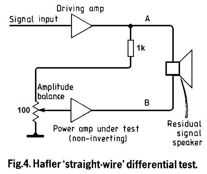

A colleague approached me and thanked me for bringing up the topic of vector distortion measurements using the Baksandall and Hafler methods.
Since Hafler's method is the simplest and does not require anything other than an oscilloscope, he decided to test his amplifier using a 1 kHz square wave signal.

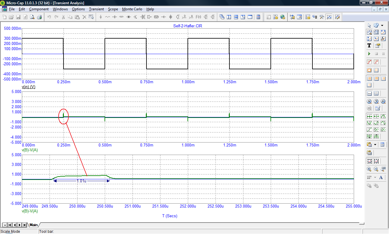

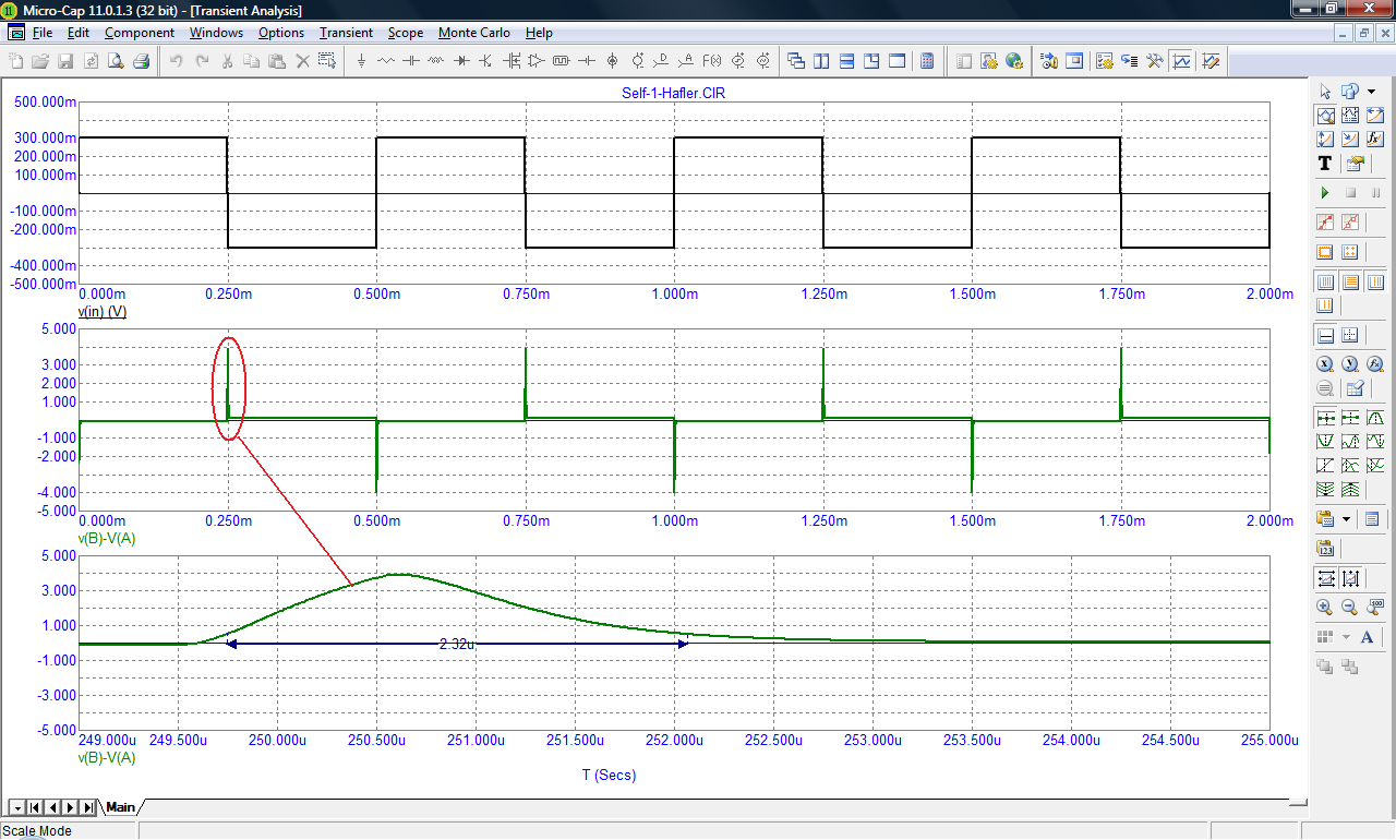

By changing the correction, he managed to reduce the signal transit time by 4 times, which had a positive effect on the sound quality. But since he did not manage to lower it below 100 ns, he decided to make a new amplifier.
I also checked both models with this method, here are the test results

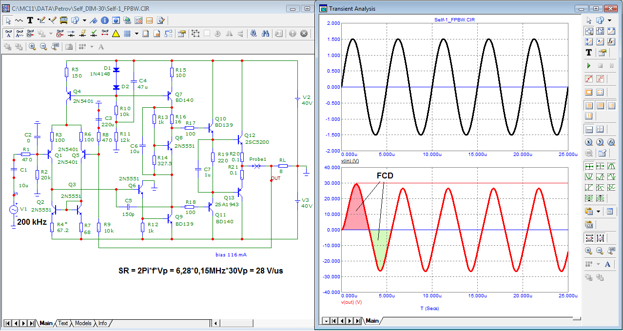

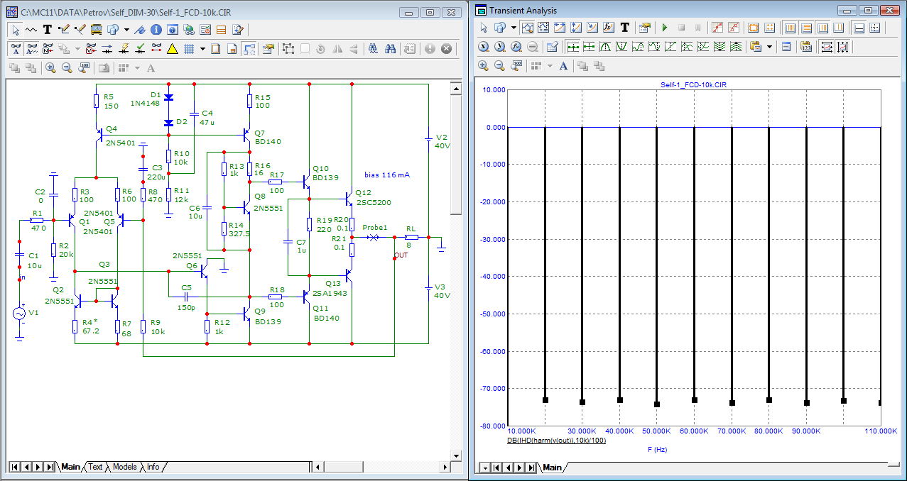

To do this, it is enough to measure the distortions of the first period (FCD), which Graham spoke about more than 15 years ago and which are directly related to the signal propagation delay time (time Propagation Delay).
I myself came to the same conclusion about 10 years ago. I learned about the existence of Graham and this branch by chance about a month ago.

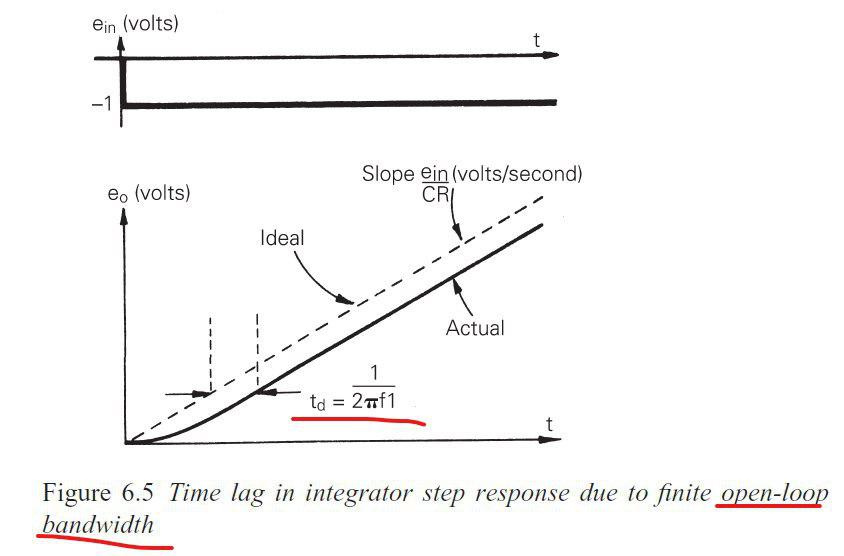

You are all trying to find some kind of know-how instead of studying fundamental theory. By itself, a decrease in GD allows you to improve the parameters, since this means an extension of the NFB coverage area with all the ensuing conclusions. This is nothing new. And I'll tell you even more - earlier Sandi Todorov pointed this out directly in the dialogue, citing an example from the english version of Jiri Dostal's book (see attach).
Your and Graham's first period test is essentially a step signal test and an indirect estimate of the integrator's error. And of course, widening the bandwidth helps to reduce this error.
Distortions of the first period do not exist, these are your fantasies, unfortunately and partly these are the consequences of using the simulator. With a limited spectrum input signal, there are no such effects at all with a properly designed amplifier.
Indeed, fully agree. Bruno Putzeys makes the same point, clearly explained, in his article I linked to earlier. Completely ignored except for an out-of-context statement that was used to mislead (or misunderstood).

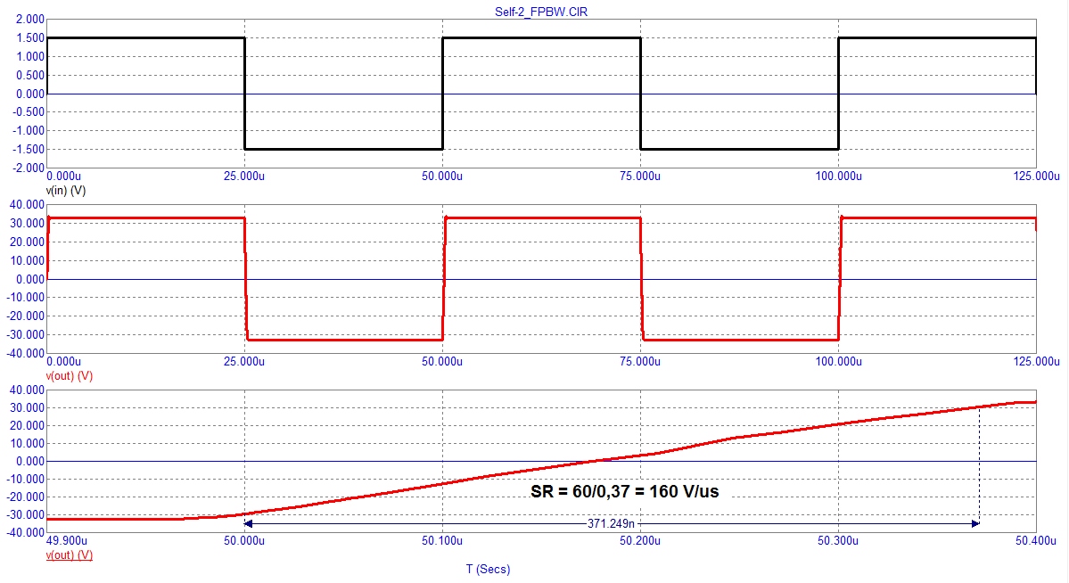

I will say it in simple terms. If the slew rate of the input signal is limited and less than the slew rate that the amplifier can operate, then we do not see any increase in the input differential voltage and at the output we have the same signal, but scaled. If we give a signal with a high slew rate, then the amplifier does not have time to process it and transmit it to the output undistorted. A dynamic error occurs, which we can record as an increase in the input differential voltage. In this case, the slew rate of the output voltage is limited to the maximum slew rate of the amplifier.
I would put it this way, distortions of the first period discussed here are entirely correlated with the transfer function of the amp and its Bode plot. They provide enough information to predict this first cycle distortion. There is no use to analyze the first cycle separately since the standard measuring technics are sufficient to acquire the same information in the form of transfer function.

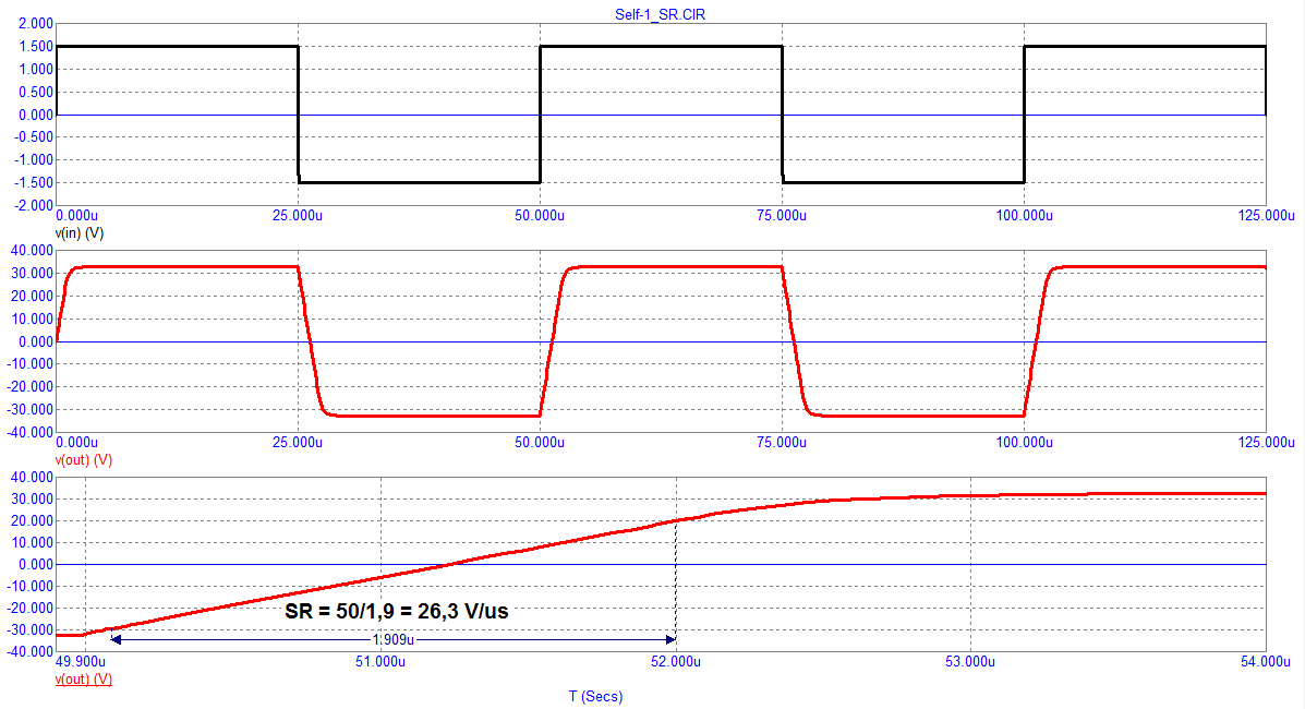

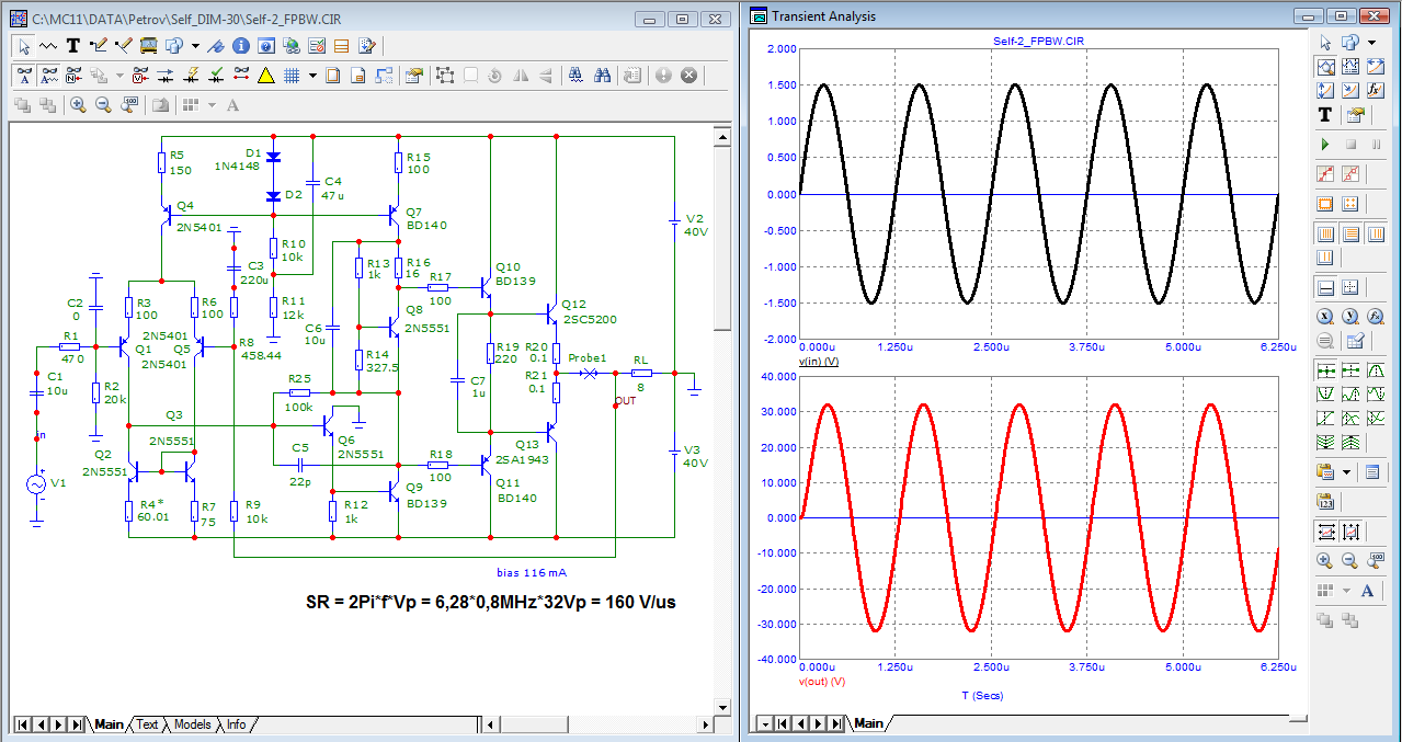

More than 50 years ago, Baksandall investigated the slew rate of real signals at the output of amplifiers and did not find it higher than 0.5 V / μs. According to fagos, amplifiers with SR = 1 V / μs must fully meet the high quality amplification requirements. Fagos, the TDA2030 fully meets your requirements with a tenfold margin.

What is 100 V / μs? SR = 2Pi * f * Vp
from where FPBW = SR / 2Pi * Vp = 100 / 6.28 * 30 = 530 kHz or more for a home amplifier.
SR - speed parameter, the more SR - the less tPD!

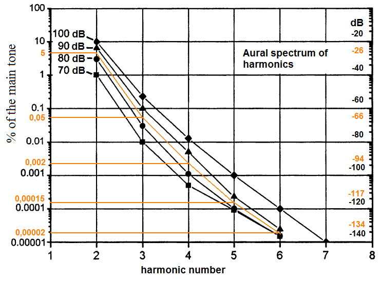

Why are non-feedback amplifiers often advantageous? The harmonic spectrum of such amplifiers is short and this is the main thing from the point of view of psychoacoustics. Cheever's work explains this effect.
