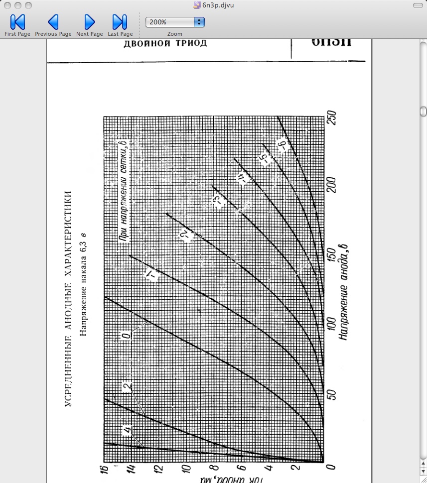

6N3P curve
Here's a screen grab from the djvu file for the 6N3P:

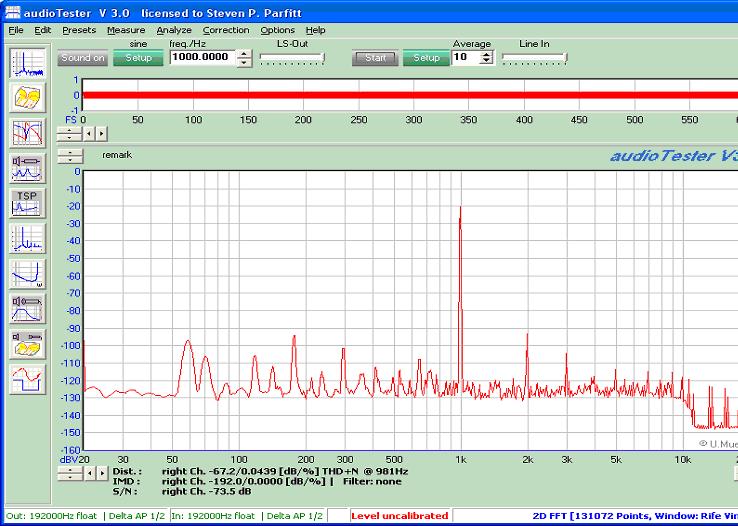

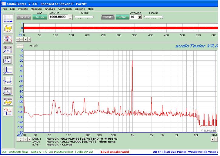

6N1P FFT
6N3P FFT
So now I need to clean up the ps or find the source and eliminate it before I can take measurements that make sense.

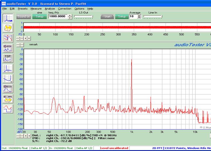

I ran the 6N3P with a IR LED and current source in the anode ckt. I adjusted the current and monitored the anode voltage from 80V to 120V while taking FFTs. The minimum distortion was around 90 to 100V on the cathode. I did not measure the current as this would have required a sense resistor either in the anode or cathode circuit.
Here are the plots for 80, 100 and 120V, along with the 6N1P at 120V(last plot):
The 6N3P seems to do best around 110V Va. The 6N1P is a little lower in overall distortion but needs about 10V more across the tube. I don't think the difference is significant in terms of measurements. I have not done listening tests yet but hope to do some later in the week.
One observation. If using a current source for the anode load, increasing the anode supply has no effect. The current source simply drops the additional voltage with no effect. This makes sense when one thinks about it.
