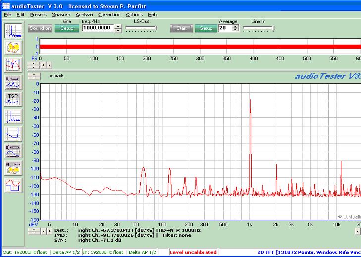

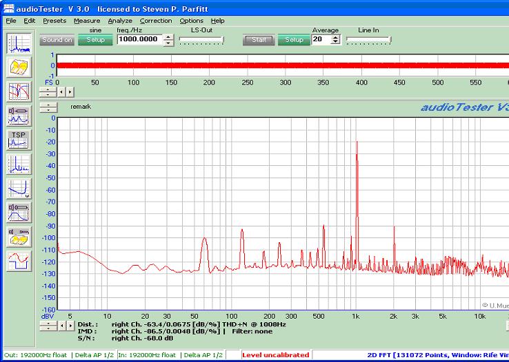

At first glance, there are much more prominent higher and odd harmonics in the 6N1P, whereas the 6N3 seems to be mostly even harmonics. That is probably why I preferred the 6N3's warm sound. There also seem to be a number of signal/PSU ripple intermodulation products more in the 6N1 plot.
Equally it could be that the 6N1 takes much longer to break in than the 6N3?

The noise floor seems to be a couple dB higher with the 6N3P as well. This may mask (make it look like it has higher THD) the distortion.

I don't understand the step drop and noise above 12KHz either. It almost looks like Aliasing noise. It is present in every plot.
I'll try to do some listening tests in the next week.
Yes that dropoff seems peculiar and it is not present on the plot in your previous post. Might pay to do a check on the test setup to see if something strange is happening there.
The thing (and it may be an aberration) that concerned me about the 6N1 plot is that peak at 5.5kHz. I don't know what could cause that but I bet it wouldn't sound great either.
Hi Steve, Gary. That 5.5 kHz peak might be related to the 10.5 or 11kHz peak, must be from some piece of mains equipment nearby? An AC motor with 2 speeds maybe? Just guessing. Well I'm shattered, the Mengyue 6P1 was voted best sound by a friend this afternoon, it's the only one with mosfet source followers, and 6N1P input tubes...Good to see your progress Steve. The 6N1P has 300-330V via 150K to anode, and 2K unbypassed on the cathode. Any chance of testing that combination if you have time or are curious?

Sure Ian. The test set up is still on the bench so I'll wire that up next. I was wondering how using LEDs compared to traditional gain stage any way so I'll wire up your configuration next.

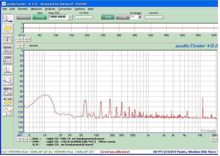

I'll also get a plot with the input set to zero to see what noise sources are being picked up.

First plot is current source in anode, LED in cathode and signal generator turned down all the way.
Second plot is 1vrms out with current source in anode and led in cathode.
Third plot is 1Vrms out with 150K anode, 2K cathode un-bypassed.
I wonder if the spike just beyond 10KHz could be noise generated by the current source?

Thanks a lot for that Steve, much appreciated and very interesting. Do you know if a distortion spectrum for a particular tube is characteristic of all tube output voltages, within reason of course? Or does it change a lot according to output voltage swing? Great to see you got your test gear up and running. I'm not sure yet whether I'll stay with just my ears as "test equipment", or go the next big step, time will tell. I'm having some trouble coaxing some decent sound out of a Ming Da MC34B chassis and iron (with 6P3S), I thought it was pretty good until I did some A/B testing with 2 other amps yesterday. I have a 6V/12V heater switch on the front panel so I can try out any 6V/12V input tube with the standard 9-pin arrangement. I'm on my fourth different input/phase splitter stage and going nowhere fast. I may have dubious quality cathode caps on the output tubes, so will try fixed bias and hope the tubes can take the extra B+, we will see. Best of luck with your experiments, I love reading about them.

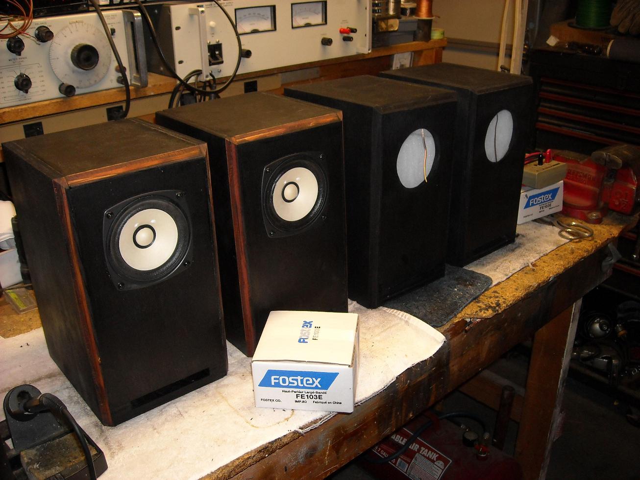

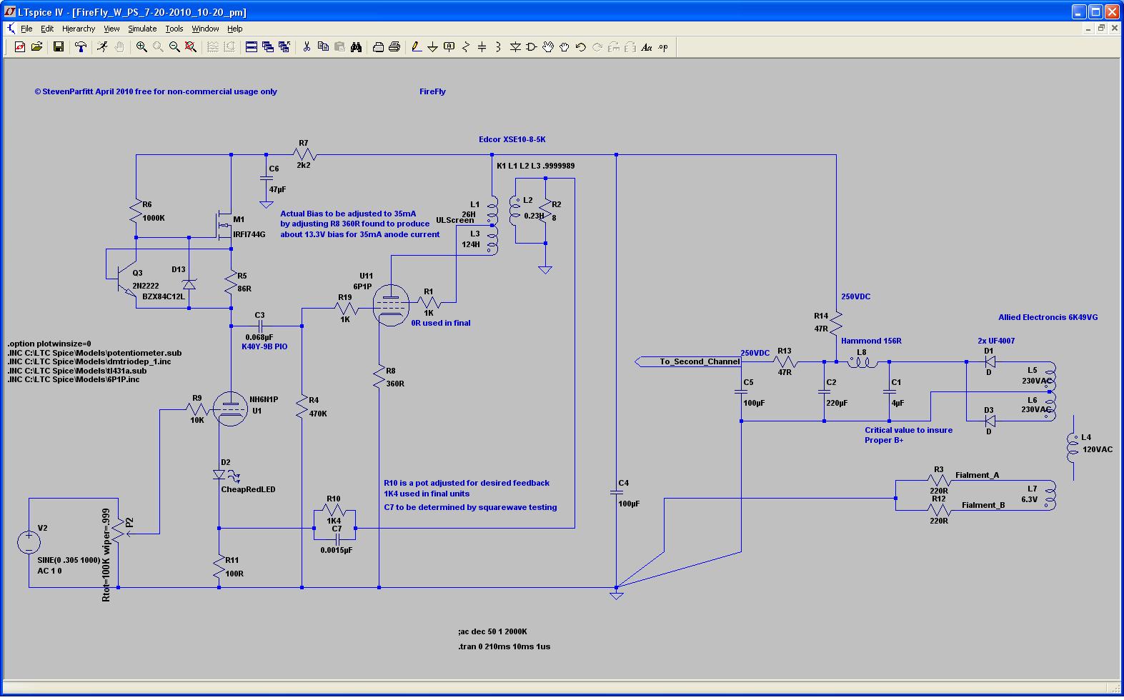

I built two sets of speakers that are meant to be used with the FireFLy (Single Ended Amp).
And, I think I finally finished taking measurements of the prototpye, so I built a second channel on the same test chassis and completed the power supply. It all sounds pretty good over all for such a small amp.
I did some additional tests with a cathode resistor bypassed, unbypassed, and with cathode voltage sink. The unbypassed cathode resistor had the lowest distortion, but didnt' sound the best. I'm building the first amp with a 360R cathode resistor bypassed with a 330uF 50V Cap per tube.
I'll build the second amp with a voltage sink in the cathode and then compare the amps when they are finished and I've had a chance to listen to them for a while.
They look nice. I've had FE103eN mFonkens on my desktop, which were quite enjoyable. Whatever happened to your 6P1P PP amp?

I ran the FireFly™ for 6 hrs tonight and got a 34ºC rise in temp on the power transformer with two channels biased at 37mA. If I'm going to get any lower distortion I'll have to up the bias, and the only way I can see that with this transformer is to add a second transformer for heaters to off-load the B+ transformer.
I've been listening to Bonnie Raitt all evening. She sounds really good. Nice attack on drums. Steel Guitar sounds like steel, not wood. ... reasonable sound stage on "my Opening Farewell" from Sweet Forgiveness.

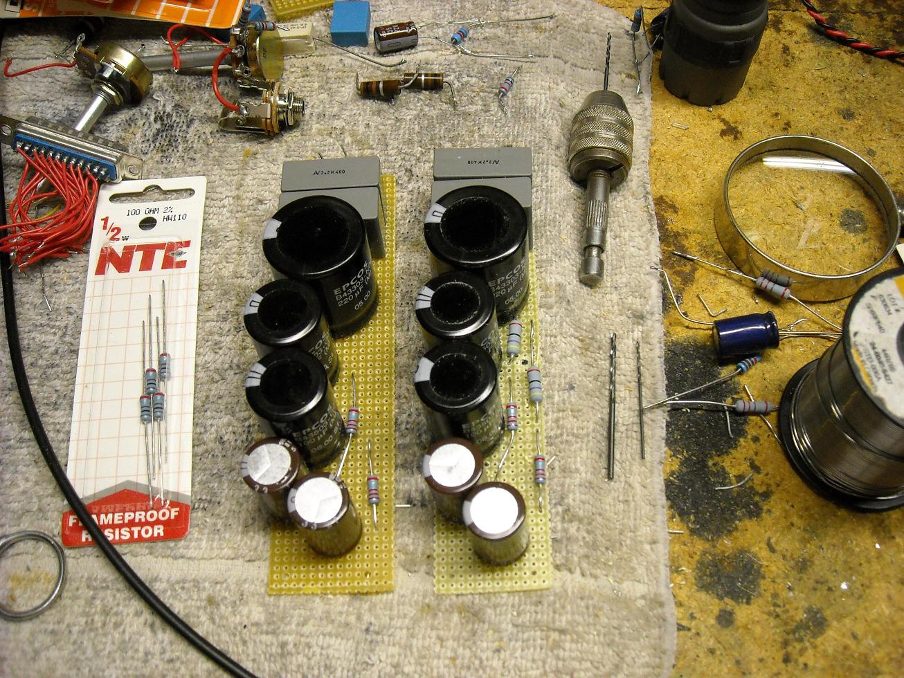

I got the power supply boards wired for two amplifiers (Both Stereo, not two channels) about finished.
The transformer is rated for 50mA at 460V CT (capacitive input) , and 6.3V @3A. I'm running it with an inductive input, and tuning the voltage with a small input cap to get 250V DC B+, so I have 80VAC across the inductor. According to my calculations I should get near 30% more current at the lower voltage this way. Transformer temp seems to confirm this.
I can leave it the way it is, or add a 6.3VAC transformer for heaters and up the bias slightly more (Maybe 40mA?). But that is starting to get on the edge design wise.
I'm using MKT film caps for the first stage (only 4.4uF) to set the voltage. As I believe they should handle the ripple better than AL electrolytic caps.
