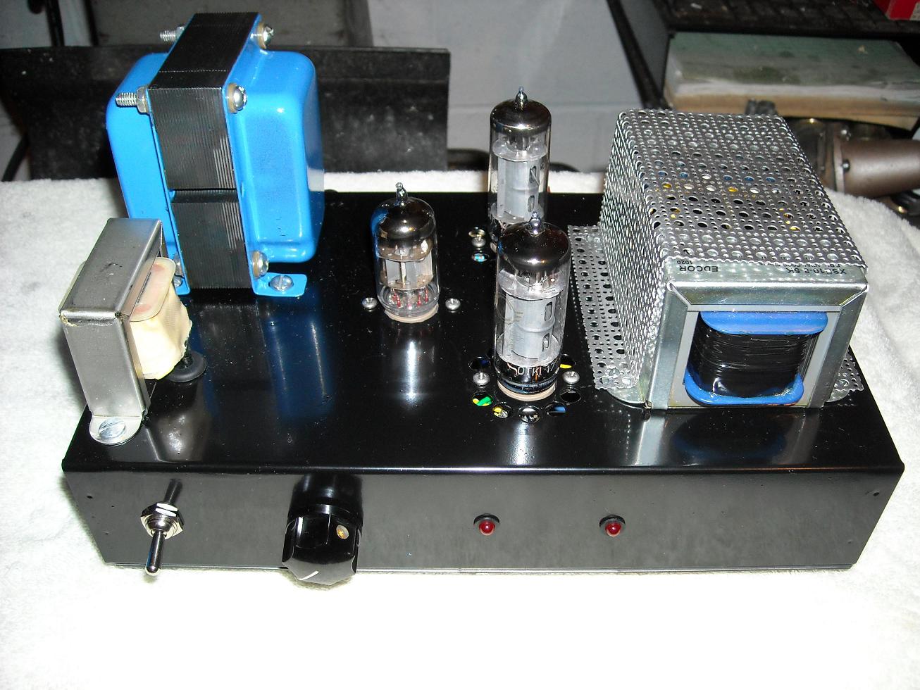

OK, found I had the wrong value resistor in the current sources, LEDs backwards, transformer polarity backwards for GNFB and one transformer set to 60% UL instead of 40%. Other than that it checks out ok.
Sound is really nice after fixing the few mistakes. Base still lacking but to be expected all considering.

I also found that the dual parallel inverse diodes (1N4007) from star ground to chassis cause buzz in both channels, but a 120R resistor does not.
Diodes do not effect both channels equally.
Can anyone explain this?

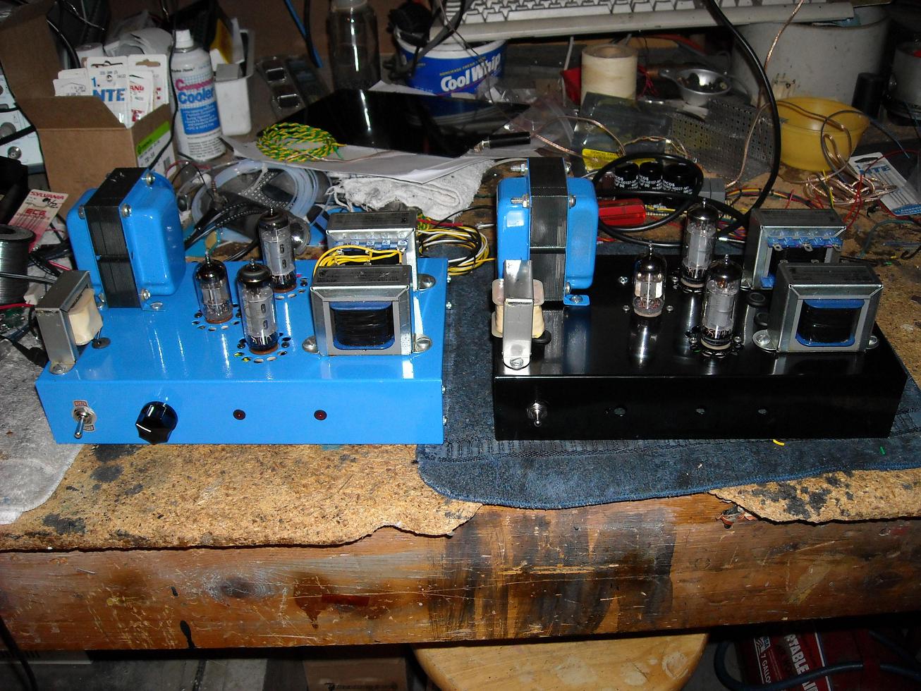

Well, number one is running fine and I started building number two for SWIMBO.
Heaters are wired and verified, star ground and ground isolation ckt is done.

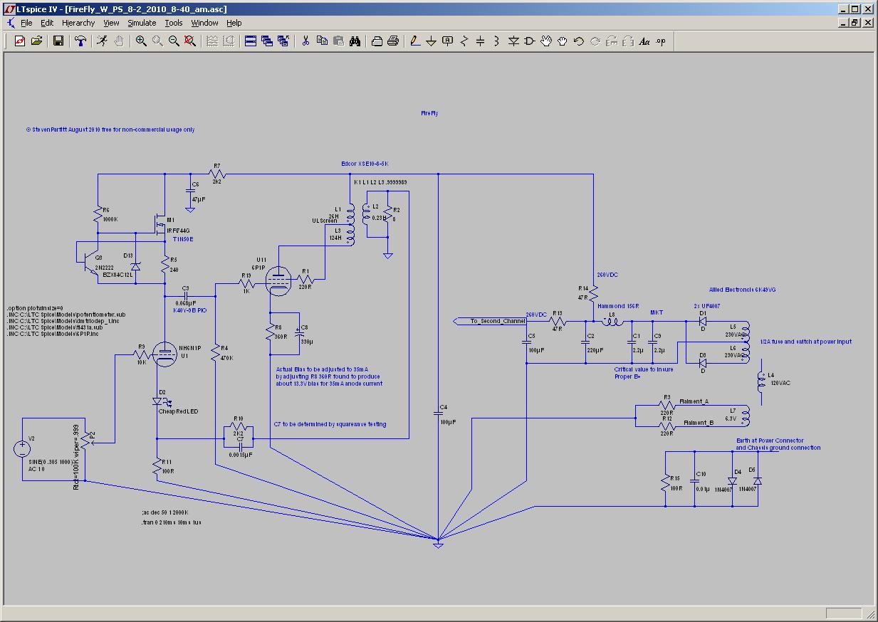

Are you still using the schem on post 48? What is the value of R6, 1M or 1K?

R6 is 1M, I can't get LTspice to accept an input of 1M so I use 1000K which it is happy with.
I've tweeked a few things so I'll post the latest schematic with power supply (this won't run under spice because I have several things left out, but it makes a near complete schematic).
I'm using a 1/2A fuse in the input, and the ground isolation is shown.
I miss-typed SWMBO (Phoenetics from the 50s cause me to add vowels to acronyms).
Inputs and outputs are isolated from chassis and grounded at the star ground point.
I don't remember where I found the ground isolation scheme, but if I only use diodes it makes for buzzing in one channel. Why only one channel I don't know but it did the same thing to the PP amp. Adding the shunt Resistor eliminated that and the background noise is now dead silent, even when driving the Heresy.
I wanted to try Schade feedback, but determined that with the current source cranked down to around 1mA and a 100K Schade feedback resistor I would have swamped the current source. I would have to remove the RED LED, and go to a cathode resistor or lower voltage drop LED to use the Schade feedback tecnique. This is something I still want to investigate later on even if I have to abandon the current source/LED bias scheme.

In Post 77 one can see the Current Sources mounted on the 6N1P dual triode with the blue wires running to the power supply board HV connections.
I mounted them this way because I reasoned that the wire to the PS was going to a lower impedance point whereas, if I had mounted the current sources on the PS board and ran the lead from the Current source to the anode of the 6N1P the wire would be connected to high impedances at both ends. Thus this configuration should be less sensitive to noise pick-up.

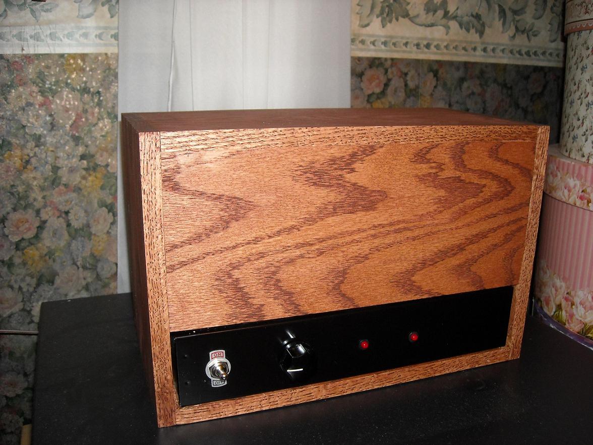

Bump. Wife wasn't happy with a painted metal chassis in the bedroom so I built a Red Oak cabinet for the black amp. I couldn't do a wood bezel as I already had the controls set and they would have been recessed too far.
I have to get some 1-1/4" long 10-32s before I can mount the feet.
