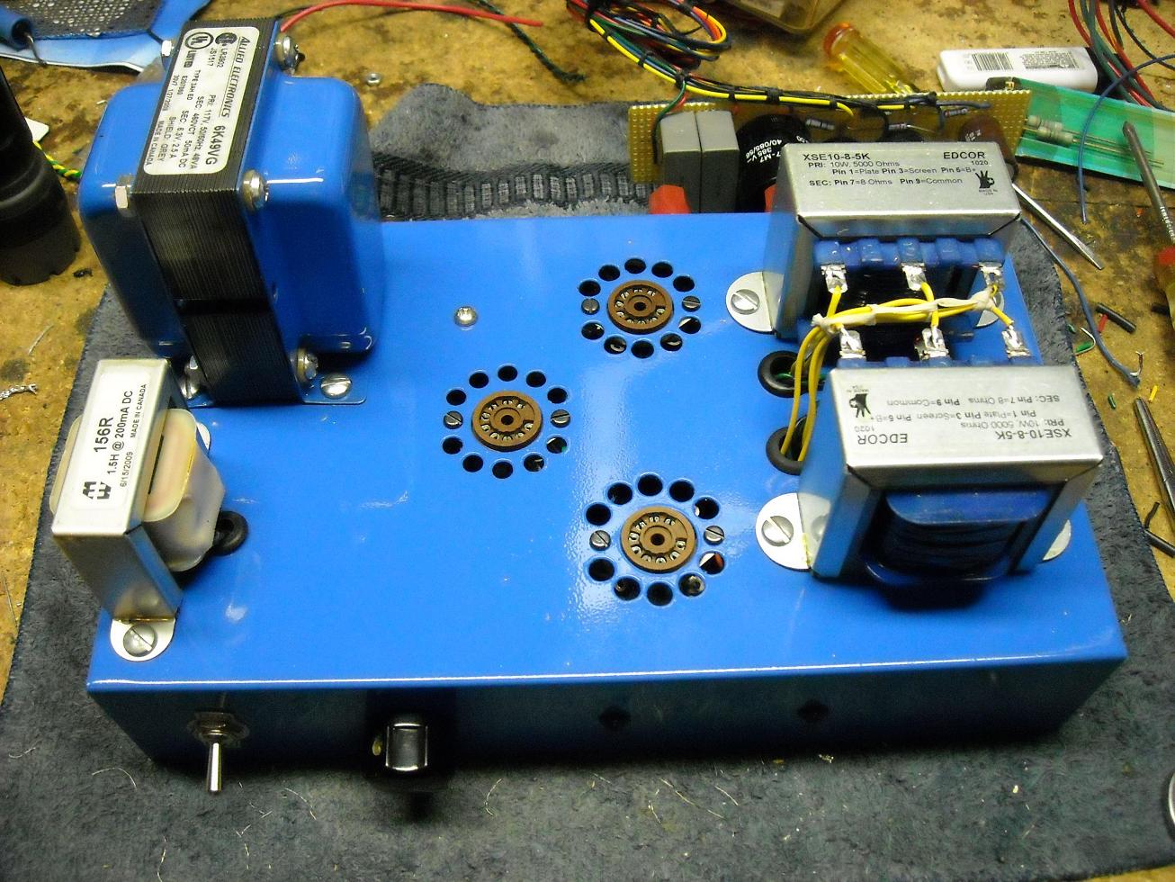

I've started on the chassis (2), and have most of the components laid out.
However I have one minor issue. Does it matter how close the input twin triode is to the main power transformer (as long as it is not right on top of it).
I have the main transformer, choke, power supply, output transformers etc laid out with them spaced as far apart as possible to minimize magnetic coupling.
The tubes will be between the OPTs and PS transformers.
The tube on the left is the input tube, with the two output tubes on the right.
Does the input tube need to come forward?
I'd prefer to leave it where it is and put the volume pot right in front of it.

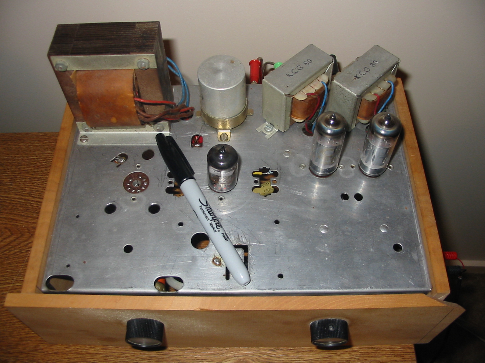

Here is a pic of my ugly little console SE 6N1/6P1. I put a Sharpie-fine on top for scale. No major induced hum from the open transformer (I actually found the noise problem that developed is a dubious socket under the 6N1).
Please keep us posted on how the amp sounds with the Edcor OPTs. They seem like a bargain if they sound halfway decent.

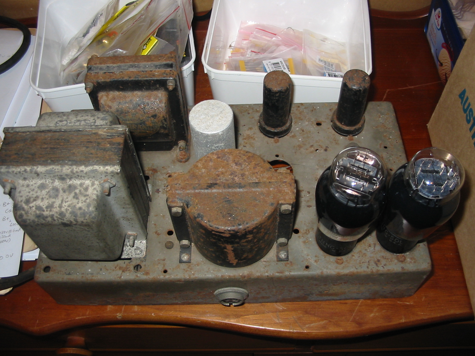

Oh and while we are posting tube amp porn 🙂 Checkout this oldie I picked up recently. PP 6A3 driven by 6N7's (missing from the pic is the 5V4 rect). Sadly the OPT (a Marconi "Perfect Transformer"!) has an open primary on one side. The vintage Ferranti choke is scary dangerous with exposed HT thumbscrews.😱

Layout suggestion:
Move output transformer that is front right to in between power transformer and other output transformer. Rotate choke so that its laminations are at 90 degrees to power transformer. Place three tubes along front.
Alternative:
Have narrow side of chassis as front. At back have power transformer and choke. In front of them, the two output transformers, in very front, the tubes.
Chris

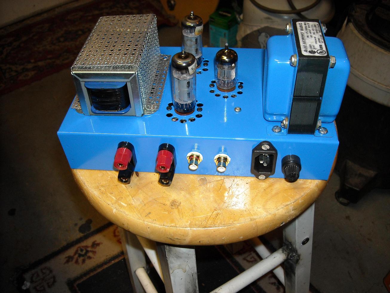

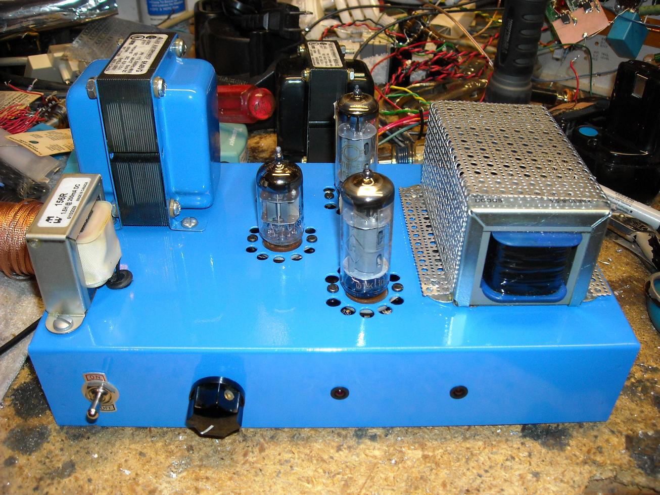

I went ahead with the layout as is and probably should have tried one different for comparison, but this makes construction easier.
I made a shield out of ornamental Al sheet as well.
They should be ready to paint and go.

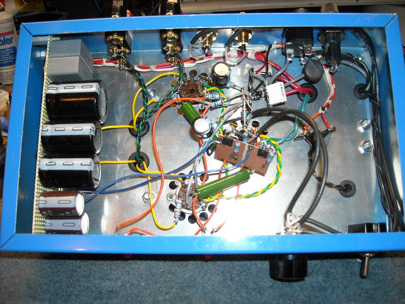

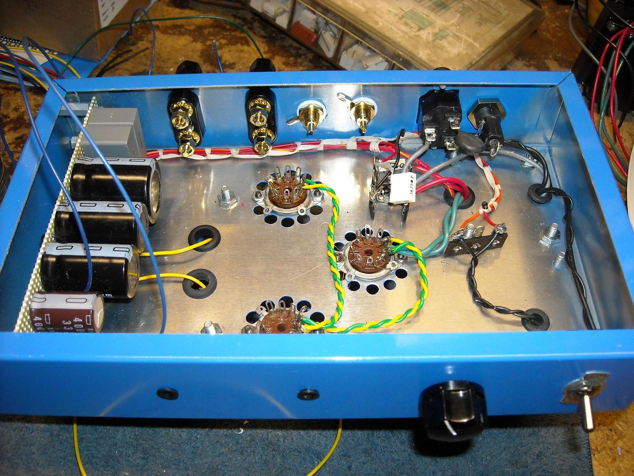

Progress is pretty good other than the expected problem with the B+ wiring from the transformer not reaching the power supply board. I'm going to add a second 3 terminal barrier strip and mount the diodes on it, then run a wire from it to the caps on the PS board. That will solve this problem.
The two LEDs on the front are the two cheap red LEDs used for biasing the input triode stages. I figure I might as well put them where one can see them.
I had to order another inductor and a few connectors, etc from AES, so I'm only working on one amp right now.
My amp is Blue, SWMBOs will be black. I'm building mine first to make the appropriate screw-ups on it.
If anyone thinks it is worth it I'll make mechanical drawings. If no one speaks up I'll skip it.

Nice work.
Another idea for open frame output transformer mounting is to take the pressed steel mounting bracket off and cut a hole in the chassis so that you can rotate the transformer such that the electrical connections are below the chassis and the laminations are parallel to the top plate.
Chris

I wish I had thought of that. I bet it would work out great with the rotation of the laminations wrt the power transformer as well.
So far everything is mounting as I planned. I have to make one small change in the PS board as the power transformer leads won't reach it. I'll wire from the transformer to the diodes on a pair of terminal strips and wire from them to the PS board. I may have to extend the inductor leads as well as they are mounted on opposite ends of the chassis.
