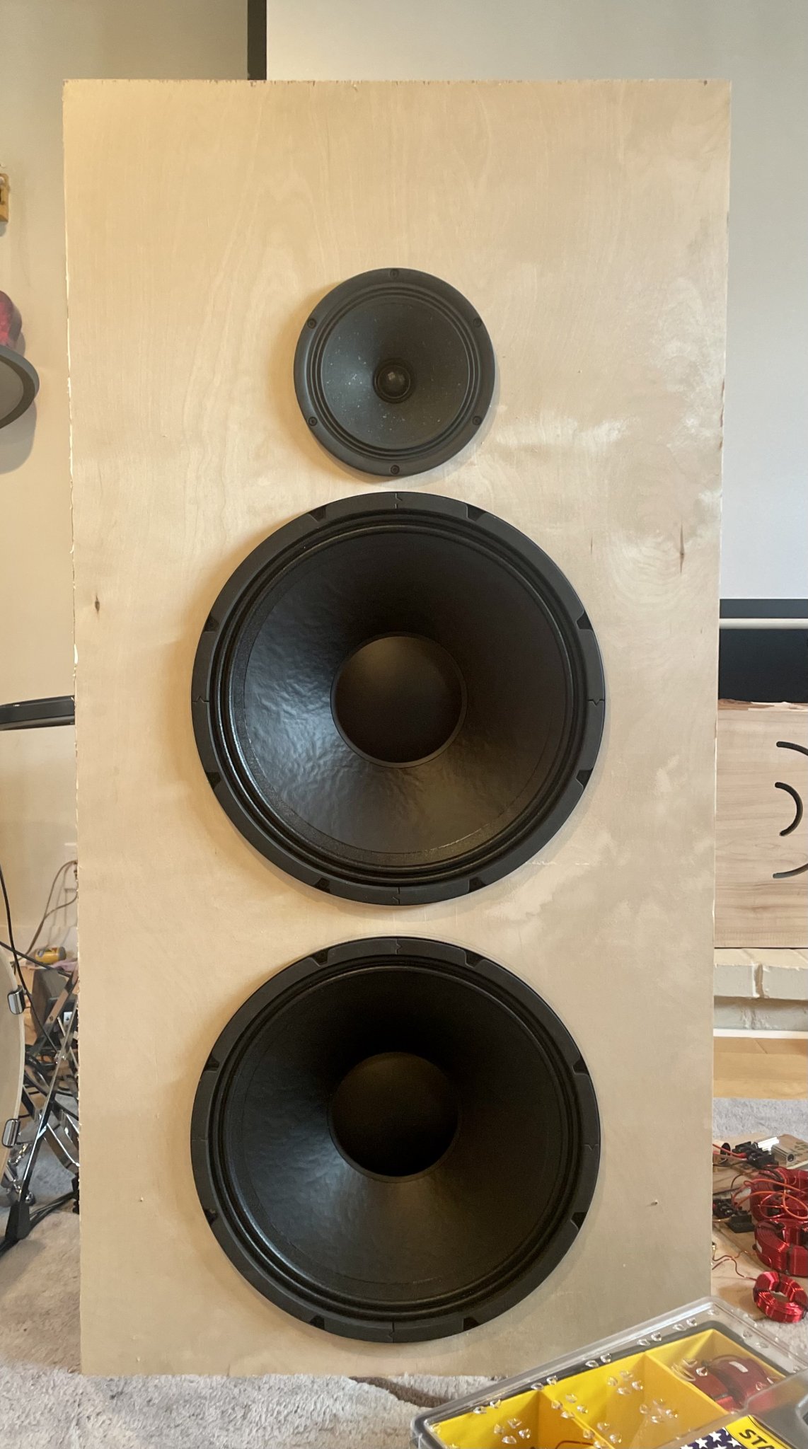

I just got my hands on one and have been playing around with it on an open baffle with 2x 15OB350 woofers.
This is my first time using a coax. I can give some subjective impressions. I’m still playing around with the crossover so take this feedback with a grain of salt.
Personally, I prefer the sound of metal-cone drivers and may try the King Coax next to see if I like that more.
If you like the warmth and classic sound of paper, want the benefits of a point source, and don’t mind the slightly dark treble, this seems like a good choice for the price.

Your Coax is centered not it is the best position on the baffle, diffraction can ruins the sound. Try to offset it.
Not sure the king coax works well in OB, this speaker is too perfect in its operating range, you will have diffraction dip. I gave up with my C16N001, a big deep at 1.5kHz. Perhaps if you work the shape of the baffle like Linkwitz did with with his LX521.Personally, I prefer the sound of metal-cone drivers and may try the King Coax next to see if I like that more.

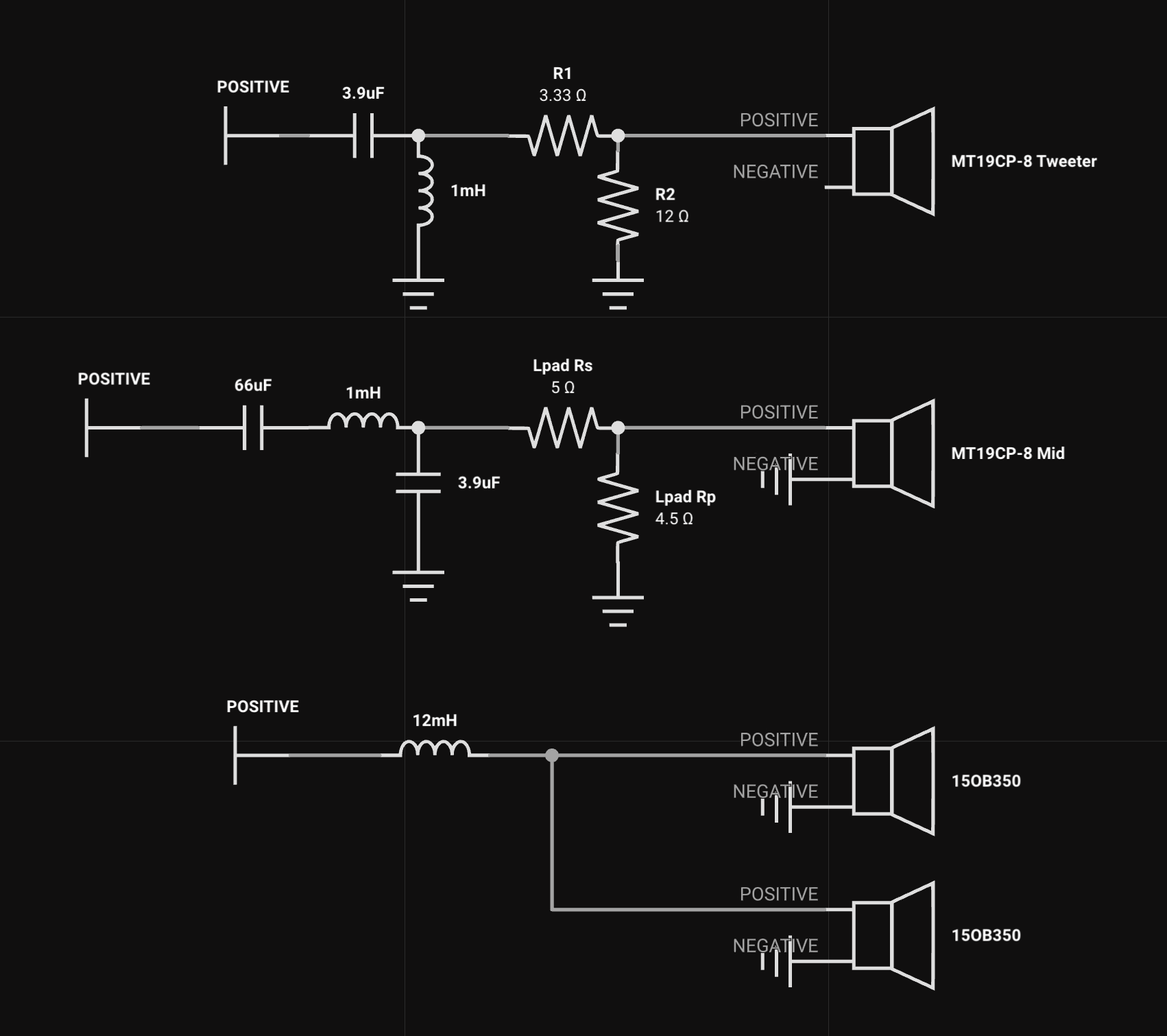

Here is the crossover I am currently using:
Some things I've learned playing with the crossover:
- Bass: 12mH inductor on the 15" woofers. This is a trick I use in all of my OB designs to get good bass extension: Large inductor on the bass drivers, with heavy attenuation of the mid/treble. It works well here.
- Coax:
- 2500hz LR2 crossover.
- 300hz 1st-order high pass on the woofer
- 9db attenuation of woofer
- 4.5db attenuation of tweeter

You use a textbook for the crossover ?
The polarity of the mid is wrong. You should inverse it, LR2 drivers are in reverse polarity. This is why you find the treble dark.
If you have too many midrange lower the capacitor in series of the mid (66uF).
You can do much better ! You have the potential of a very high end speaker.
Note you should use the same mid placement of this project (http://www.sbaudience.com/index.php/application/15inch-open-baffle-three-way/)
Try to use a measurement system to see clearly the response curve of the speaker.

I made a simulation of the crossover to confirm what I think. I have a similar project with the 12"+5"+1"WG. If the midrange is not reversed you have the purple curve. Pay attention the 150b150 has a breakup peak at 1.5kHz, it can affect the treble if not well suppress. Here the 12O150 at 2kHz.Here is the crossover I am currently using:
Overall the sound is starting to come together. Despite the non-optimal baffle placing, this speaker sounds pretty good. It is very fun to listen to and works especially well for EDM and rock music, where the big, full-bodied & warm sound excels.

Awesome! Thanks for doing that! Good catch about the polarity of the mid. That has been fixed.I made a simulation of the crossover to confirm what I think. I have a similar project with the 12"+5"+1"WG. If the midrange is not reversed you have the purple curve. Pay attention the 150b150 has a breakup peak at 1.5kHz, it can affect the treble if not well suppress. Here the 12O150 at 2kHz.

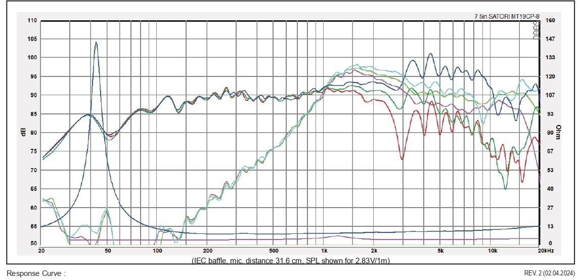

https://www.justdiyit.com/sb-acoustics-satori-mt19cp-8-r1-coax/
Conclusion:
To be honest with you I wasn't expecting much from this coax. Most of the coaxes tested disappointed me and I tended to give up, only Kef knew how to make good quality coaxes and were a step ahead.
However, this one surprised me. It does the job quite well!

Call me crazy but he mentioned 2000 hz 4th order (24 dB/octave) slopes but I only see 3 components on the tweeter. Isn't that a 3rd order? If the tweeter was falling off, I could see how it could create a 4th order but it's raising at that area. What am I missing?Tested and implemented with LR4 @2Khz here:
