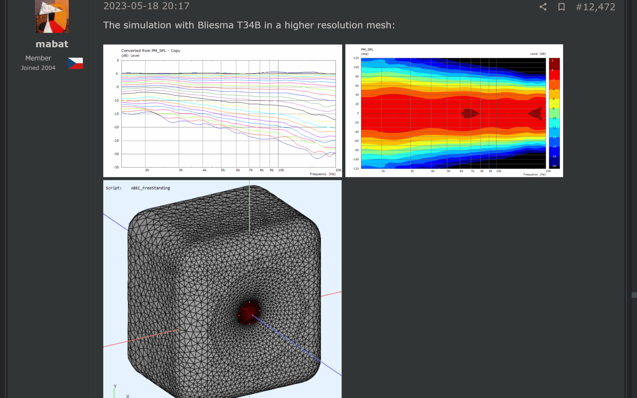

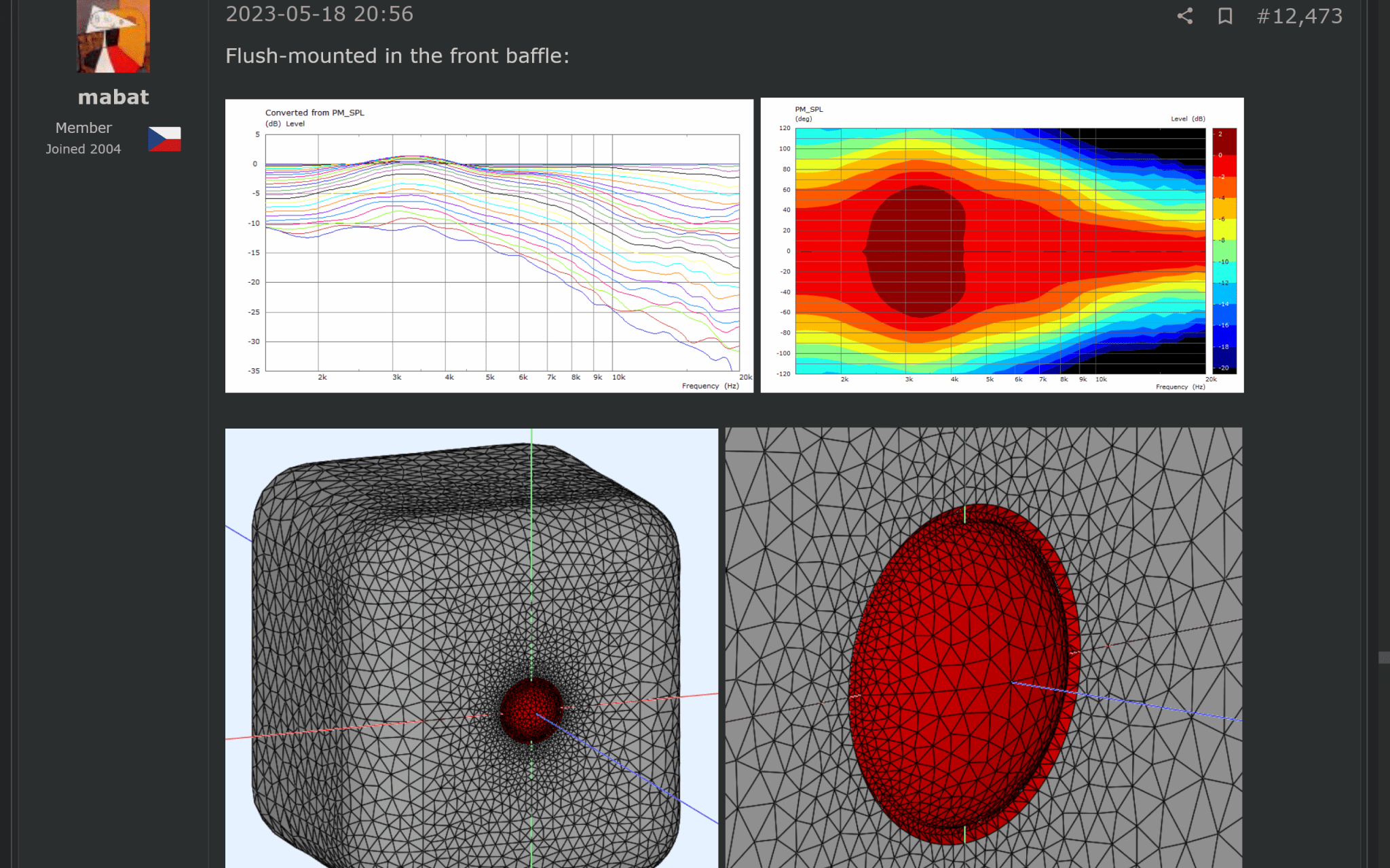

Nah, because every baffle is a waveguide, flat baffle represents the special case of a non-optimised waveguide. Optimised waveguide not only makes off-axes responses more consistent, it actually widens the pattern in top octave compared to naked tweeter. See this sim by @mabat, screenshoted here for ease of reference:The (hard) dome tweeter on the flat baffle (albeit with a small round over) absolutely has the flattest and smoother response from 5-20Khz; on and off axis.

Whatever is should be, it should be constant - narrow constant, wide constant, and for flat baffle it is not constant nor flat nor smooth. Alexander at Heißmann-Acoustics explained this very concisely:What I'm trying to getting at-- what should be the "correct" polar response over +/- 180 degrees?
https://heissmann-acoustics.de/en/kantendiffraktion-sekundaerschallquellen-treiberanordnun/
