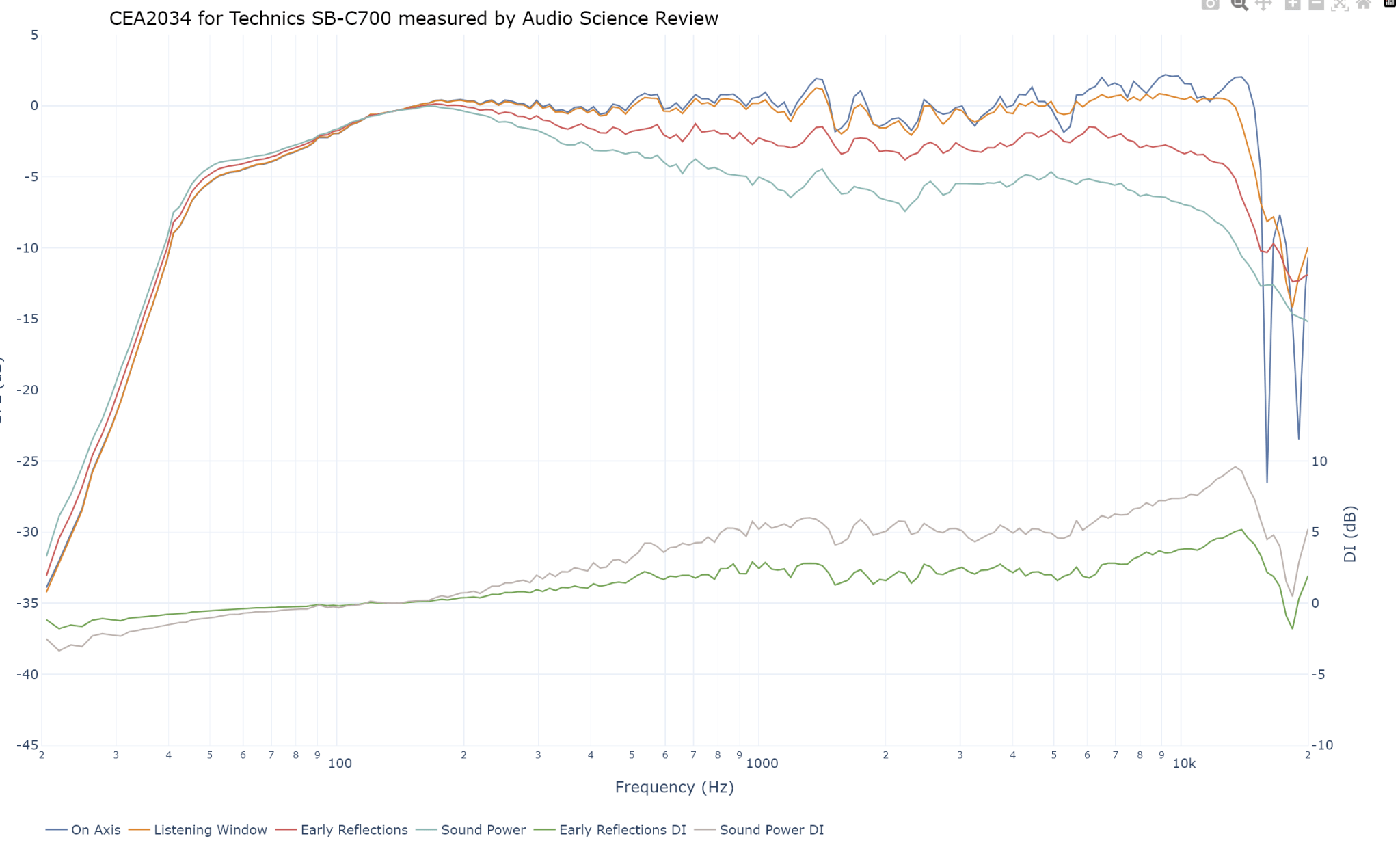

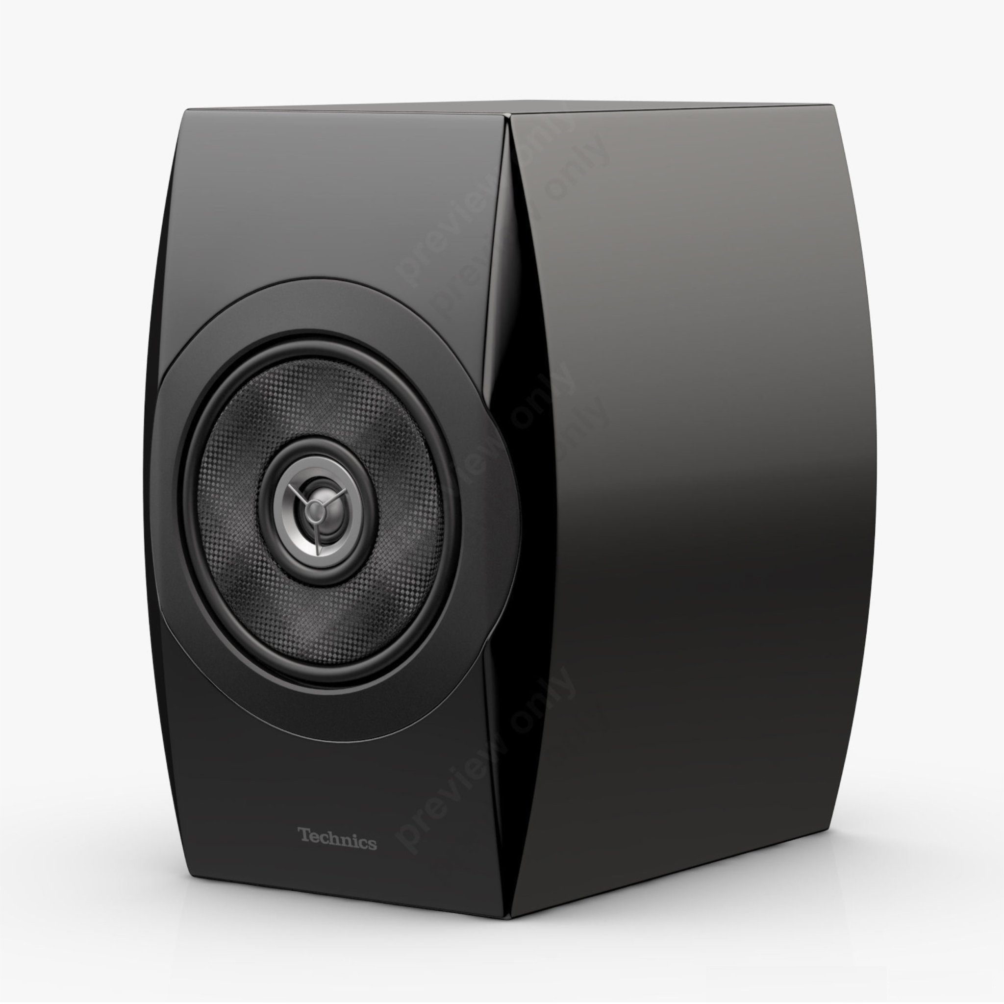

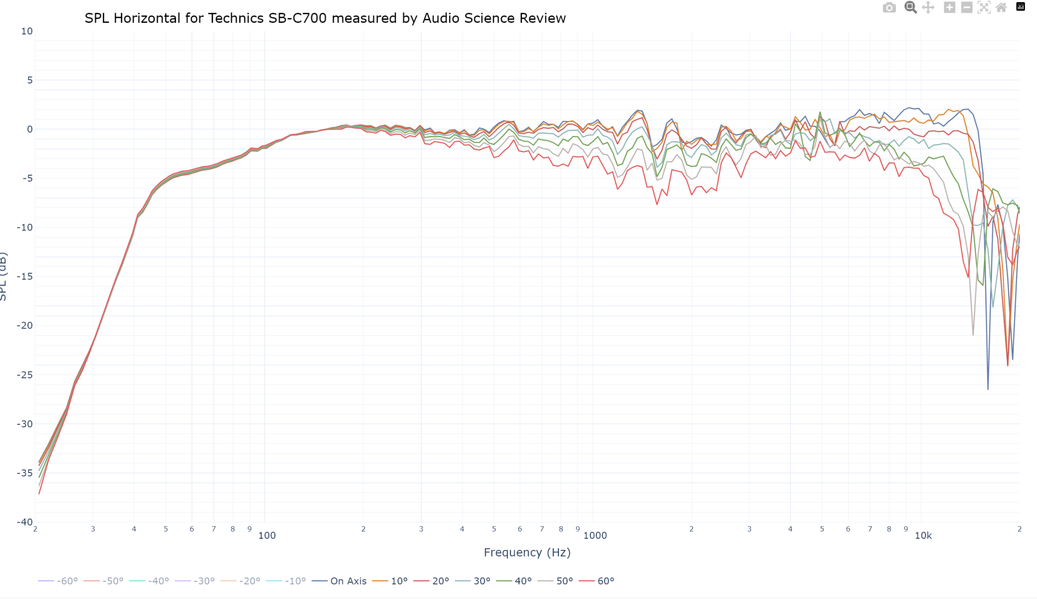

Pretty much all of them have a jump in the directivity (shown in the response from Technics above).
Unless you focus on a much wider directivity. Which will create more in room reflections.

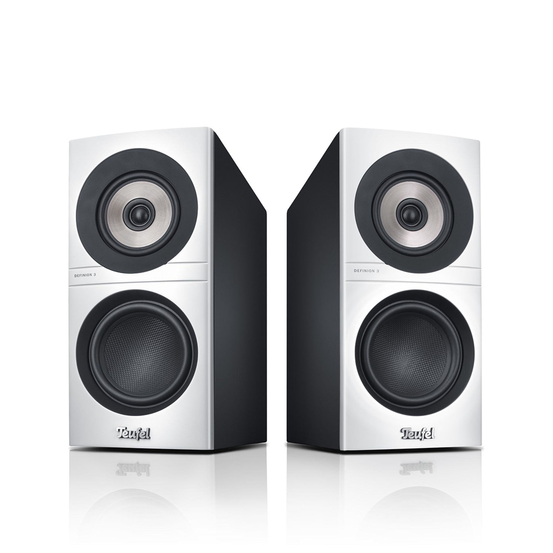

Another really good sounding standmount three-way.
Flat midrange driver; soft dome tweeter.
Very well constructed speaker; excellent value (800 euro/pair).
It can be argued the KEFs also have a directivity jump at 2500 Hz. Basically, typical cone-and-dome speaker needs to somehow make a transition from 0 db DI at 100-200 Hz to a 8-10 dB DI at 10-15 kHz, and it's not obvious for me what is perceptually better: a straight line rising from 1-1.5 to 15 kHz? constant DI of 5 up to 5-7 kHz, then rising due to inherent piston directivity of HF dome?Pretty much all of them have a jump in the directivity (shown in the response from Technics above).
IMO, Technics solution, while improvable, represent a valid terget, not necessary worse than more narrow directivity of waveguiding cone coaxial.

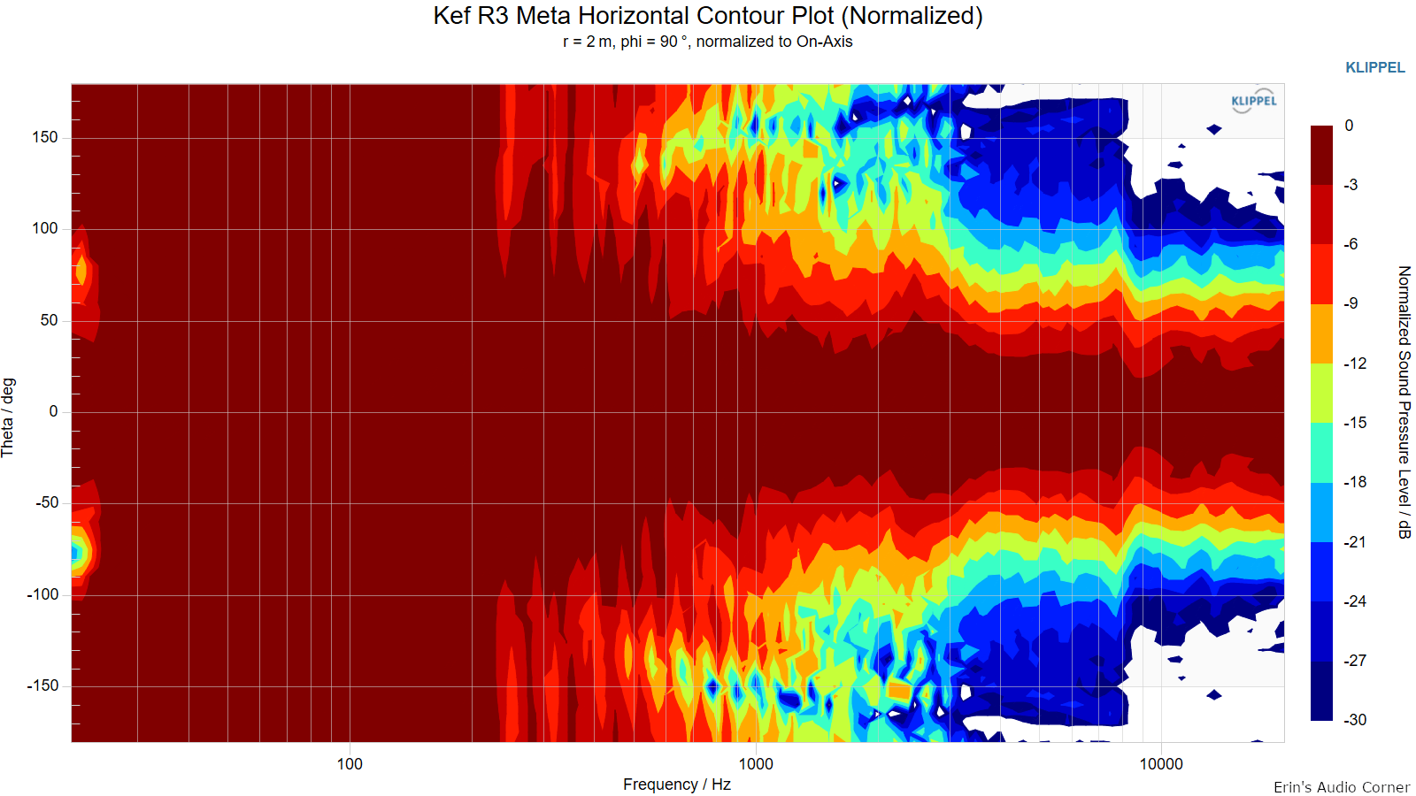

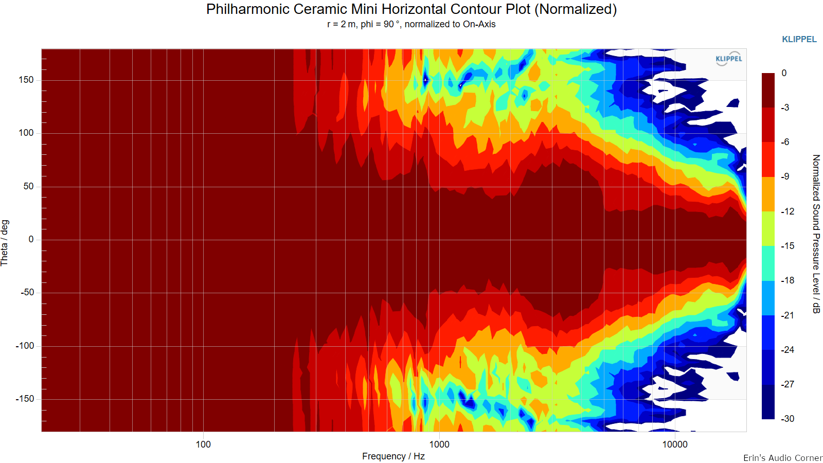

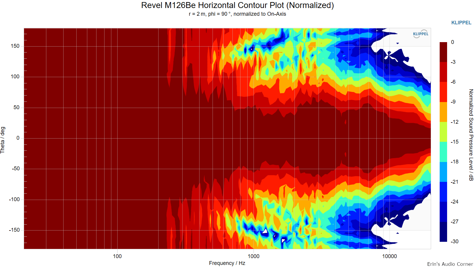

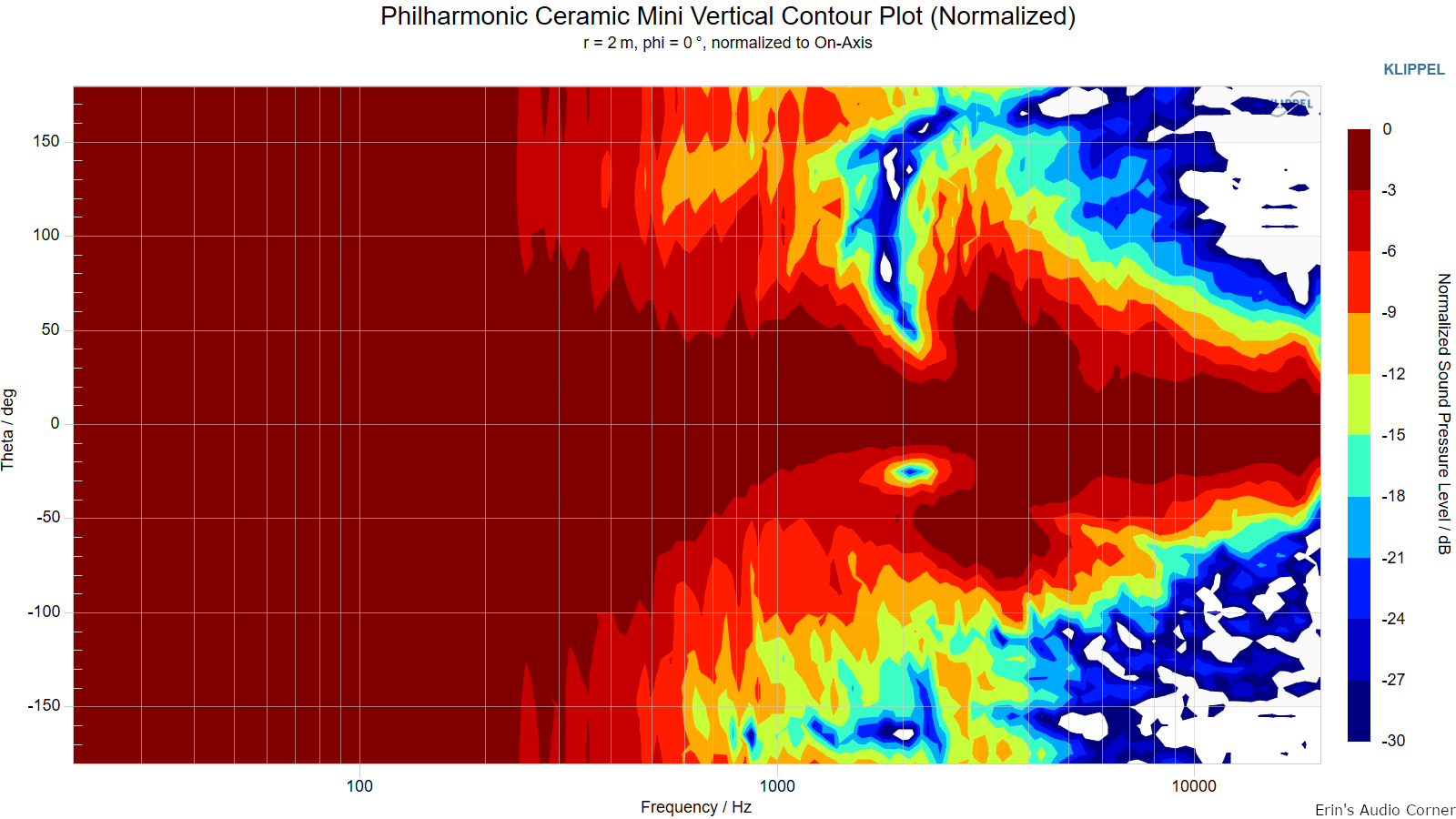

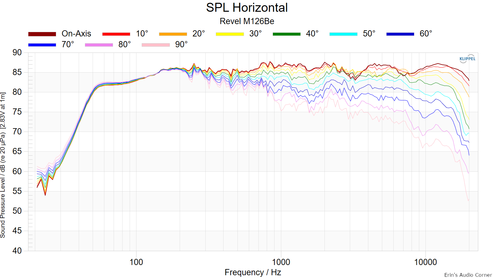

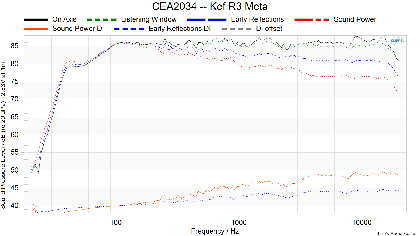

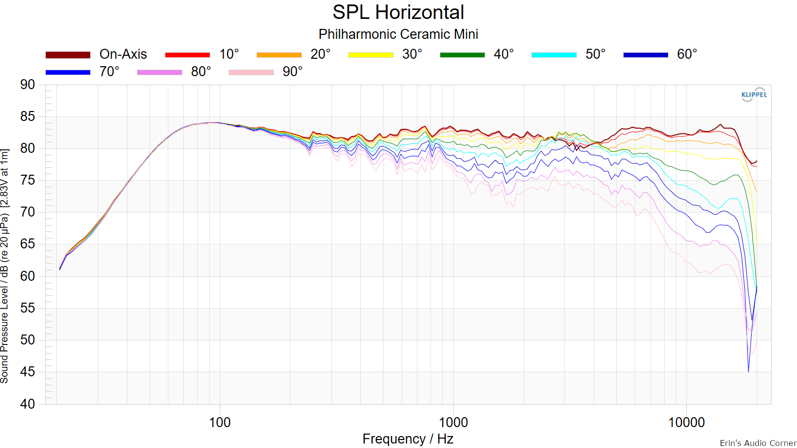

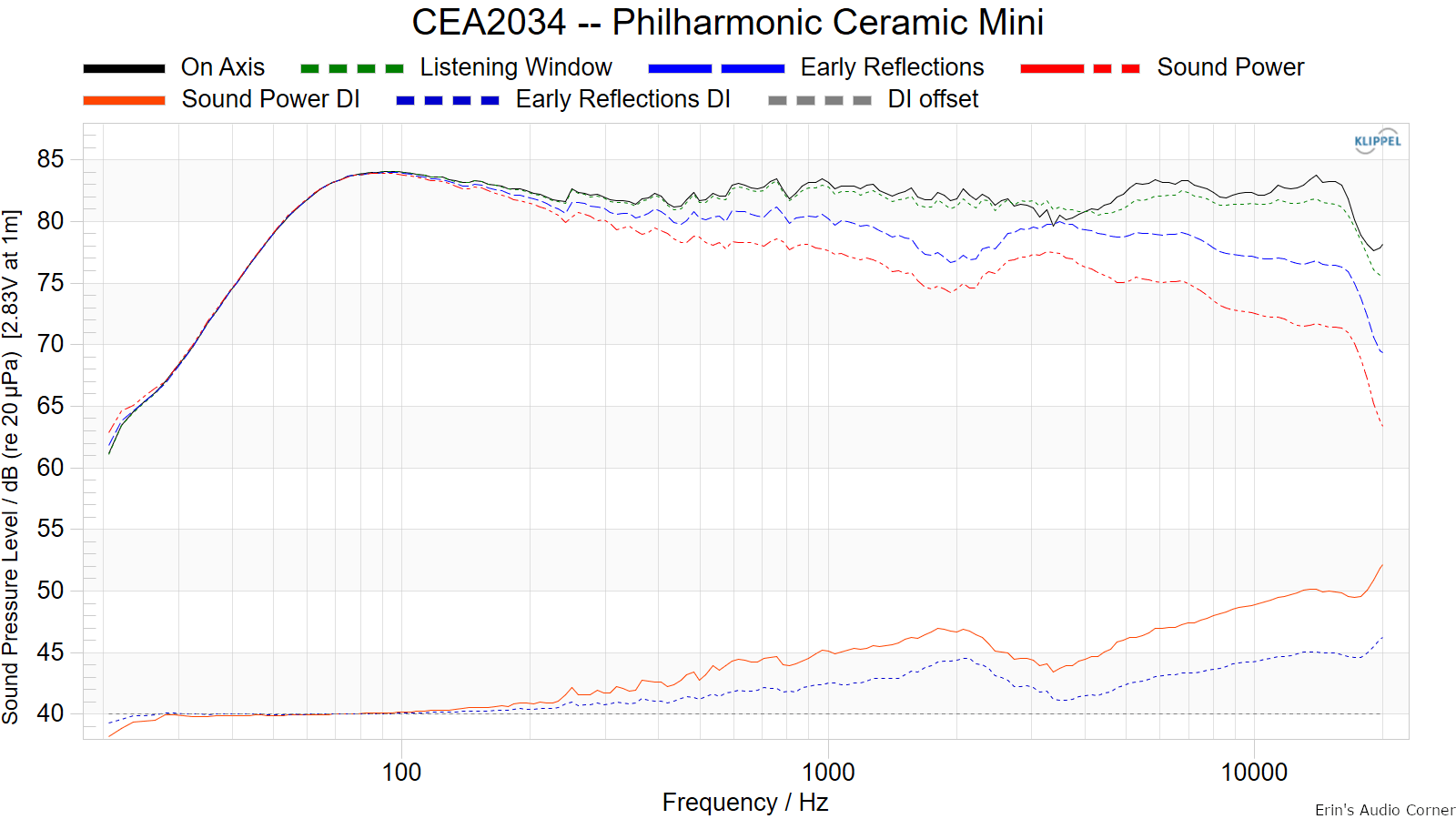

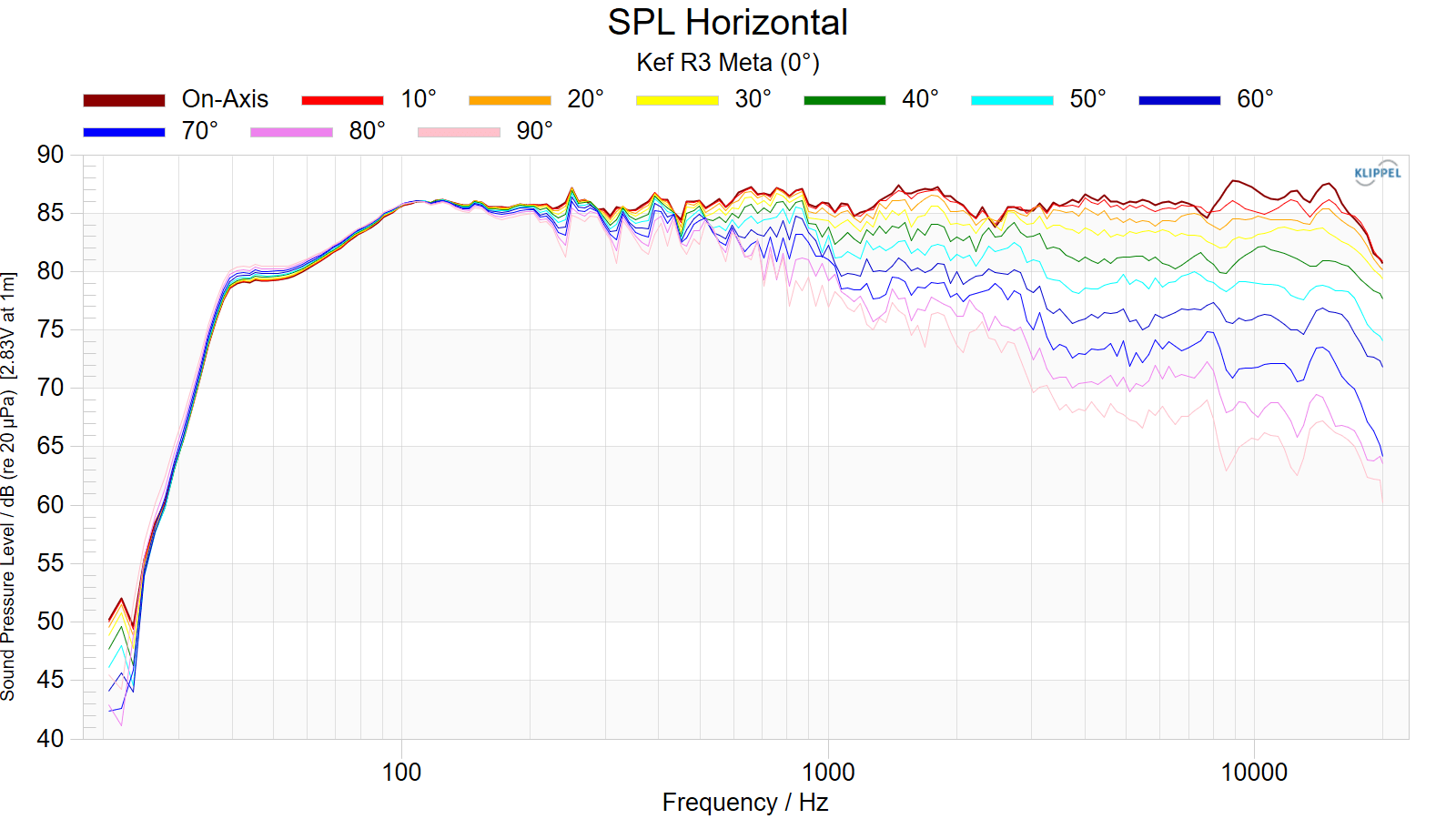

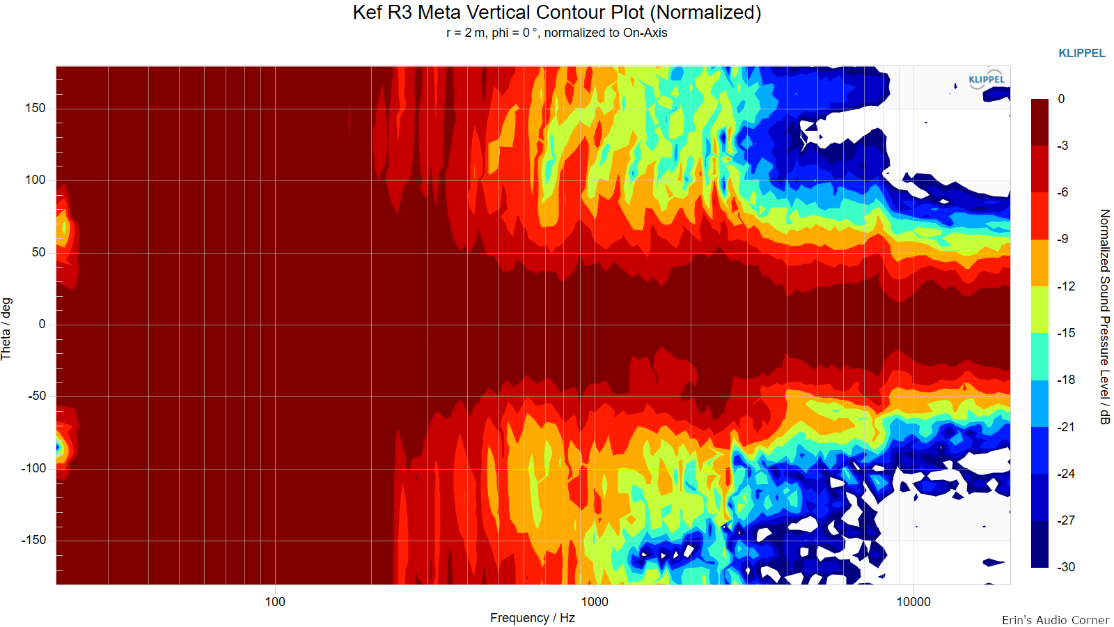

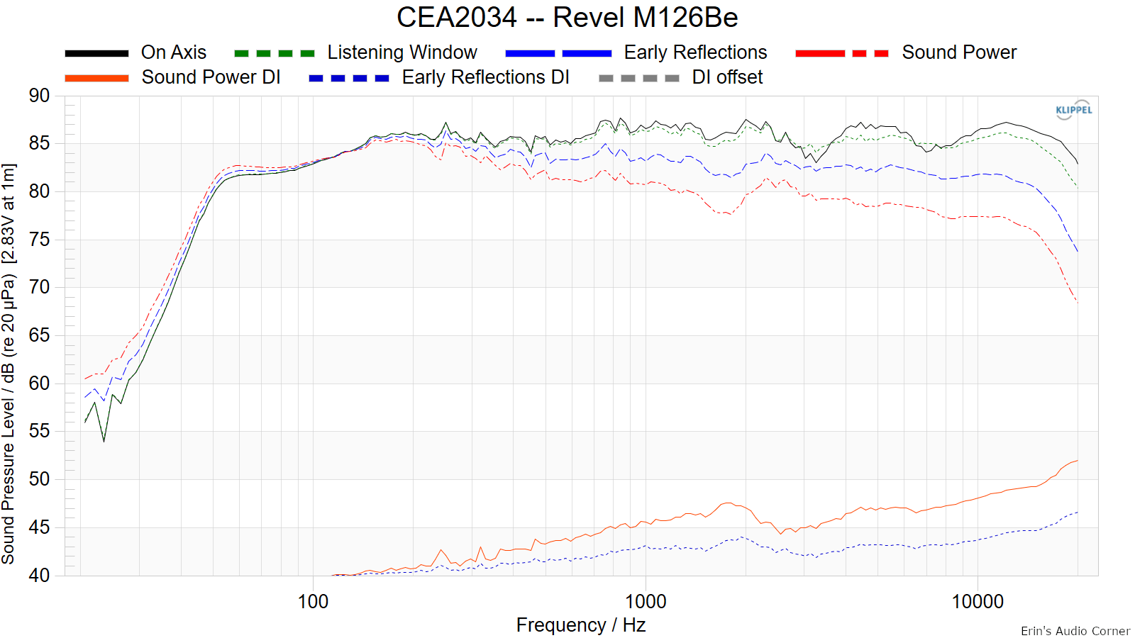

Here’s some interesting high rez measurements:
Exhibit A:
LF + HF
Exhibit B:
LF + HF (waveguide)
Exhibit C:
LF + MF/HF coaxial
Spinorama-
Horizontal polar:
Vertical polars:
So ignoring the bass differences.
Which one is most correct?
Or is it all preference?
Reference:
www.erinsaudiocorner.com

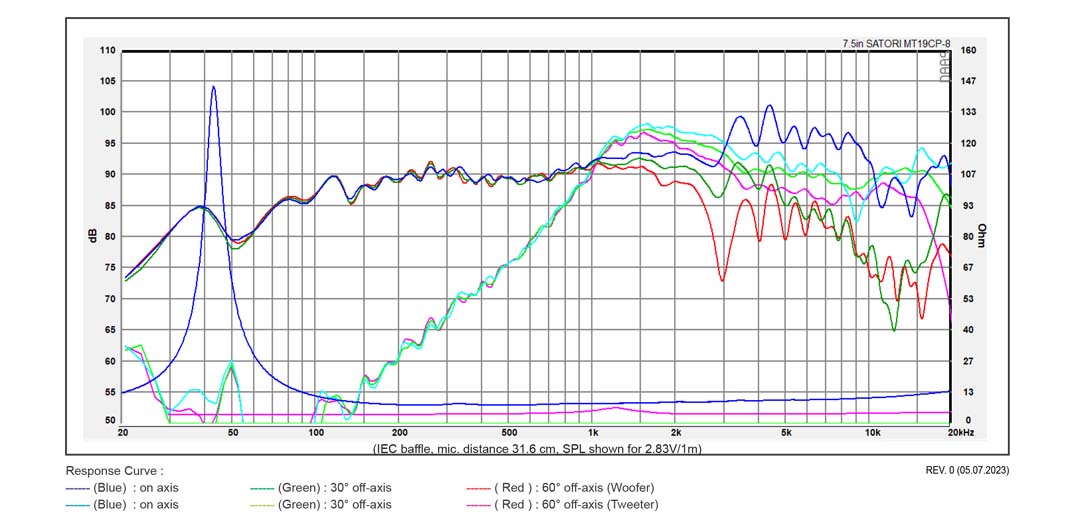

- finally, the Satori coaxial is now here
