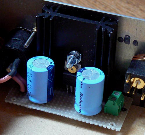

jims said:Audio1st,
Beautiful job. I want one just like it. How does it sound? What changes di you make to the board.
JimS
Hi, It sounds the most natural to me so far.
I ended up with a single 8V supply because it sounded better to me.
Also kept the original oscillator and C906, but changed all the other mentioned caps with low cost Rubycon's of similar values.
I expect my "Monarchy Audio delux 18b" DAC may be the weak link now?
Thanks allot for the picture of the drawing!JC Fardo said:

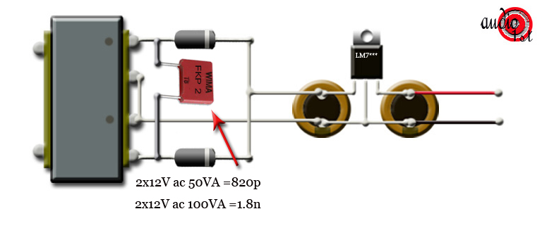

Audio1st, how do you create those nice images you always post ?
What value did you come up with for your ps?
I quickly tried some values, and it changes the sound for sure.
Hi rikkert1978,
I use Adobe Photoshop, the secret is adding "layer style", to bevel and emboss the lines.
I've used what I had handy so far, that was 1nF on a 50VA and 2.2nF on a 100VA transformer.. I hope someone with a better system and ears might find the "right" values?
rikkert1978 said:Audio1st, how do you create those nice images you always post ?
Could you describe the character of these changes please, just to know what to concentrate on when listening?
audio1st said:Hi Erik, have you tried tuning the PS.?Here
I know you like to experiment and you also have the ears for it![]()
I'm sure it has made a difference to mine..

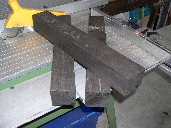

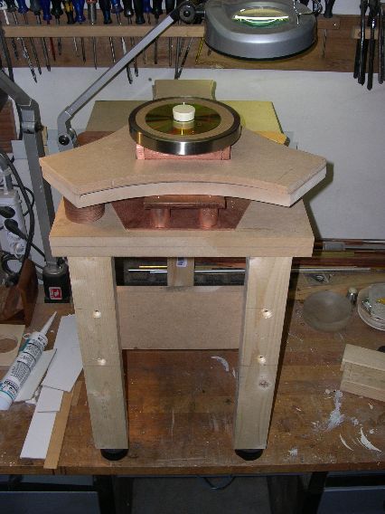

Today I took some time to built the mock-up to get a good feel for sizing and design...
This way I know later on how to exactly use the expensive ebony/copper/acryl....etc.
The powersupply is imitated by the crosswood between the frontlegs..
The height is approx. 75 cm.
Erik, that is very cool and beautiful work, but you are a madman! 😀
I bet it sounds awesome. How much do you think the stand and player together will weigh?
