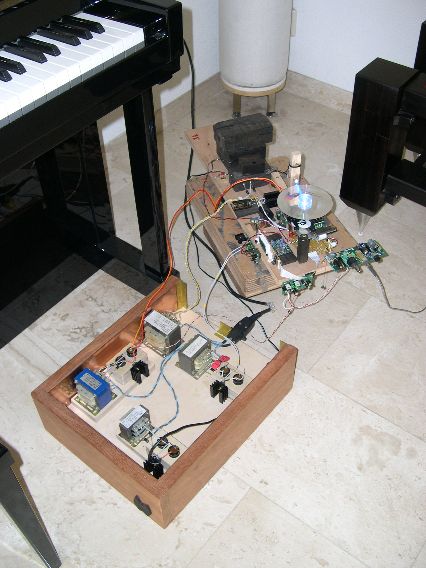

Erik van Voorst said:...a couple of days ago I made (with my friend ofcourse) a kind of weight compensation for the laser transport to solve the resonance and the free-friction on it...
Remarkable how it influences the sound for the better....by increasing the weigt you are able to "voice" ...it speaks for itself that this will continue as my final tweak....however I could not resist to build a more versatile crane for the final enclosure...😀
The foto shows a contraption made out of brass wire and a part from my miniature boating articles...quickly made to good use to give it a try...
The idea comes from Cees Pel (years ago) a very good friend of Wilco (VOID) who explained the boombox laser theory.
They have a 5 year further development of the Shigaraki on their resume..😎

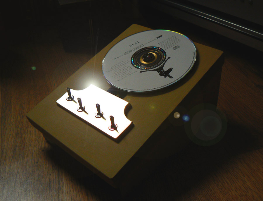

Following Erik's findings I thought I'd try a similar idea by simply angling the transport by some degree, (15 deg)..
Early construction shot ready for testing.

Indeed a clear winner...I mounted it as mailed...
Yesterday we rigged the final supplies and electronically we have finished the PiTbull......I seriously think that there is not much more we can electronicwise do to make it sound better....
For me in my set-up a lovely result....(understatement)
I will now start to concentrate on building a dedicated stand with the supply and transport as a drillplatform....a bit like a Goldmund reference turntable comes to my mind....😀

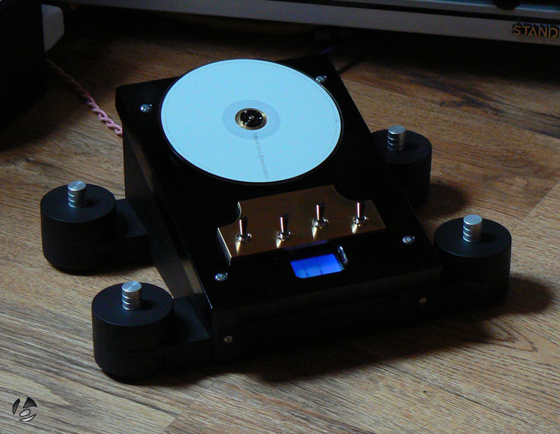

Audio1st,
Beautiful job. I want one just like it. How does it sound? What changes di you make to the board.
JimS
JimS
It looks great Audio1st! I did also like the first version you made (with the white cover) but this looks better.
