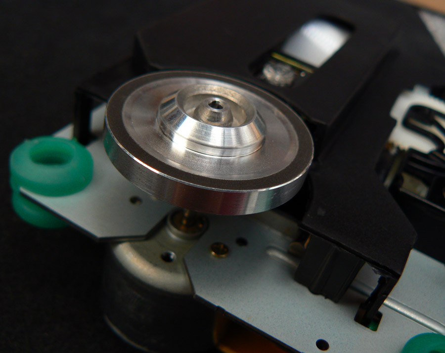

audio1st said:I have found a couple of different clamps recycled from other units.
The first is from a TEAC computer drive, which I have fitted to a motor with a 22mm shaft .
