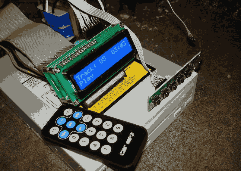

Hi Erik
Erik van Voorst said:Being stubborn I was now able to choose out of different platforms and combination with different pucks...
Before listening "in place"...
YESSSSS ...ZERO TOLERANCE...I received that with one out of four platforms from Singapore in combination with a puck from Utrecht (Void/Wilco/Remco)..yeh even the screw on pucks were diffrent and introduced a wobble from slight to unacceptable..
So Utrecht-Singapore-The Hague took care of getting me finally what I wanted...a 100 percent job
Especially with the blue light on a transparant puck...it is dead easy to see any deviation....none..happy me !!!!
The other puck/platforms had deviation from slightly towards unacceptable
Results exactly what Peter experienced....the sound comes far more out of the left and right speaker...very good stage...and more...uhhh....stressfree
This is a no brainer ...the magnet is a goner....enter the Delrin/Acryl combo...

Hello Jeffrey,
The blue led is simple...just a bright led 12 V with a resistor...I will experiment in time with the brightness..
The blue light reflects as a mystery on the puck but is actually easy mounted just above the cd (like the Kalista)
The Platforms are from Clearaudio Singapore and Quartel Miniature Models at Rotterdam..
Mind you only ONE (combination) was good (without devition)...so it is costly...to get it as you want...
At Quartel it costs 69 Euro's...and Clearaudio I think 50 dollars
The screw-on Puck is from a dutch Shigaraki-dealer..

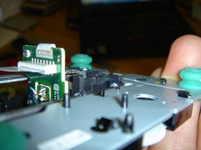

Shigaclone SF-P 10 IN Safety Equipment
This is the laser parts and motor
for replacement your CD if they
had trouble someday

Do JVC RC-EZ38 you for Shigaclone ?
I can't find 31 and 51 in ASIA, but if I can find sanyo module which model can support ?
Rubydac
Rubydac
Re: Do JVC RC-EZ38 you for Shigaclone ?
http://www.sanace.com/Optical_Lens/SF-P101N.html
No pcb 🙁 🙁
Can´t help any further
