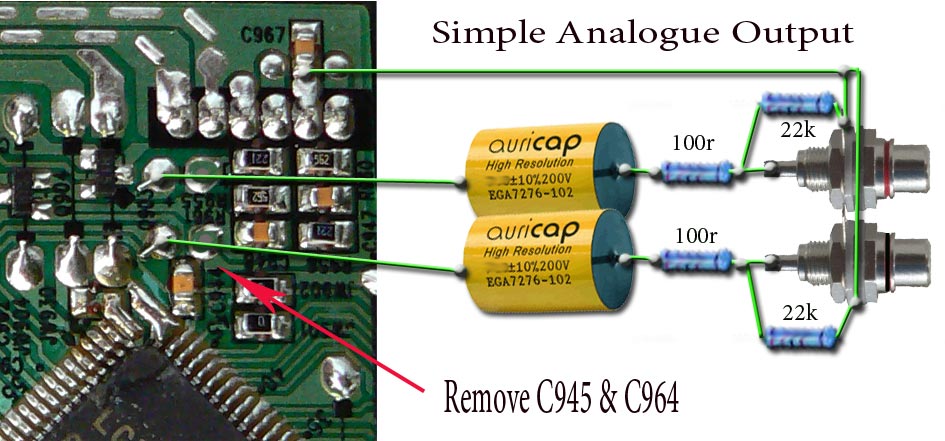

I have worked it out....Silly Trip
I removed the analogue output coupling caps. I soldered them back in and now I have music!
I have to say it doesn't sound that bad in standard form. I cant wait to drop in the Black Gates and get an external DAC

Hi Richard, for analogue out you will need to replace the output caps, R1 and R2..Add better quality here if you wish.

audio1st said:Hi Richard, for analogue out you will need to replace the output caps, R1 and R2..Add better quality here if you wish.
Hi
The two caps used for analogue output coupling are 3.3uf 50v
Unfortunately I don't have any BGs but I do have some Panasonic FC 10uf 50v in my parts bin.
http://uk.farnell.com/9692363/passives/product.us0?sku=panasonic-eeufc1h100&_requestid=331251
Will these be OK? If so, would I be better swapping two of the BGs 10uf 50s used elsewhere on the board for these? And putting the Panasonic in their place.
Peter if you remember I purchased two BG 10uf/50v to replace the 4.7uf.
Your help is appreciated as ever
Richard
Hi Richard, don't waste the the BG's for the output. it will never compete with a separate DAC.
The 10uF Panasonic's are small enough in size to fit on the board so use these. You could always use off-board Poly's to get the best out of the on-board DAC if this is the way you wish to go.

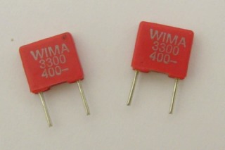

Hi Richard, the Wima's will be no good, the bass will be none existent..Stick to the Panasonic s for now.😉
audio1st said:Hi Richard, the Wima's will be no good, the bass will be none existent..Stick to the Panasonic s for now.😉
I have just seen the prices of the Auricaps, Ouch!

Tripmaster said:How about a ClarityCap SA 3.3uf 630v?
Richard, Just the job..😉
