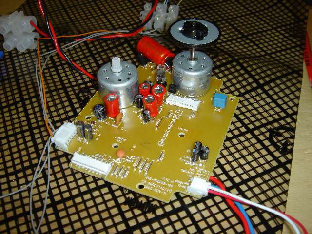

chakija said:Well i also removed R3 ,but i don't think that it matters ,at least at current problem...
Yes ,the laser moves but there is still no read 🙁
If it spins up very fast and the laser sledge moves backwards and forward, it could still be the laser ribbon not connected properly.
Well, I have hit a bit of a stumbling block. My DAC shows spdif receiver is ok, but does not get PLL reclock when I hit play so no music for me.
Spdif output looks to be right at 4 vpp, and this is about 1/2 volt less than what my Marantz CDP is putting out on its Dout. One word about this. The pad lifted when I was trying to solder to Dout, so I have followed Peter's example and connected directly to pin 29. I'm still taking ground from the board next to Dout.
I have confirmed 5v on Vdd and what looks to be 1.6vpp on Xin. I'm not able to confirm 16.9 Mhz clock but there is a clock. It is the CSA309 crystal so I'm probably just not scoping it correctly.
I do have a stock 31 transport but I thought I'd try to debug this first before I hook up that stock unit and start from scratch.

At one moment it just start reading discs...Really don't know what happened.
BTW i replaced R3 with some 10uf rybicon i found.
Overall ,i found it sounds crappy with stock DAC comparing to my sony x222es which is nothing special.However ,i have listen just a few songs so impressions could change.
I wonder if others had same experience ?

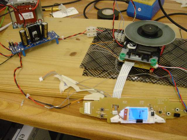

I know this has been mentioned before but I have a blue LED that I would like to mount behind the LCD display. I am taking the supply from the first DC point after the rectifiers. With a 10k resistor in series the output in 17.2v
What voltage should I be aiming for?
Richard
Richard
Unless you connect LED, the voltage will not change. Start with 10k and then adjust for desired brightness, lowering or increasing the series resistance.

Peter Daniel said:Unless you connect LED, the voltage will not change. Start with 10k and then adjust for desired brightness, lowering or increasing the series resistance.
Thanks Peter...nice blue LED😉
I have soldered all of the Black gates on board and have changed the analogue output coupling caps for two Panasonic FC 10uf.
Its 11.40pm and its time for bed. I will have a go at changing the crystal tomorrow.
Considering its running on the internal DAC and its only just started burning in it sounds pretty good.
I think an external DAC is next😉
Richard

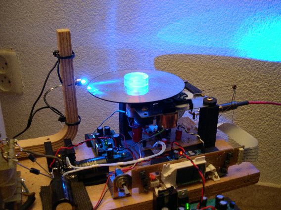

Being stubborn I was now able to choose out of different platforms and combination with different pucks...
Before listening "in place"...
YESSSSS ...ZERO TOLERANCE...I received that with one out of four platforms from Singapore in combination with a puck from Utrecht (Void/Wilco/Remco)..yeh even the screw on pucks were diffrent and introduced a wobble from slight to unacceptable..
So Utrecht-Singapore-The Hague took care of getting me finally what I wanted...a 100 percent job
Especially with the blue light on a transparant puck...it is dead easy to see any deviation....none..happy me !!!!
The other puck/platforms had deviation from slightly towards unacceptable
Results exactly what Peter experienced....the sound comes far more out of the left and right speaker...very good stage...and more...uhhh....stressfree
This is a no brainer ...the magnet is a goner....enter the Delrin/Acryl combo...

Teaching is a big word but I will keep posting (only) my winning pics....I will not post all my "mistakes" with their story afraid of becoming boring in Peter's topic...

In order to get a right platform I was proud to remove a standard platform with a selfmade pulley...however I did not observe the spindle after doing so and started pressing a beautiful
"The Hague made" new acryl platform on it ...
I came to the conclusion that the platform was wrong but what really was the case was that there was still some hardened glue left from the original situation...which gave it a very slight wobble...

Erik van Voorst said:I came to the conclusion that the platform was wrong but what really was the case was that there was still some hardened glue left from the original situation...which gave it a very slight wobble...
Now that is very important information, I forgot to check for glue residue in my unit.
