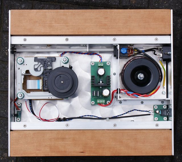

Finally, an affordable CD Transport: the Shigaclone story
top view.
kevinkr said:
Very nice!
Thanks!! Showing off one's concoctions is part of the fun I guess. 😀
kevinkr said:
The suggested divider is for spdif over coax, you drive a totx directly as you are doing.
FWIW toslink optical is inferior - your shigaclone really deserves the best bnc/coax set up you can manage. Make your other devices compatible with it, not the other way around and you will have no regrets.

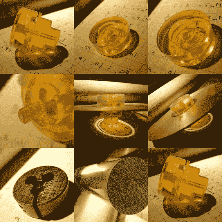

I'm done with 3rd party clamps. My advice - stick to the original magnetic puck and platter assembly. I'm very disappointed - making one that does not wobble in several plane requires a very high level of skill, and my experience has been totally unsatisfactory.
Alternatively find an old laptop cdrom drive with the ball bearing style clamp and use that instead.

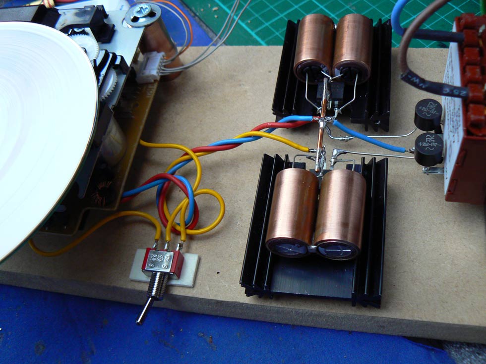

Just tested to make sure my diagram works.
Have not found any difference with track-ability between single and dual supply..
I expect using a LM7805 for the 5V supply is a rubbish idea, but I am just testing at the moment.
