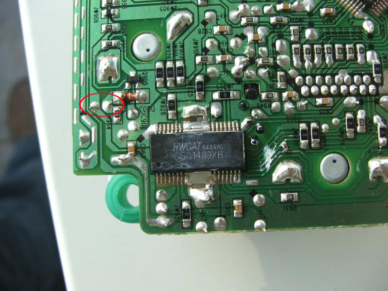

audio1st said:C954
OK, and the chip is different to the one on the schematic too.
I still can't get mine to work with a separate 5V supply
The 5V is connected to point 5A on the pdf, and I have cut the track between that point and C954. The disc spins but won't read the toc or play.
If I revert to single 8V supply, with 5A re-connected to 5B, all is well again.

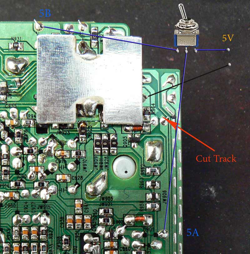

I'm not sure how critical it is, but the picture in pdf file shows a different cut off point: the trace is cut not between 5A, but between 5B and C954 (when looking at a picture, just right of the positive pin of C954). The negative pin of that cap is not connected directly to the ground, that's why I decided to leave C954 in a loop, working without schematic has certain advantages 😉
When I decided to go back to a single supply, the black wire jumper took care of the cut trace, besides being more solid than very thin original trace.

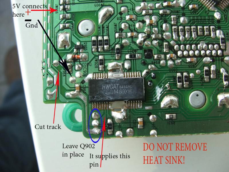

Peter Daniel said:I'm not sure how critical it is, but the picture in pdf file shows a different cut off point: the trace is cut not between 5A, but between 5B and C954 (when looking at a picture, just right of the positive pin of C954).
Indeed it is critical! I rejoined 5A to C954 with a wire link and cut the trace right of C954 and all is well, with +5V connected to 5A. See, I'm smiling again

To do it properly, it's recommended to cut the trace, otherwise your new voltage will be connected with MM1469 internal regulator: http://pdf1.alldatasheet.com/datasheet-pdf/view/82500/MITSUMI/MM1469XH.html
Besides, C954 seems to be needed, C952 is also used for 8V supply smoothing, so unless replaced with other cap, should not be removed. I use 8V regulator followed by 1000uF very close to the board, that's why C952 was removed.
Puffin said:jonners. Are you able to post any pics or a diagram of where you have connected to and exactly which track you have cut.
If you look at the picture posted by Audio1st, he has put a red oval around C954. You cut the track below the +ve lead on the left, nearer the edge of the board: You could cut somewhere around where you see the letters R964.
The +5V then connects to point 5A that is shown on the pdf - where the wire link connects (though of course you don't use the wire link).
John

Puffin said:jonners. Thanks for that. The -5v goes to the -pin of the cap next to where Q902 was removed?
If you remove the heat sink from the chip to gain access to do the mod, is it neccessary to replace it?
There's no -5V! If you mean 0V/Ground then I think it's probably best if it connects to the same place as the ground of your +8V supply. (Others may disagree?...)
It's possible to cut the trace without removing the heat sink. You would need to replace it if you did remove it, though.
John

Just to be absolutely clear: The red arrow for +5V is pointing at the track, not the smd component. I connected further North up the track, at point 5A.
John
