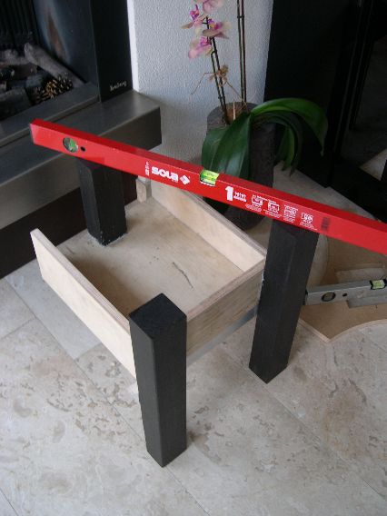

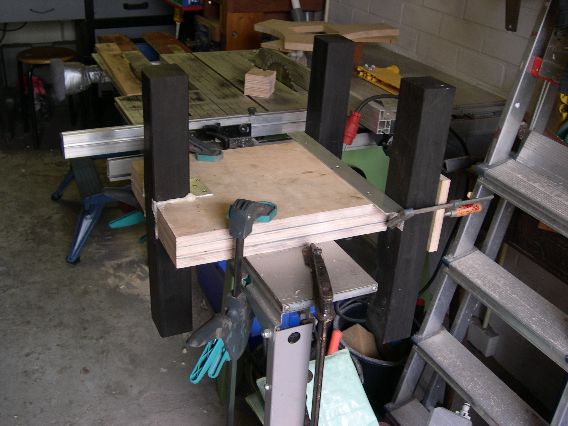

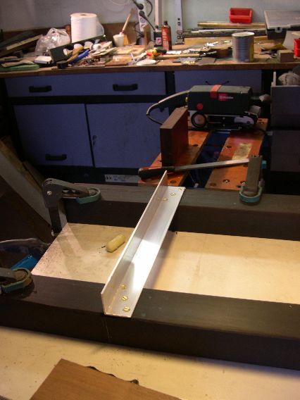

Hi Erik , my hat to you
-look at all those tools and the workshop-my tools are primitive!!!
