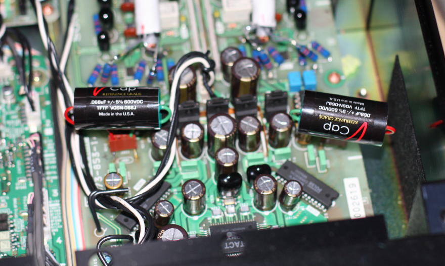

Peter Daniel said:Hi Kevin,
I achieved quite an improvement when I installed those caps in a Sony. Never compard Shigaclon with Sony directly, but SACDs sound pretty good 😉
OT:
Hi Peter,
Thanks for the tip, that is one set of components I haven't replaced in mine so far. I did bypass everything after the I/V converters by using UTC A-20 line to line transformers to convert balanced output to balanced or unbalanced output (as desired) bypassing everything else. Big improvement, however I am certain that changing out those .068uF caps would further up the ante, as something is still missing even after all of the upgrades and I generally prefer the ShigaClone with my dac to the Sony even playing SACDs.. I also plan to make a small outrider and use THS4131 differential monolithic amplifiers for the I/V instead of the LM4562 dual op-amps I now use.
The dac and ShigaClone sound very analog to my surprise and delight.

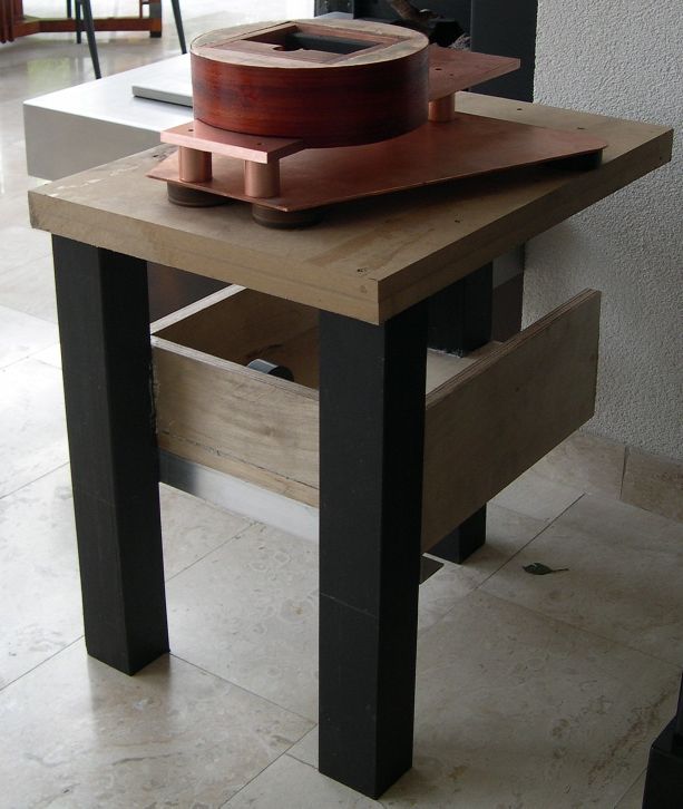

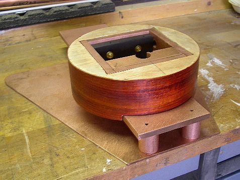

Another foto to give it some shape....I really enjoy it now...![]()

Could someone tell me what the dimensions of the board are? ie what size is the opening in your bronze chassis Peter or Erik?
I'm scavenging for parts for the chassis!
Fran
Fran
Height depends on what you measure from/to. 2" minimum with clearance for cable connections to be considered. See post #1961 where Eric had 54 mm.
