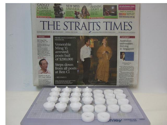

clearaudio said:
For all of you whose interested in the platter and screw on cap for the shigaclone mechanism, I am able to supply. The cost is USD$50 including postage to any where in the world. it will be made either in delrin or nylon. Pictures to follow soon. PM me, from Singapore.
Long overdue! Here are the Delrin platter and screw cap top I was talking about. Please email me if you want them.

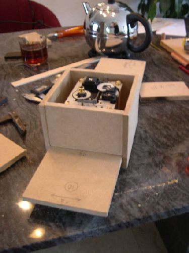

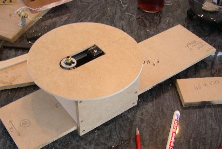

Hello everybody
My first post in this thread so I hope that you will excuse me for taking your experiences and silently, if imperfectly implementing them. But now I have hit a snag. I have built a reasonable attractive transport out of oak and ali. It spins up,I can control it, it will output through it's own dac ( pretty bad sounding ) but seems to have no output at spdif. Pin continuity is fine. I have not had a really easy ride with this board as everybody will have found how fragile they can seem and myopia and the tea time thirst can make things difficult. IS there a mute function that I have activated? If it is ouputting to it's own dac then there must be output that I can tap. Very odd and I have yet to hear the promise of this transport which is very frustrating.
Help!!!

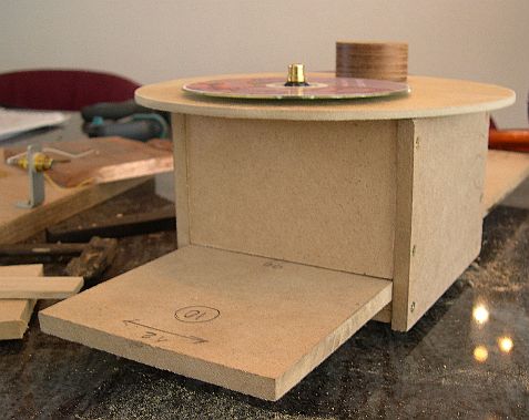

Interesting concept. Big question no one has asked yet is what is that rca jack doing in the middle of the spindle/platter.. Or am I hallucinating? 😀 😕 :bigeyes: :devilr:

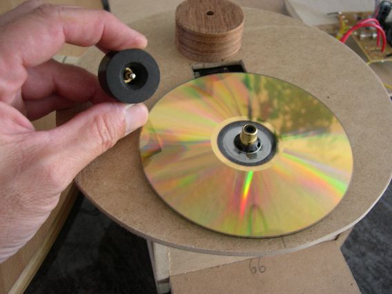

kevinkr said:
Hey Erik,
No you are not I was experimenting and it appeared thet the thread of an RCA is seeking his was with a light force into the plasic cup of the spindle leaving a much better option to create something...
So I developed an ebony puck
(knowing what it does for records
I used an RCA plugpin (but that is obvious)...
