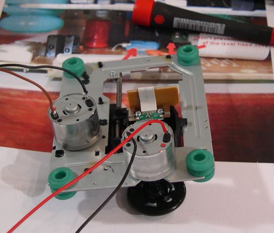

Peters Citizen arrived (thanks) so time to do some serious upgrading....

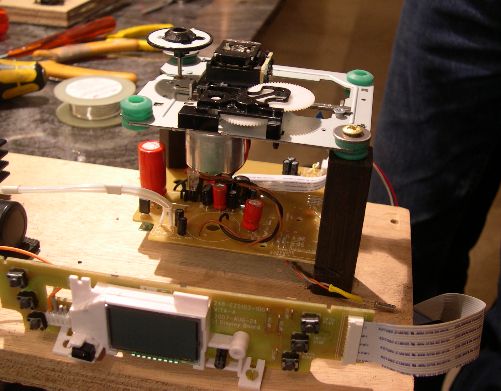

The clock was installed...the blackgates in place....a wondercap on the famous 10N position.
I also dismounted the (or rather my pro hifi-friend 😀 ) print from the motor....and invented a wooden stick for the
now-out-of-position relay switch who tells the laser its position.
I only listened for half an hour (seriously bedtime) but this is a giant leap forward...words as....quietness....no grain....complete different landscape...far more musical enters my mind..

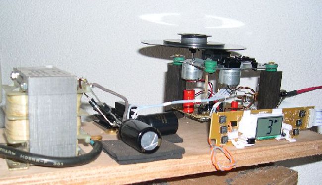

Up And Running.........................
Good for me I have my holidays right now for the coming 30 days...
The clock is in an easy position for trying out the trichord and the tent.....
The deviation of the Citizen is a bit less 113 against 189 from the ZTT....

Hi Erik , how do you mount the wooden stick? and how high is it and to what point to ensure the laser is functioning?
kanifee said:How much are these spare units?
We Canadians are fortunate. There still is a retail supply of these units available. Try Bestbuy.ca.
Dan 😀

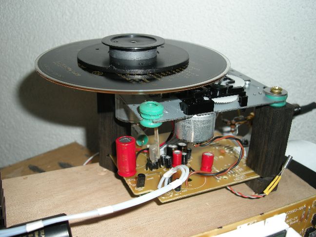

The lenght of the stick depends on how far you place the print underneath the laser...obviously it is maximized by the length of the ribbon...and you do not want a longer ribbon...
The stick is pretty much like a matchstick a little bit thinner...it is placed by a heatshrinktube (NOT HEATED) over the relais..and while checking the laserpath I added a little piece of sticky cloth to the lasercompartiment to make it hit the stick that is activating the relais....
Of course after you finalize things it is better to mount the relais to the board close to the laser....this is just experimenting...
