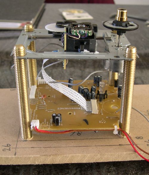

The lenght of the stick depends on how far you place the print underneath the laser...obviously it is maximized by the length of the ribbon...and you do not want a longer ribbon...
Erik,
nicely done work with the separation of the circuit board from the transport assembly and the use of the stick to lengthen the relay actuators. Your example will help others in the future after their lasers deteriorate and need replacement. After the laser chip starts to degrade (it already starts after about 200 hours playing time) one can either (1) replace just the laser pickup (maintaining the sled /motor mechanism), or (2) replace the whole laser transport unit with its motors. If you do the latter, the bad news is that the pcb will have to be separated from the motors. In either case, a calibration will have to be done to get the best eye pattern with use of the trim pot on the laser pickup pcb after replacement. Just thinking of the future.... In any case, the mechanical isolation of the pcb from the motors is a nice step forward that you have made...

My thing is doing well so far. It does play very nicely; I listened to some good jazz recordings and some CDs I feel were well made and this little gadget is awesome!
I met a snag yesterday though: I tried to detach the transport mechanism from the control pcb and unfortunately, the spinning motor of the cd would not work at all. I checked continuity, which was fine, then re-checked by replacing everything as it was: it worked again!
So I re-detached again, put 20-22 awg cables, made sure the soldering was appropriate, and again, the motor would not spin!!!
Suggestions regarding this mystery?
I put everything back together again and it works very well now.
So far, the whole set weights about 42 pounds (17 for the power supply, and 25 for the transport). I have not worked on the control board yet (it does scare me a bit) though I found some nice switches (touch type) at a surplus electronic store here, in Montreal.
Still have to work on the damping of the drive: the box has 2 floors, the lowest to hold the stone box, the second, inside the box, to hold the transport. Between, the damping based on insulation foam.

Dan_ed said:Pendergast,
Isn't there a relay that needs to be closed? I think that is the one Erik van Voorst made a long stick to close it with. You can try closing it with your finger and see if that gets the motor spinning.
Thanks Dantwomey!
Dan
Travel limit switch.. IIRC it is normally closed and opens when the sled reaches the inner limit of travel. Something else might be going on here.
Pendergast said:
Pendergast, from looking at your photos (nice work!) it seems to me that you are losing much of the advantage of the inertia of all that mass by continuing to use the green compliant couplings. If you mounted the transport rigidly, wouldn't the vibrations of the rotating disc and mechanism be reduced through being directly coupled to a lot of weight? You could then put some sort of compliant suspension under the whole heavy box. I may be wrong - but I think it could be well worth trying.
