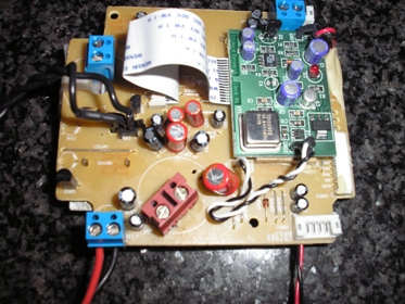

JVC RC-ST3 has arrived. There is inside our famous stuff, our wanted mechanisms in all its glory 🙂 (see #18). What is really good news, and also I like of the board, because of all the parts are whole mounted, no smd-s at all 🙂. There is no onboard digital out, but easyly can soldered a new output.
And what about the JVC RC-ST3? It is using LA9242M and LA6541 chips. But there is a LC78622 DSP chip (with Digital out) instead of LC78601?

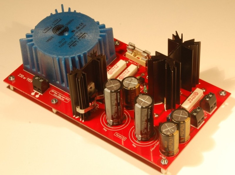

Hi Tibi,
Are you going to do a group buy in the future in connection with a 5 volt super regulator special for V1 V2 V4 V4 ?
Maybe the simplistic Salas low voltage shunt regulator is a good choise with transformer on the board?
See photo as an example ...
Rudy
SSLV is layout sensitive and any layout other than the BiB has to be very carefully evaluated and measured.

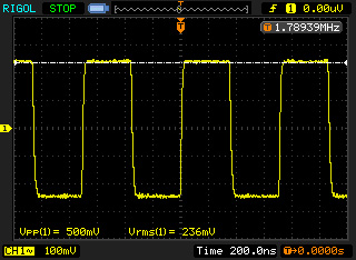

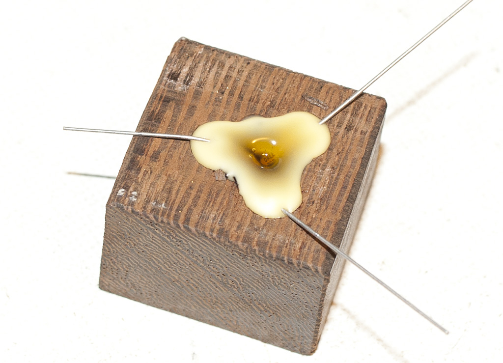

A bit better today.
I made the 14.2dB attenuator using resistance wire and sealed it into wax/wenge. I also used a new technique which should have lower inductance and far less vibration and temperature noise.
The measurement of the output signal is now spot on, showing an accurate 500mV peak to peak perfect square with nice and fast rise time and no ringing.

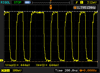

Below is the previous measurement with the 12dB attenuator and probably higher inductance resistors.
It's late now to make any audio tests... I ll leave it working for a few hours and audio test it tomorrow.
Anyway, my thoughts are verified... To get the 0.5V output we need a 14.2dB attenuator. Now to see how it sounds...

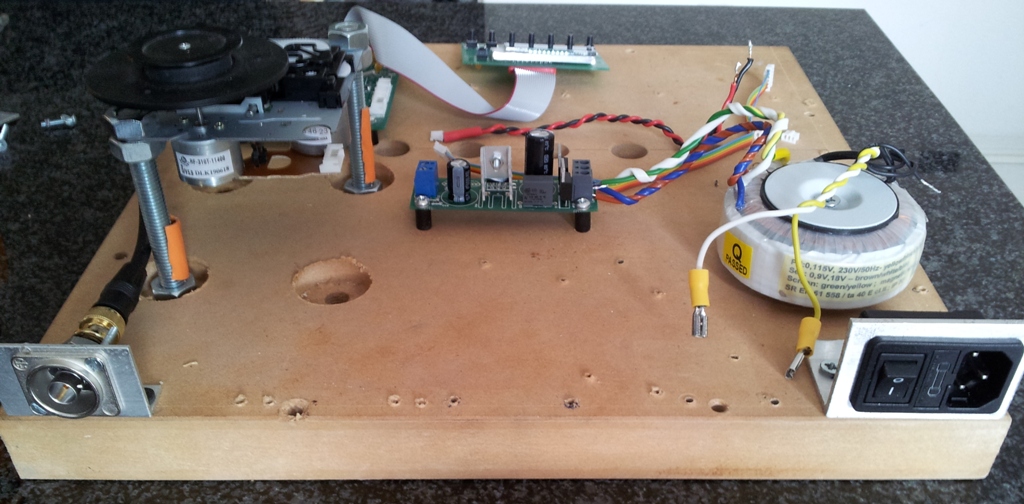

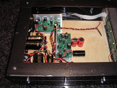

Old pictures, Shiga on the Workbench 😉
Rudy

Salas psu is quite versatile and can be quite different with different parts. I used 47uF electrolytic on the Zobel with 0R47 because the pana FR is low ESR, 47uF on the sense lines right on the BiB board and 1000uF electrolytic on the entrance of the psu on the shiga board (V4)
