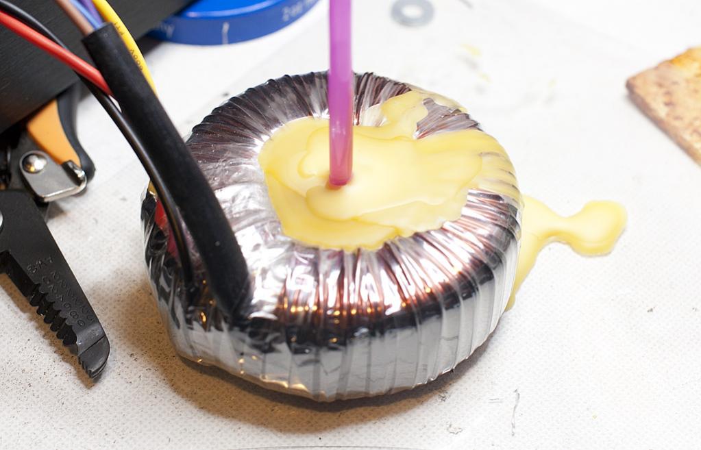

Incidentally, I am waiting for a new custom-made transformer that I specifically requested not to be stabilised with resin, so I can insert a piece of wood in the center, and fill the remaining space with beeswax. Talk about convergence of minds 😉
Enclosing a trafo completely in wood/wax might turn out not to be such a great idea as it could potentially lead to trafo overheating problems - both wood and wax are excellent thermal insulators. But with a good (low-loss) trafo it might just work.

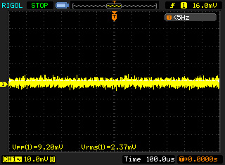

I have added a 47uF cap at the output of salas to reduce the ripple and I have moved the salas ground connection from the 7808 ground to a close point on the pcb. The cap is directly connected there.
attachment.php
Noise has dropped to about 10mV from 40mV. Nice one, but I believe it can go even lower... plus I m getting some ringing so I need to check this a bit more...
Next step is to check it with a 100uF cap.
Sonically its quite nice atm, but I am trying an electrolytic at C8 which is still breaking in, so I will avoid making any direct comments on the sound part...

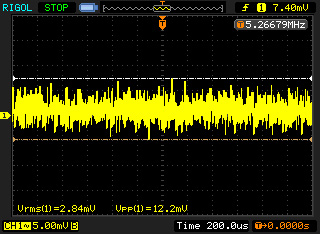

Further to my tests with the salas psu, I have added a 47uF cap at the sense lines which eliminated the 5Mhz 200mV ringing and brought it up as straight 200mV random interference. To fight that I replaced the cap at the shiga entrance with a 1000uF and problem solved.
attachment.php
I don t think I can get it any lower than that...
Again, it s late so I cannot comment with certainty on the sonic change, but some low level listening shows significant clarity increase, especially in the mid frequencies separation. For example the reverb on pink floyd guitars is much much more easy to follow. There is the primary tone, and you can clearly hear at least two distinct delayed repeats, while before there was just a vague sense of depth...

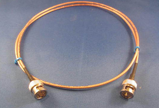

OK guys... if you are still using an rca socket on the shiga side REMOVE IT and solder a proper 75R interconnect directly to the attenuator.
I have replaced my crappy interconnect with some properly terminated Belden 83264 (removed the BNC from one side) and while it still is freshly soldered and pretty much non broken-in, the increase in stage width and depth is amazing...
It still has some rough points like a bit fluffy bass, but I will give it a few days before judging it.
If you're going to go this route, make sure the cable from the PCB digital out to the back panel is also 75 Ohm. One assumes you switched the output connector on the Shiga to a BNC. It's too late from the sound of it, but if you replaced one end with RCA to get to your DAC, you'd have been better off keeping the BNC and using a good BNC-RCA barrel (like a Bomar or similar).
