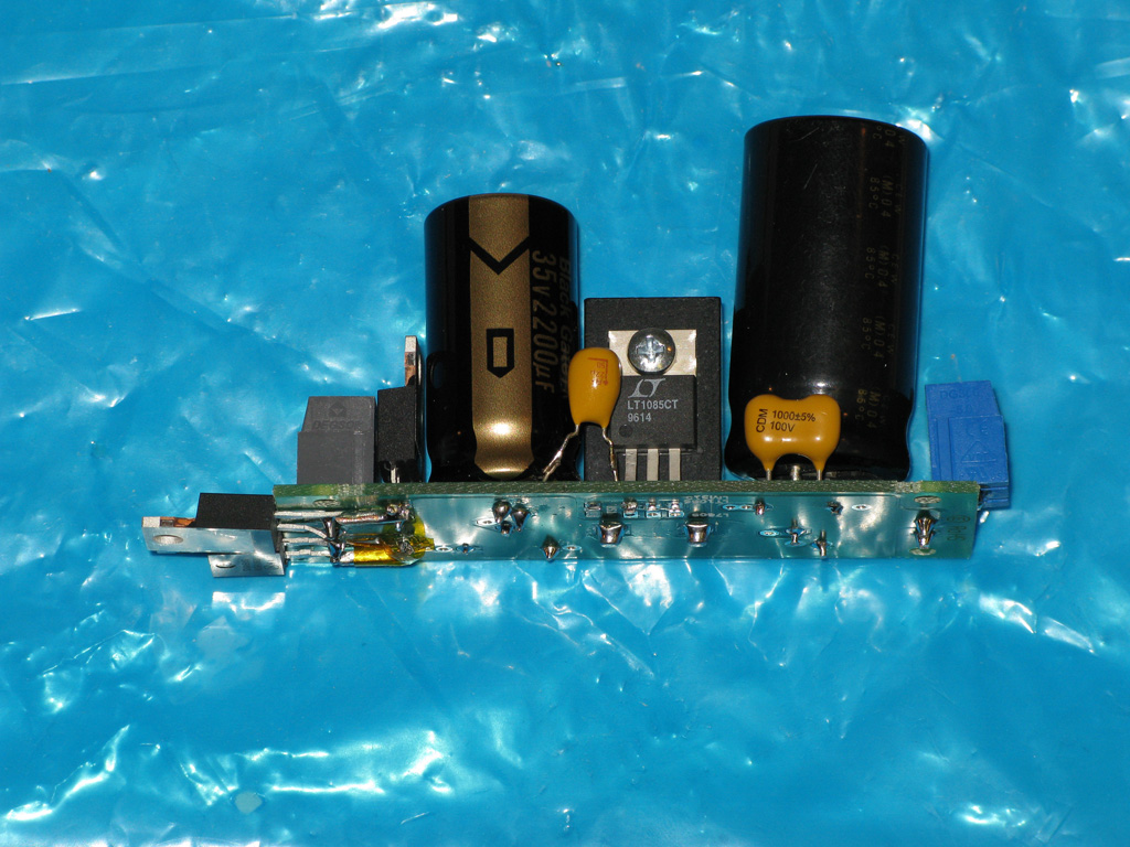

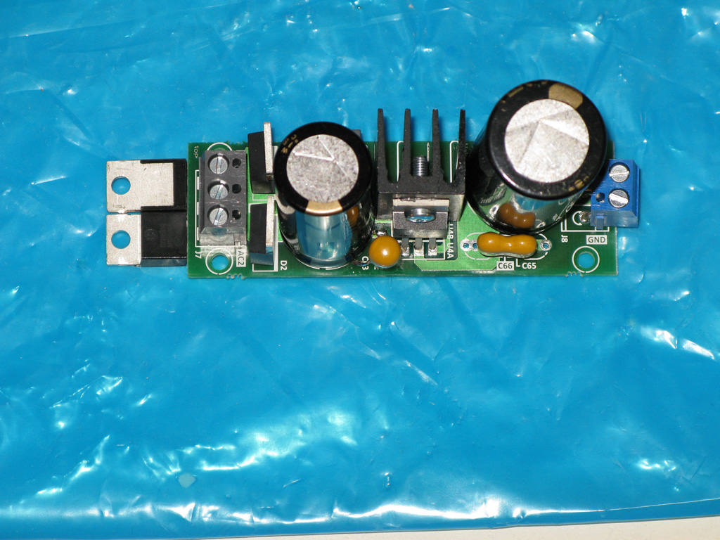

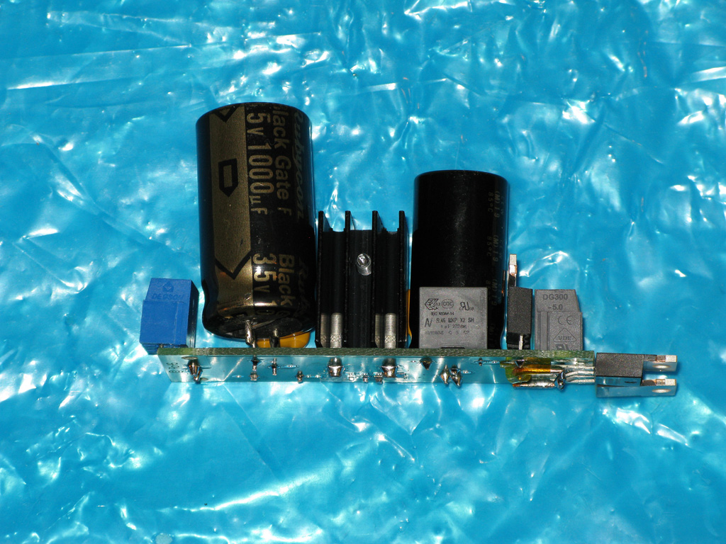

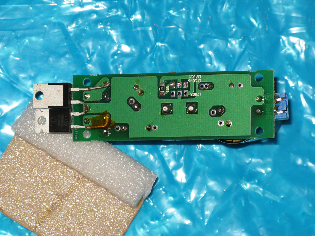

My two 10V supplies are built for the P-A super-regs. I decided to post pics of one of them since it required a bit of special work. I started with Tibi's PS PCB but knew that I wanted to use my custom R-core transformer, which is not center tapped. So I had to turn Tibi's board into something that would support a full wave bridge rectifier. Pics below.
I made one very stupid mistake, however. I accidentally reversed the ripple reject cap which is across the adjust pin. I didn't realize this until I powered it up. Once I saw the Vout was not stable I pulled the power and looked things over. That's when I saw the mistake. I had to cut the old cap out and replace it (that's why the adjust cap is soldered on to the old leads). I hope that didn't damage the circuit.
Oh, you can see I added a bit of Kapton tape to one of the leads on the additional diodes. It was a little to close to the solder pad of the topside diode. Probably would have been fine but I wanted to be safe.
And yes, those are two of my very few remaing BGs doing the filtering work. 😀 You might notice that I had to fashion some leads to push out the output terminal block because of the diameter of the 1000uF job. I used the snipped off leads from the BG to do that.

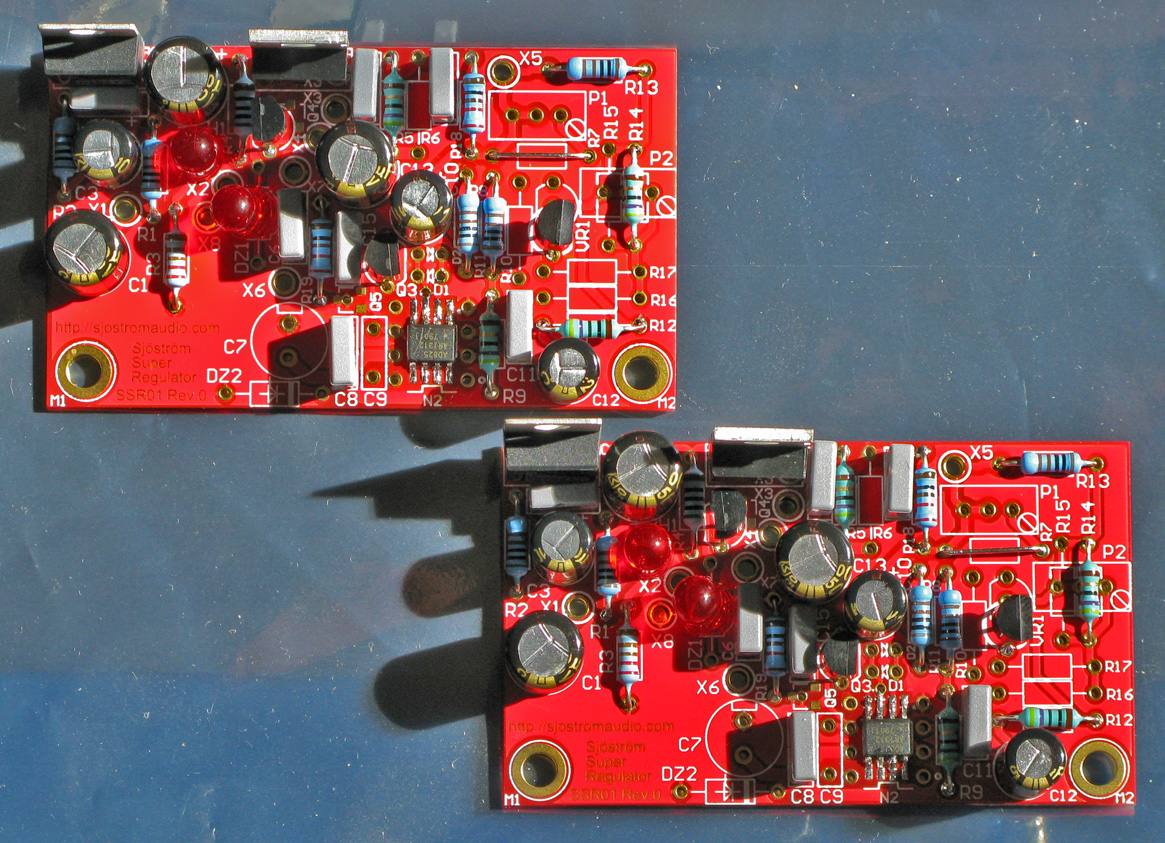

Behold, my two Per Anders SSR01 5V super regulators! They will drive the clock and the digital processing on the main PCB. I have to thank P-A for designing such a nice circuit board, and for being available to answer questions. Beautiful to work on; it was a joy to put together. Hopefully testing will begin tonight.
