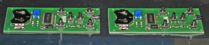

Remotes not working
Hi Tibi. Thanks to those chips I got today I was able to finish the remotes, but neither one seems to be working. I'm attaching pics so if there's anything obvious you might be able to point it out. I'm also attaching a pic showing the soldering job on one of the two chips. I thought it came out okay and it looked good under the magnifier. The other ones looks the same.
In the case of both remotes, pressing any of the buttons does nothing. I checked some of the continuity points, including the 3V to the LED anode. What are some of the critical things I should check?
You need to rotate Q1 as per this picture.
http://vicol-audio.ro/img/shiga/remote.jpg
