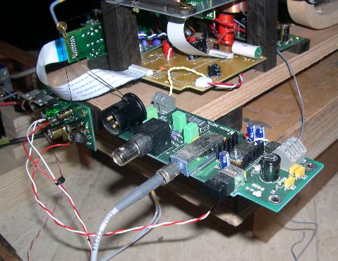

BTW Tibi, for coaxial out please tell us you're looking at a BNC output. Regardless of what some may wish to consider (or believe) there is no such thing as an RCA connector which exhbits a true 75 Ohm characteristic impedance. Not physically possible. I'd suggest getting the design correct at the interface; users can get a BNC-RCA adapter if needed.
BMW850, that looks very sweet. Is there a link which points to Erik discussing what he did here?
I see he also decided to go with BNC. Nice!
Look here: http://www.diyaudio.com/forums/digi...ordable-cd-transport-shigaclone-story-52.html

The outputboard is from Wadia 22/23.
On this board the AM26LS31CN chip is fitted followed by a CTS ODL 50 series 2 for ST-optical.
The AM26LS31 is pin compatible with DS26LS31.
Anton.

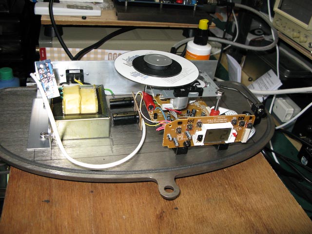

CD Transport (Shigaclone) Version 1, 2011 twiddlingmyknobs
I am using cast iron for the base, it has very good vibration damping properties...
SPDIF output for me since I need to keep it simple... more options sounds good though!
I like your solid design and (equally solid) parts choices, billo44. Where did you get that cast iron base?
