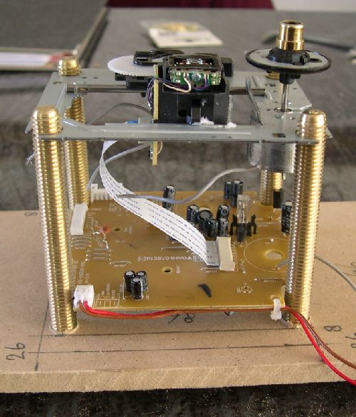

Read this, also an picture of Erik site.

The benefits for having a separate board are obvious.
- less mechanical vibrations, less noise induced by ceramic components
- more space to accommodate 1206 components
- better layout and grounding as the motors are no longer on pcb
- flexibility in terms of board placement - dampening, shielding etc
Jazz and me will change the design for a separate board.
The board will be mounted under cd mechanic, something like in picture posted by Rudy http://www.diyaudio.com/forums/atta...ble-cd-transport-shigaclone-story-oil-rig.jpg
