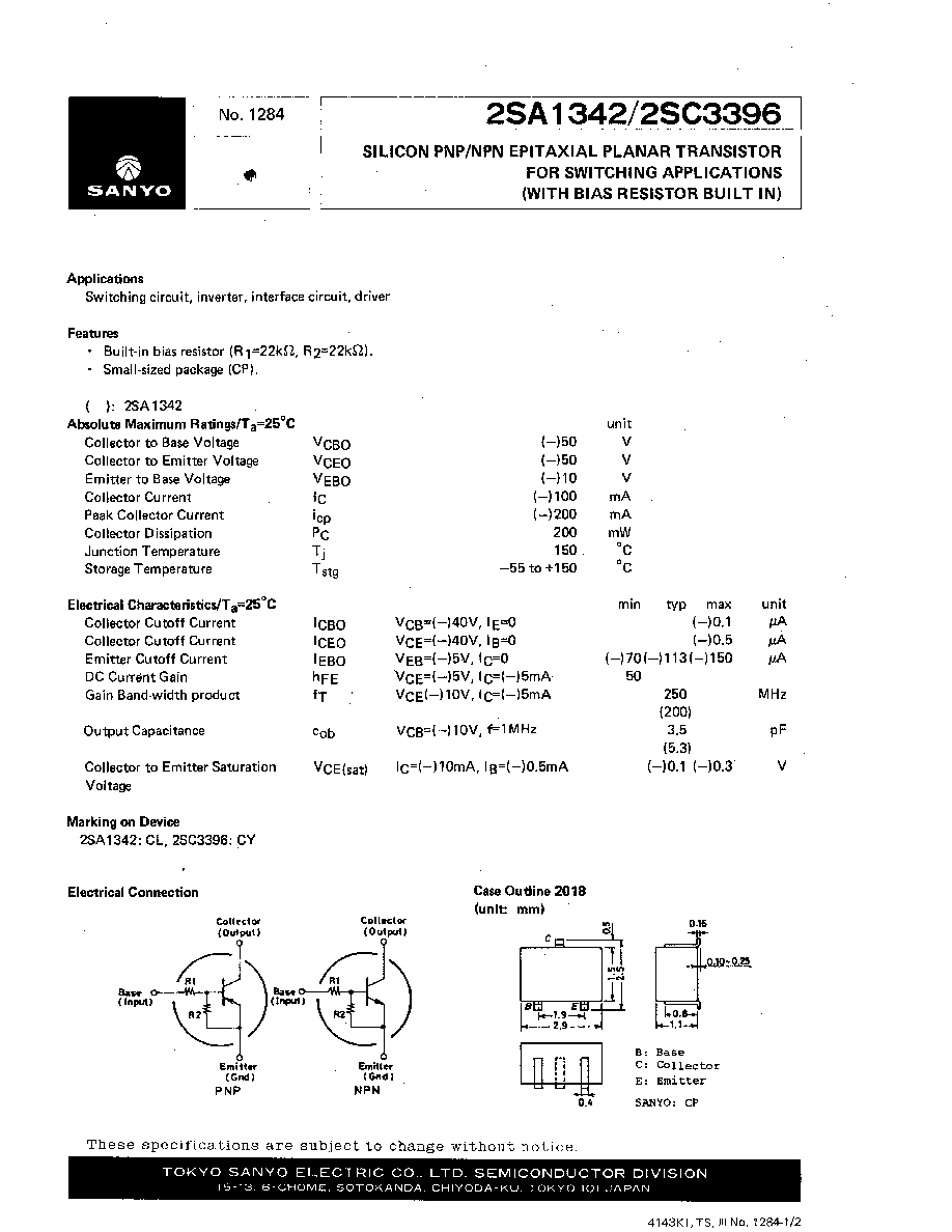

Q3 is missing two resistors for biasing it. As shown, it will not function.
TheGimp,
Q3 is 2SA1342 who have bias built-in resistors. See datasheet.

Tvicol, thanks.
I was comparing to the original circuit and did not look up the transistors, only the ICs.

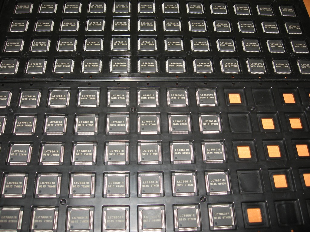

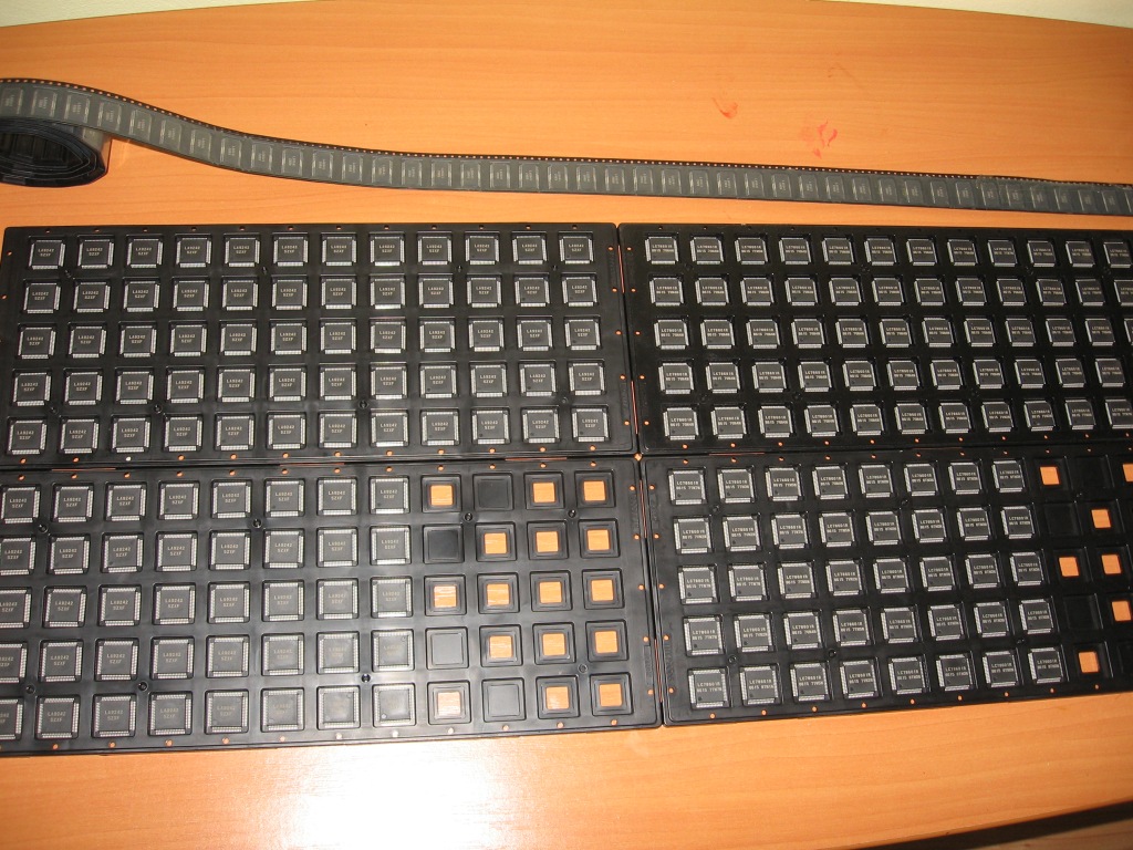

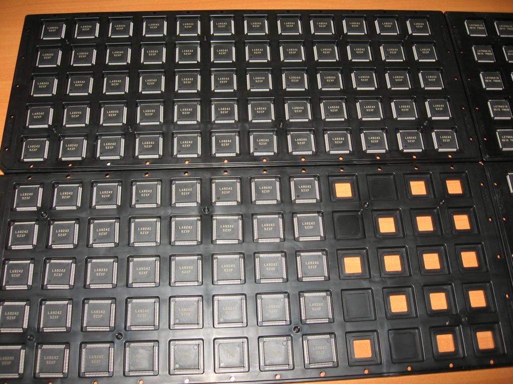

IC's arrived. 🙂

Yes this is important - it makes no sense that someone would order the board and not the ICs - they are impossible to get other than through this group buy.
I did put my name down for them, but many didn't....
Fran

Hi Rudy,
I''ll try to provide all hard to find components, but soldering is part of the DIY fun. 🙂
